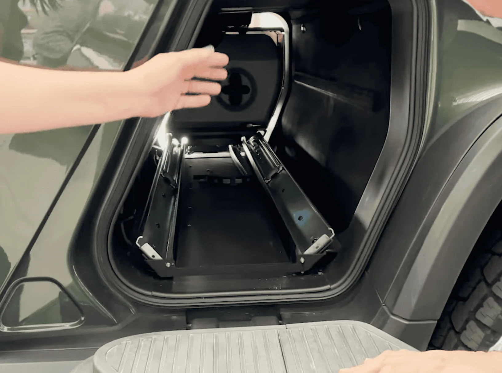

I've seen photos of that stuff. Someone had taken a photo of the underneath of the slides while the kitchen was out that had the "Accuride" stamp on them, which lead me to them for the slides. I still haven't seen anything about how it's bolted in, but it seems like it might bolt into those holes with a different piece of plastic to fill the center and hide the bolts.
From this photo, it looks like the slides attach to a metal frame which is bolted to the floor. The might have done this to maximize vertical height—it also might be stronger having the slides at opposite angles like that.
It's stronger than having them flat on the bottom, probably slightly sturdier than flat or upright, but can't hold as much weight as upright. I'm planning on a slightly steeper angle than this, but not completely upright.

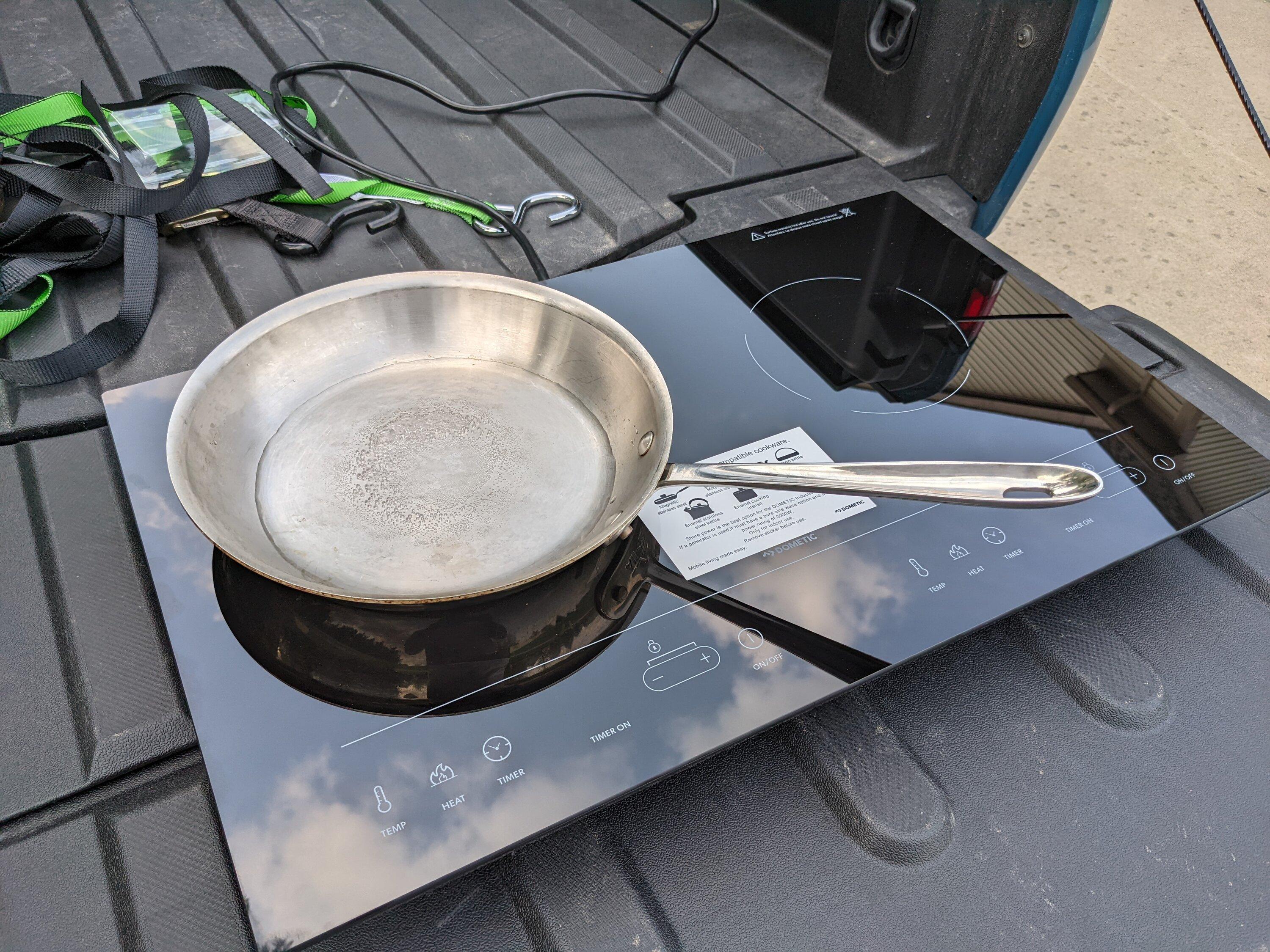

Boiling water is promising.

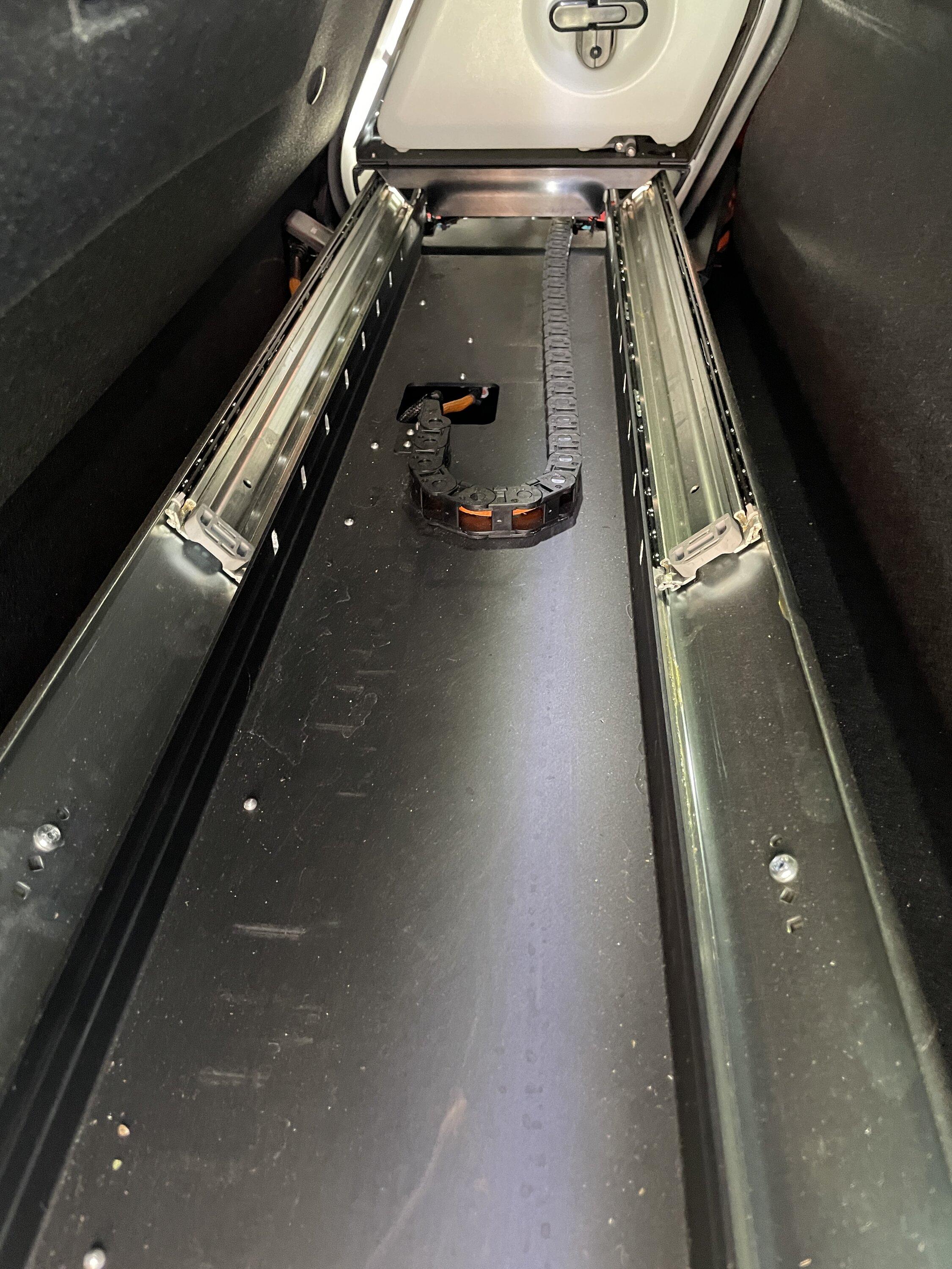

I'm not completely sure how Rivian has the gear tunnel shuttle mounted, but there are two unused threaded bolt holes on each end of the tunnel and no other threaded holes that I could find.
This seems like a perfect application for nutserts, which if you aren’t familiar, are special nuts that be blind installed into sheet metal. Build a frame that bolts to the nutserts you install in the floor and then bolt your slides to the frame.
