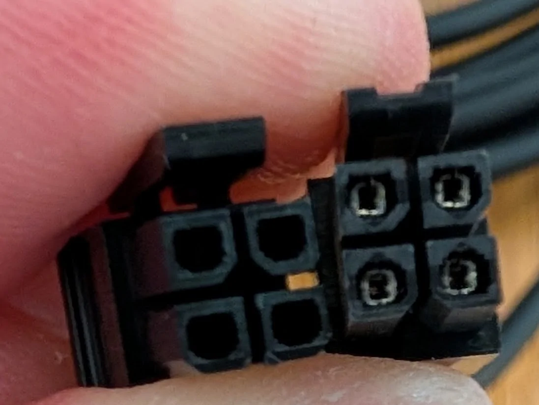

unfortunately, that's not the right connector either. at least not for the included comma adapter/power. the right male molex connector is from the included comma power/odb connector. the left side is the one from amazon. the pins on the amazon adapter are facing the wrong way. see how the center of the connector forms a triangle? the comma power/adapter do not.
Rivian R1T R1S Comma 4 Four released 1766181795414-kq
i found the exact molex here - https://www.mouser.com/ProductDetail/Molex/206461-0400?qs=EBDBlbfErPwP3QQD8I3cIw==
Rivian R1T R1S Comma 4 Four released 1766181987128-b2
but i dont want to wait 3-4 weeks for delivery
The one I posted works just fine. I've used it many times.
The female end is more impactful. Compare the Amazon one to the female socket.

The female end on the comma harness isn't the same, but it still fits - its just a bit tighter.

It's a tight/unexpected fit in the Lukas harness too, but definitely works. Until this, I had no idea there could be two different "nearly the same" Molex-style connectors. WTF.

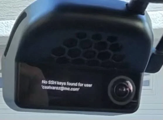

I am surprised that the stopping distance and how it stops behind another car is still insanely bad, to be kind of unusable. And that it's still impossible to feather the accelerator to fix it, because it's basically a light switch. For city usage, Tesla AP is still mostly better, sadly. There are a ton of other ways the Comma is better, but this problem makes it really hard to use on busy city streets. I'm running Nevada now and tried a few others in the past. Even with "aggressive" it leaves a ridiculous space in front of me when it stops.
I unlinked my C4 from Sunnylink and now I can't see a way to re-link it. Scanning the QR only takes me to my account and says I need to link a device, but no option to do so. Ideas?
The stopping distance hasn't been so bad for me, but the stopping behavior is a bit weird. It generally will stop with about 10m of distance between me and the lead car which I'm comfortable with. Anywhere between 8-10m is fine with me so it's on the far end of that but it's ok.
The behavior that it does it is weird though - it will start slowing down way early, stop with about 18m between, and then slowly creep up and close the distance until it gets to 10.
I think this is a driving model issue and I may go back to Down to Ride v6 (currently using Cool GWM) since it seemed to work better.
For sunnylink, when you scan the QR it should take you to a page that lists your device as an option to pair.
Unfortunately, no. It's like it remembers I once had it linked, and the unlink caused it to disappear, but not behave like an unlinked device.
I guess I should test drive other models. Nevada isn't giving me that odd behavior, which I used to have long ago. It just stops SO far back. It would be nice to be able to switch models from Sunnylink....
If you can, share a video of what you see when you scan the Sunnylink QR code.

https://share.icloud.com/photos/00cto_SG7vAYW2JOLiOxkV8Eg
It just goes to my account, not an option to link. See below, I think I should try the SSH method. But that means entering my 15 character Github password on that screen, LOL.
Grok says:
It looks like you're running into a common issue with SunnyLink after unpairing a Comma device (likely a Comma 3 or 4 series). Based on SunnyPilot's community resources, unpairing the device from SunnyLink removes its association and generates a new device ID on their servers. This prevents simple re-pairing with the same QR code, as the system treats it like a new setup is required.
thanks! I jammed the one I already bought in and it does fit, albeit very tightly. comma 4 installed and working now! also, not sure if it's a bad sign, but the USB-C when I touched it would trigger a hood open error. once I plugged it into the comma, that mostly stopped. couldn't shift out of P either, kept saying to press brake even though I was. did have to do a hard reset though and that seemed to have solve it
Yeah, the brake thing is a common issue on first install - the hard reset usually clears that out. The hood open error is a new one, though - haven't seen that before.

I found a bug report on the Sunnylink site confirming this issue and the process to fix it. Grok was right.
I had the brake sensor issue also.
