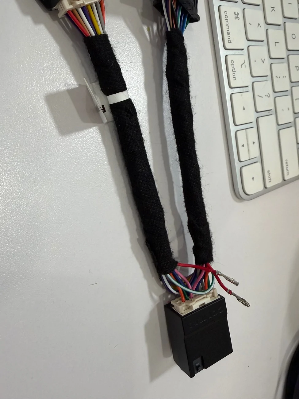

I had an extra harness. Removed the power wires, and I’ll try swapping it with the other one tomorrow.
Make sure you connect those red wires with a Wago or similar connector.
