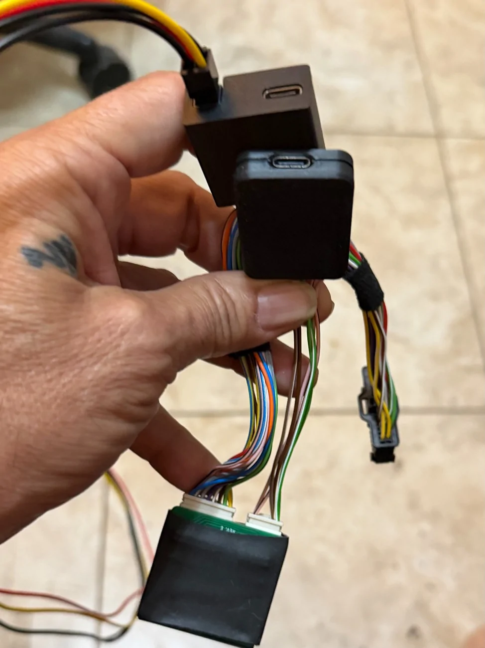

So I got my comma 4 today and the xnor adapter from Lukas, but I dont see a place to plug the 2nd usb c connector into. Am I missing something or did they remove it?
Need more info. Do you have a harness from Comma? If so, did you order the adapter from lukas specifically FOR the Comma harness? There are two versions - one for the Comma harness, and one for the harness that Lukas sells.

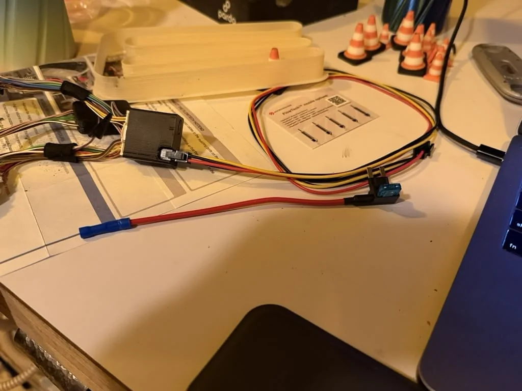

My C4 is out for delivery now. So I hope to find time to put all the harnesses back into the car, remove the old mount without destroying the windshield film, and figure out which pin the power goes to. Gerry is it as simple as just the red wire on the molex? For some reason none of my searching is finding a good photo of that.
This is probably the key issue. This is with both Lukas harnesses:
Yup, all you need is the red wire. You can pull out the others.
YouTube

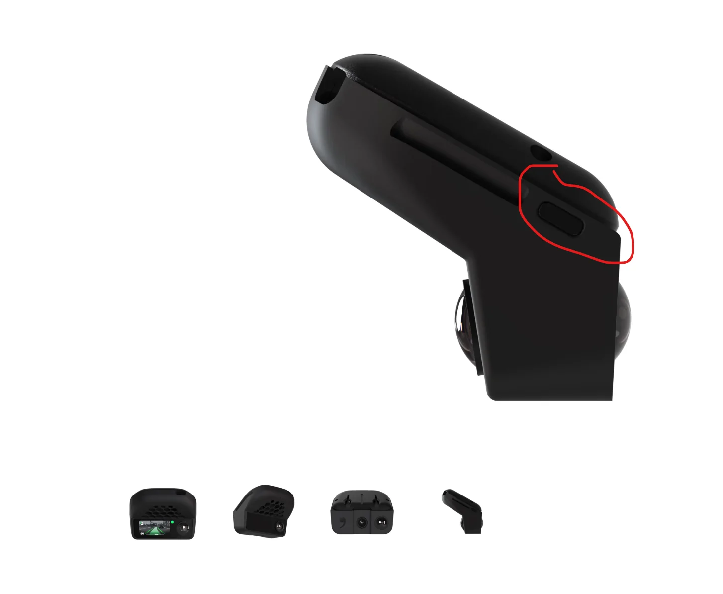

You have to remove the plug for the Aux USB on the side...

I got it figured out. There’s a little rubber cover over the secondary USB port on the new 4

The C4 is installed and working!
Rivian R1T R1S Comma 4 Four released 1766082596816-r8
@gerrylum I have a couple suggestions for the Google doc, you maintain that right? Or someone else?
I haven't seen a video on exactly how to deal with the AXM connector before, so I made one. My smart glasses aren't good in low light, but there's no way you can hold a camera and do this at the same time.
I am! There are a couple videos in the document that include sections that go over the AXM connector, but it doesn't hurt to have other people perspectives as well.
