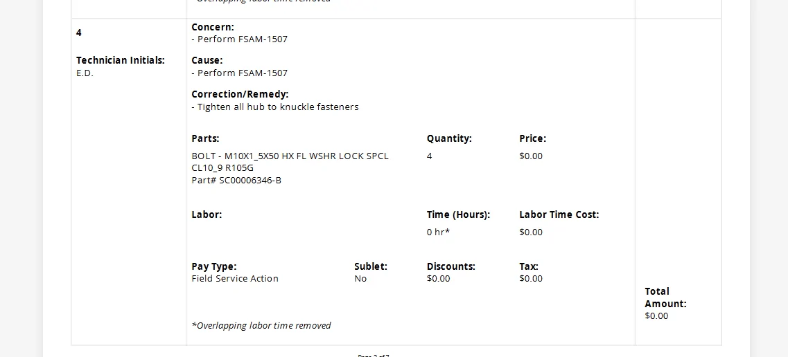

Just got mine back from the service center for the PTC install and tire rotation. Maybe it's the 45F outside, but it's the quietest I have heard yet. Hopefully they didn't shoot grease in the splines to cover it up for a while. Again, the 45F might be the "fix", but I'm kind of certain this reduced some noise. It looks like a new part was added to the hubs all the way around.

perhaps the temps are helping, but this sounds promising! What exactly is the "PTC"?
Powered Tonneau Cover.
This should reduce the tolerance on the half-shaft play. I guess we'll see.
I had the radio and HVAC off and drove 55 miles. About 2 miles of low speed driving and through a rutted out parking lot where I normally hear it pretty loudly. Silence.
I still have the original dampers which I believe were noise makers, so we'll see about that when I get back in it this evening.
It's promising.
