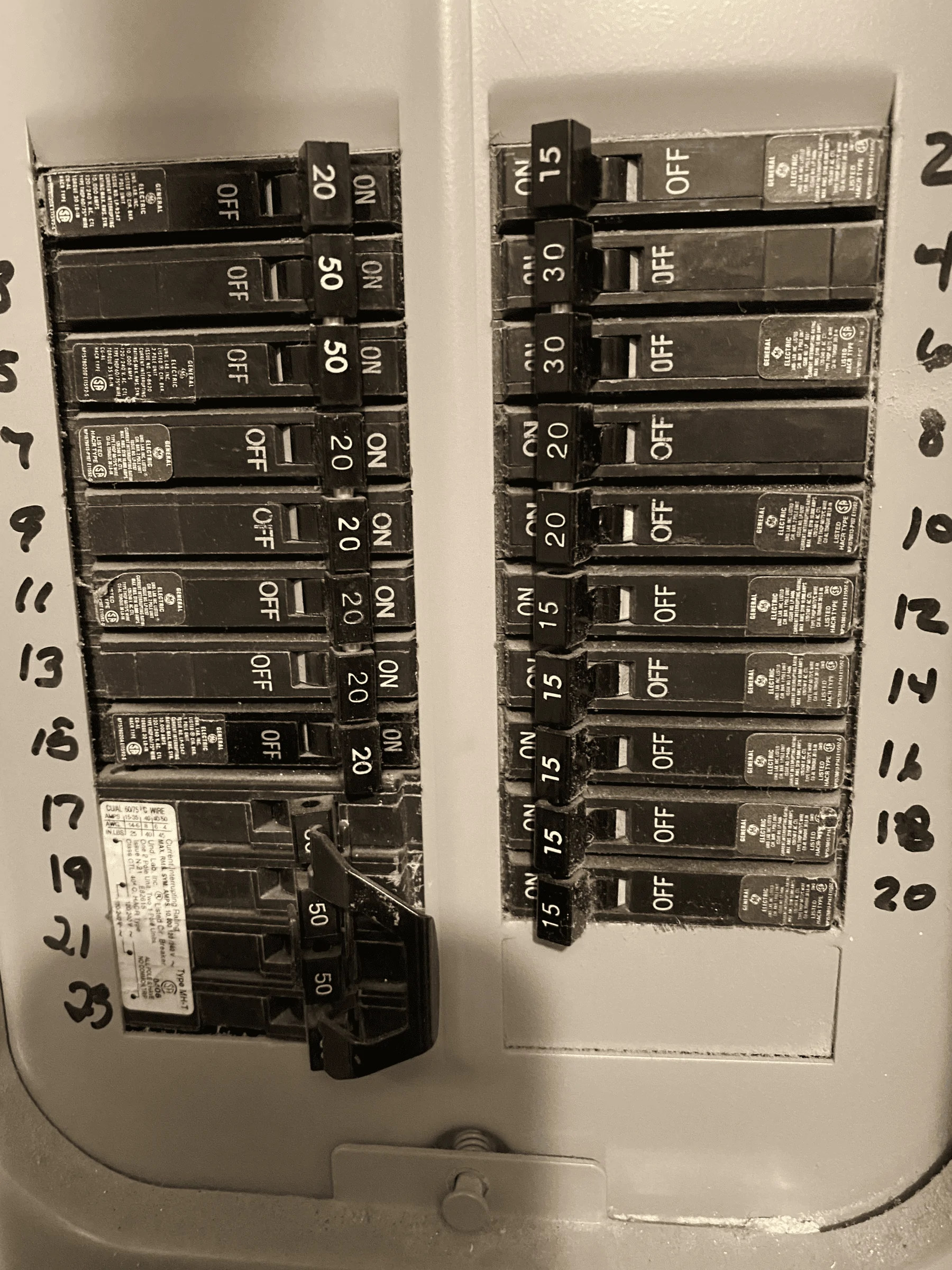

I"m so confused! Hard wired charger install or not?
I ordered the Rivian wall and remote chargers. As a first-time electric owner, I'm going to be as prepared as possible!
I live in the Southern California desert, in a condo association, in a townhome; which I own. I have a private garage attached to my unit.
My power panel is upstairs in the main bedroom closet. and my washer and dryer are located in a room connected to the garage.
I think I have 2 open slots in my electric panel. See photo.
Am I a good candidate for the wall charger install?
I think others have addressed most of your question, but just to reiterate, you will have to get approval from your HOA to get that wall charger installed. If they approve it, my guess after seeing your panel is that you might need to upgrade that if you do want it installed, which is easily a $3k-$8k project. If that is the case and I were in your shoes I would not do it.
I live in an apartment. I have a garage, but obviously I can’t have a wall charger installed in a building I don’t own. My plan is to simply plug it into the wall using the basic charging cable each night When I get home from work. Rivian’s website says plugging into a regular outlet will get you a “few” miles per hour, which if you figure you leave it plugged in for 10-12 hours a day at home would add up to 24-36 miles per session depending on what your definition of “few” is. That should be more than enough to replace what I used each day for my commute. If I need to top off for a longer drive I plan to hit the Electrify America DCFC about 10 minutes from my house.
Bottom line, there are lots of great ideas on the best and most effective ways to charge. This is my first BEV also and I plan to use it like Any other vehicle. If it’s not possible or not cost effective to install your wall charger, you should be fine to plug it into the regular wall outlet in your garage. Or if you don’t want to leave it plugged in all the time, just hit up the local DCFC when you need more juice. Don’t overthink it. Just enjoy your wonderful new R1S!

Also, for home charging I know that a 60amp circuit will charge faster but are there any reasons to go with a 50amp instead?
If you don’t want to install a hardwired charger. Plug-in chargers can only be on a 50V branch ckt as far as i know.
Up to 32 amps on a 40amp circuit (240 volt split phase).
