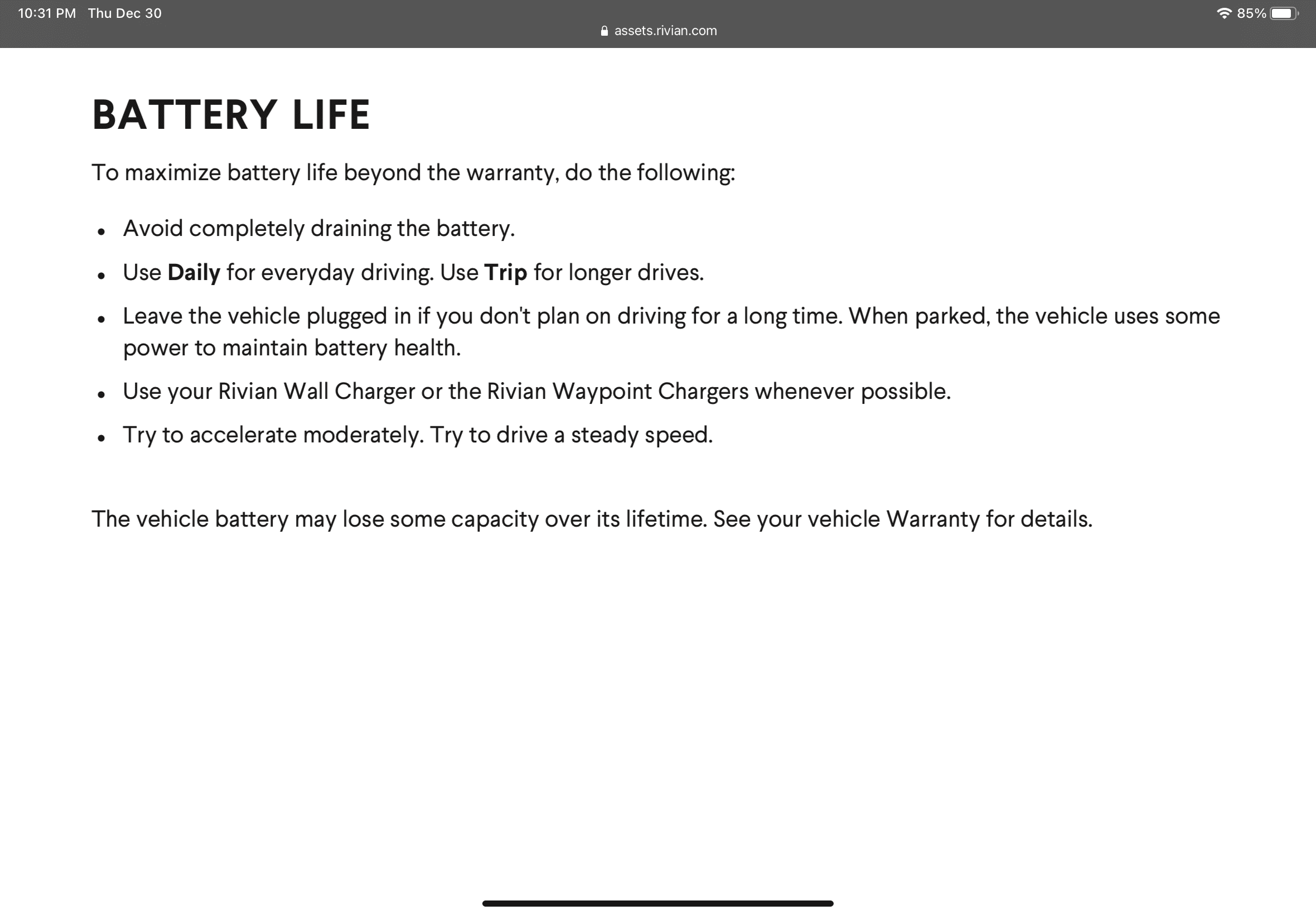

https://rivian.com/support/article/r1t-owners-guide

It's fine. The BMS manages it. You just wouldn't want to keep it charged to 100%. Rovian specifically says to keep it plugged in if it's going to be sitting for a long time (which I would interpret to mean weeks).
All EV makers say this in bold. Its to ensure that 12V battery within the vehicle doesn't die if not driven for a long time (weeks and months).

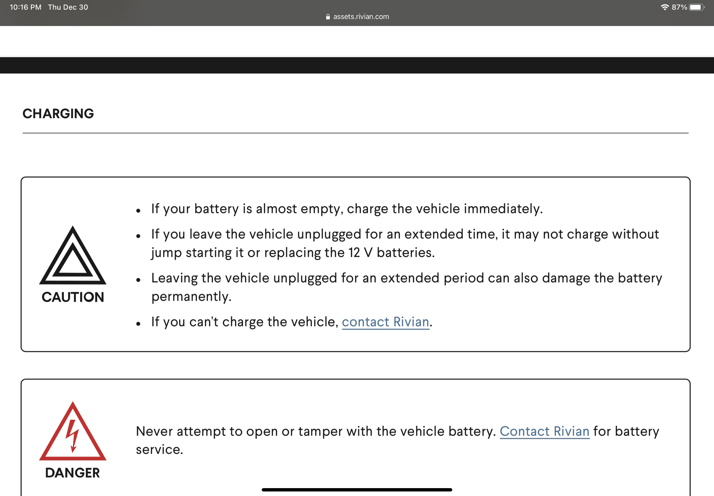

Exactly right. Not exactly in bold, but there is a really large caution sign.
I am curious. How do you jump start a EV?
