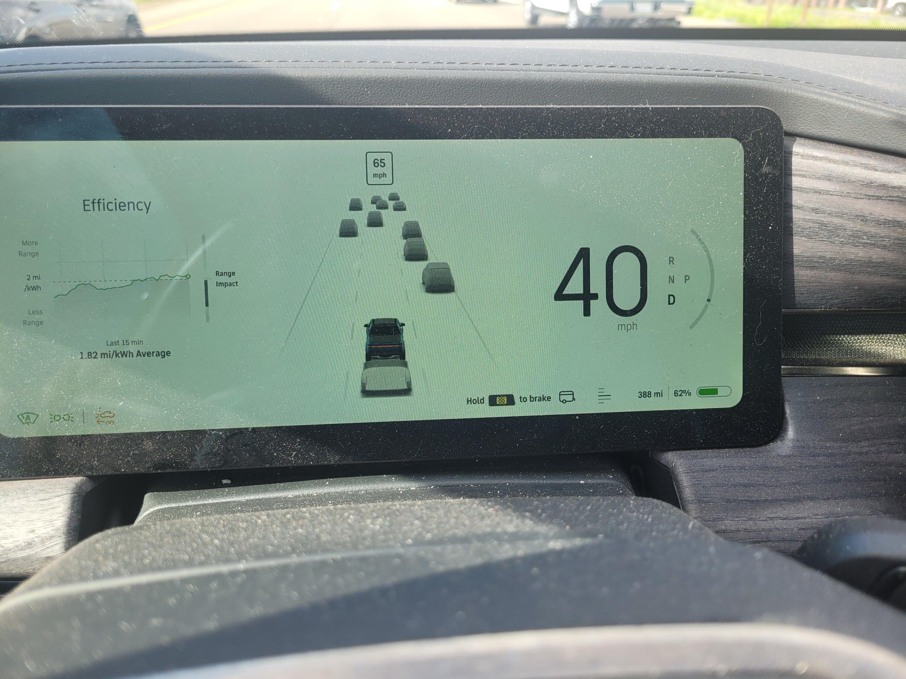

This is pretty ridiculous.. At the very least tow mode shouldn't read TWICE the range of conserve mode..
This happened to me today and actually almost really screwed me because I didn't realize that it was 4x off my range and didn't pay attention to my battery percentage and do napkin math, that the R1t obviously has a problem doing..
I drove 5 miles at 0%, with my car trailer and got speed limited down to about 40mph. Luckily there was construction and I could go that slow.
It's estimating over 500miles of range in tow mode..

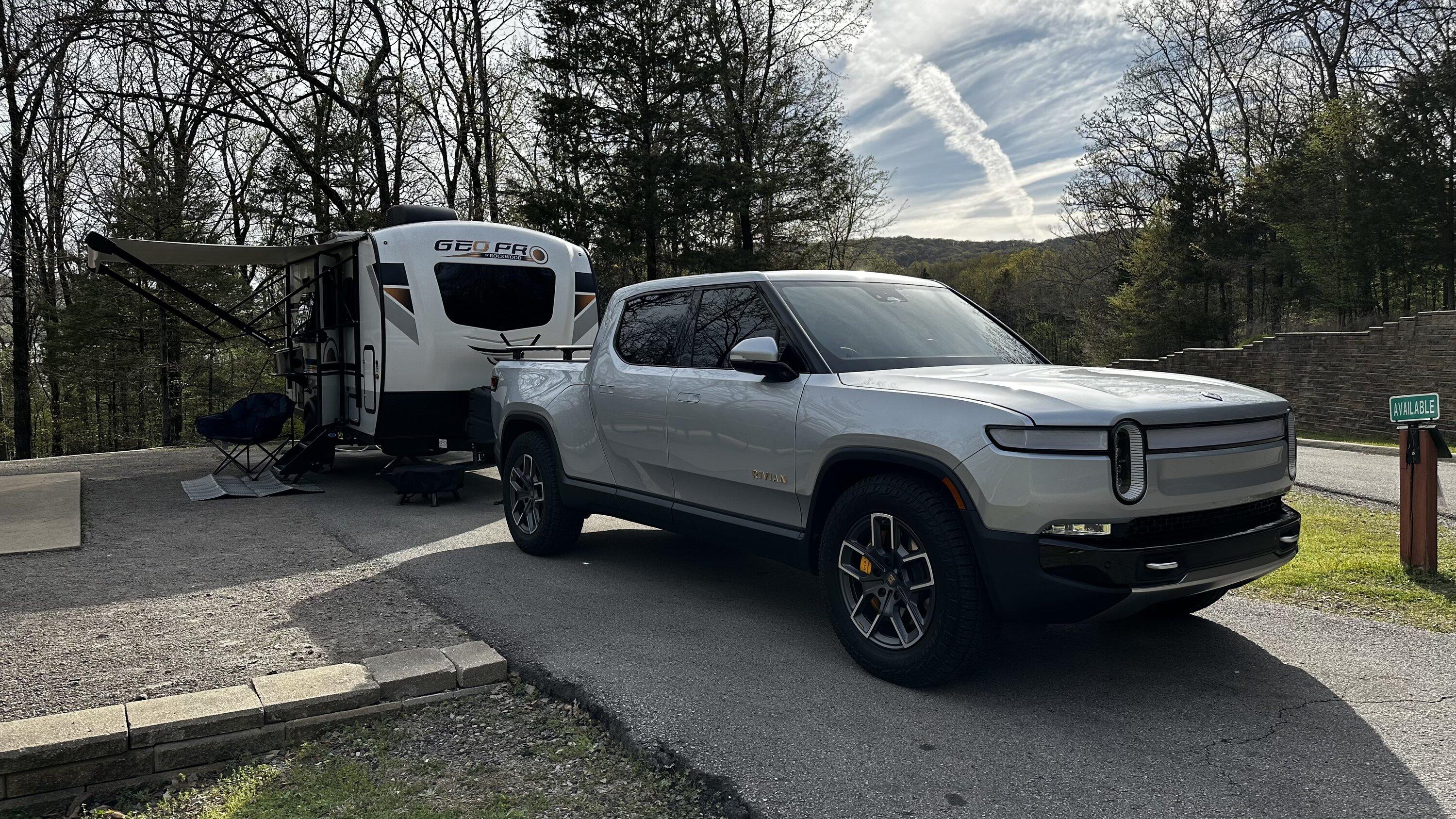

I did my first tow test today and I saw the exact same issues you are reporting. Initial range cut in half then slowly worked it's way back to what it would be not towing and never adjusted based on the actual current efficiency.
