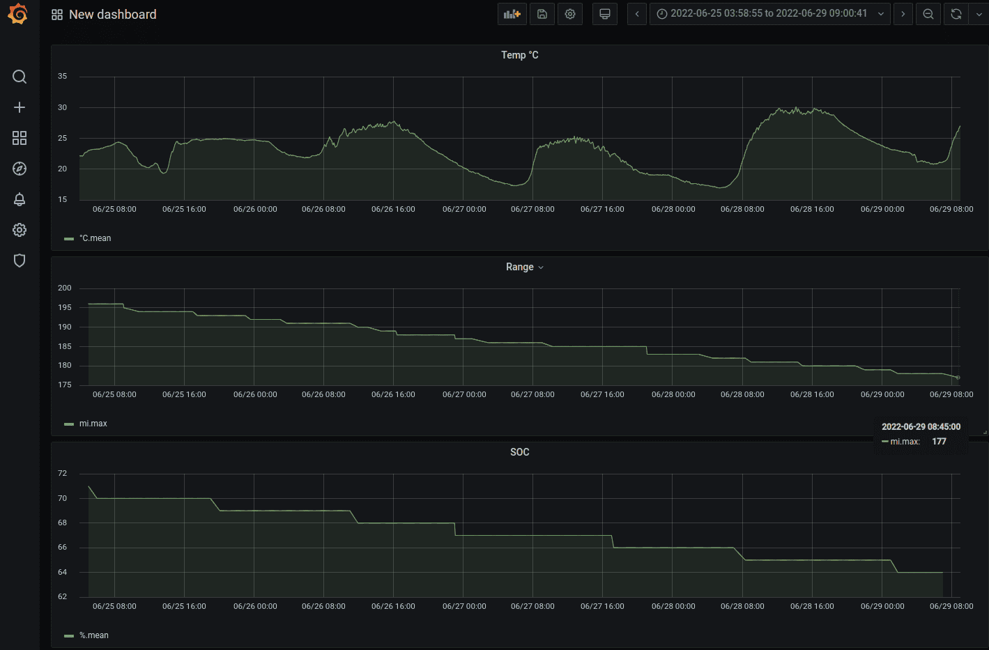

Looks like the battery loss is not a slow continuous loss but rather comes in big sudden losses about 16 hours apart. Not obvious related to temperature but we would really need to look at battery temperature not ambient temperature to know if it is going to battery cooling.
It's not large drops. That's just the reported percentage of battery. I'll pull the estimated range from that timeframe which will be slightly more granular.

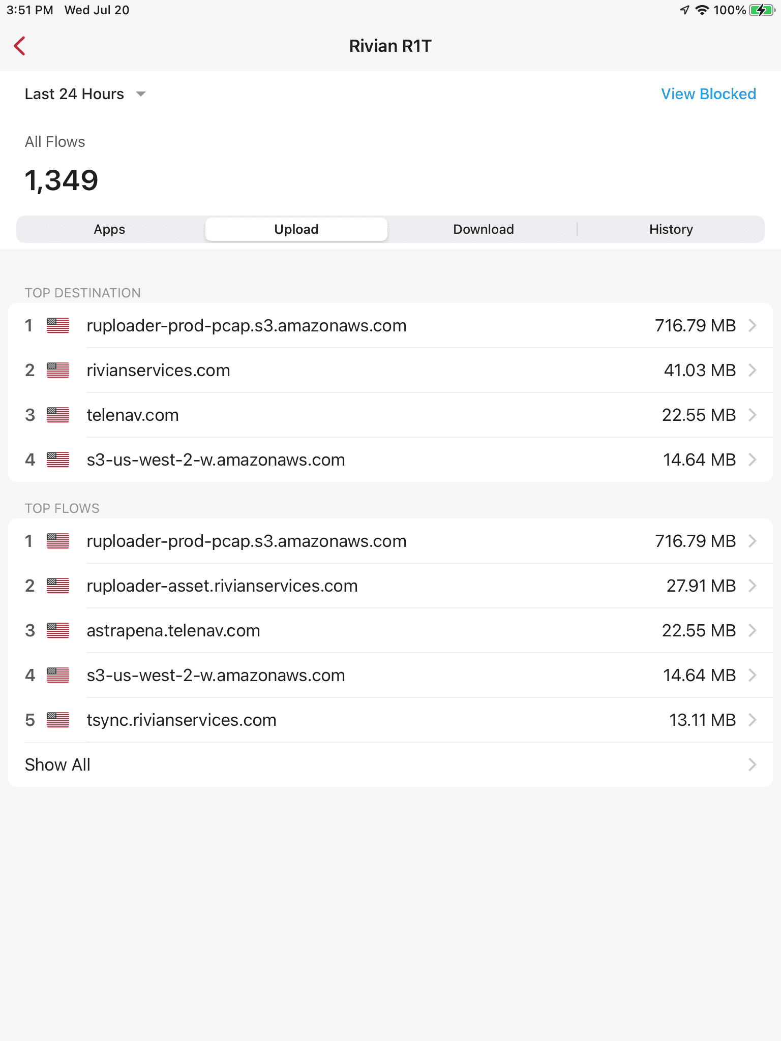

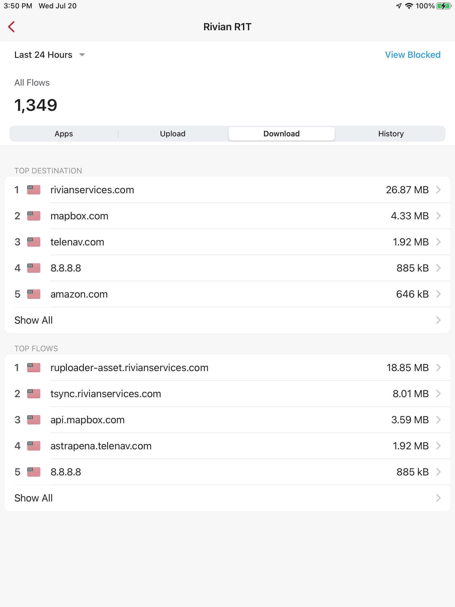

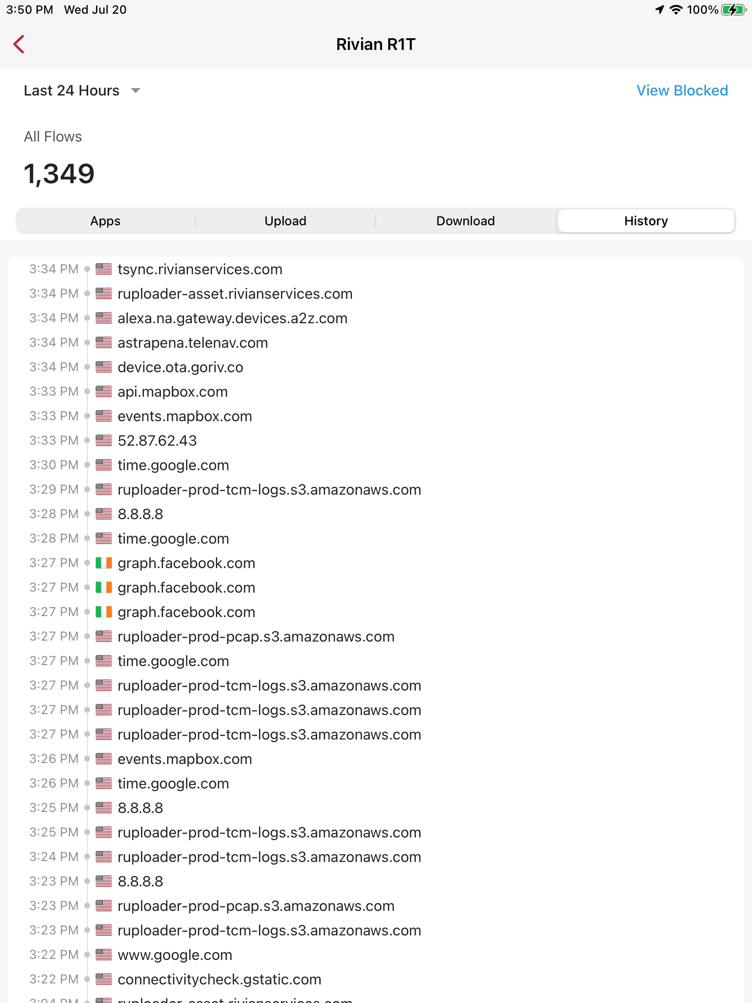

I wonder how much of it (the loss) is attributable to communications over wifi to the mothership? (Noting you had wifi off)
It’s very chatty; see this from my router/firewall…a sample of the 1,349 network flows in the last 24 hours, then top downloads and top uploads…
