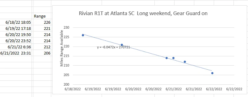

I am wondering if there have been any (comprehensive) testing of vampire battery drain when a Rivian is parked for an expanded period of time (over 2 weeks)?
Rivian took my R1T back to the Atlanta Service center last weekend, to work on the A/C. Tracked the battery range from the app from Saturday - Tuesday 6/18 to 6/21. From the tracking in the app, the truck set in the parking lot over that time, always in the same spot. (its not painful at all to see your new R1T setting in a parking lot for 4 days untouched, 250 miles away......)
When I checked on 6/22, the tracking map showed the truck in a building, the app showed it being hooked to charger, apparently Rivian was working on the A/C at this time. (The service tech texted me to tell me the freon was low later that afternoon, and they were checking for leaks.) I left the Gear guard turned on, but don't know for sure that Rivian didn't turn it off, will check for videos when I get the truck back tomorrow.
Over these 3 days, I lost ~6 miles of range per day. Data is a little noisy, prob should have taken more data points.

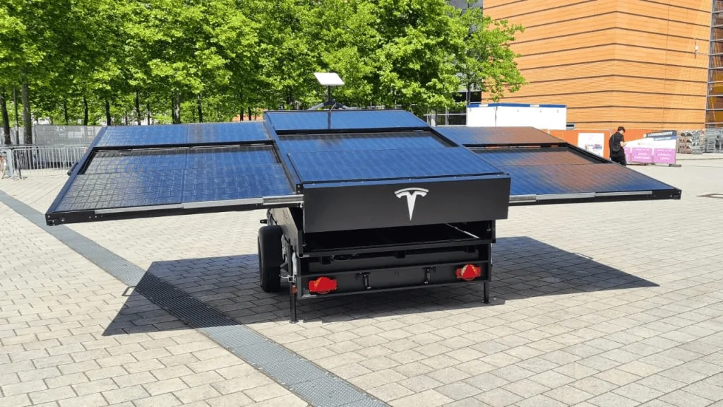

I am surprised Rivian does not have a lighter version of this in the shop already. An accessory you could include in bed or inside R1S for those solo iffy adventure trips. At 2.7 KW peak output it could beat R1 power leak.
