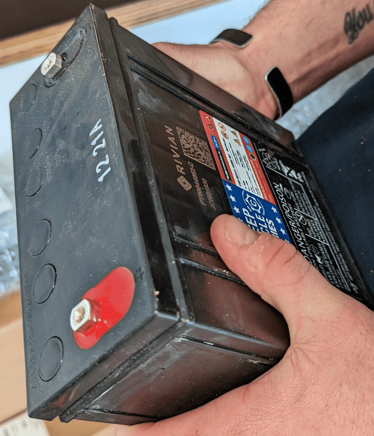

I have a feeling at some point Rivian may decide in order to shut us up and look better, to cut off the main pack when the vehicle is sleep and use the juice in 12V battery to do it's thing at night and report zero phantom loss. Then the next day when you are driving the car, juice up the battery like any ICE would and just show the hit in your efficiency and range while you are driving. With some safeguards so if 12V starts to get critical while napping, connect the main pack and rejuice. It is not fixing the problem but doing a bit of creative accounting VW style. I have to admit if I wake up in the morning and see the same range, then truck change it's mind and drop the range by a mile or two while I am driving, it does not feel as bad as it would, if it was honest with me to begin with. It is a philosophical thing, do you think total honesty is good for your relationship with your R1?
This is what they do but not to look better. They do monitor the SoC of the 12V battery and whenever it gets low the DC/dc converter kicks on and recharges it. This will be counted as phantom drain if it occurs when the truck is not it D or R.
I don’t know this for a fact, it is pure speculation; If what they do now is turn on the juicing process when 12V battery drops from 100% to 90% during sleep time. They could change the process and only turn on the juicer when the 12V battery hit 40% and juice only to 50% during rest and to 100% when in D or R. By doing this, you will see 0.25 Kwh improvement in phantom drain figures (I think each 12V battery was 21 A). They will look better a tiny bit, we feel better a tiny bit without change in the actual power consumption due to none driving uses. Unless this was included in the last OTA and they are already doing it.

12v Battery probably wouldn't last as long due to the constant deep cycles.

I thought you are safe over 40%
I'm not sure what the cutoff is for a non-deep cycle battery, but deep cycle RV's typically are stay above 50%. I'm guessing best longevity is just top-cycling, 25% at best.
Heres's a random graph from the interwebs on depth of discharge on lead acid AGM (lead acid is likely worse) 30% seems favorable to me.
Rivian Batter:y:
