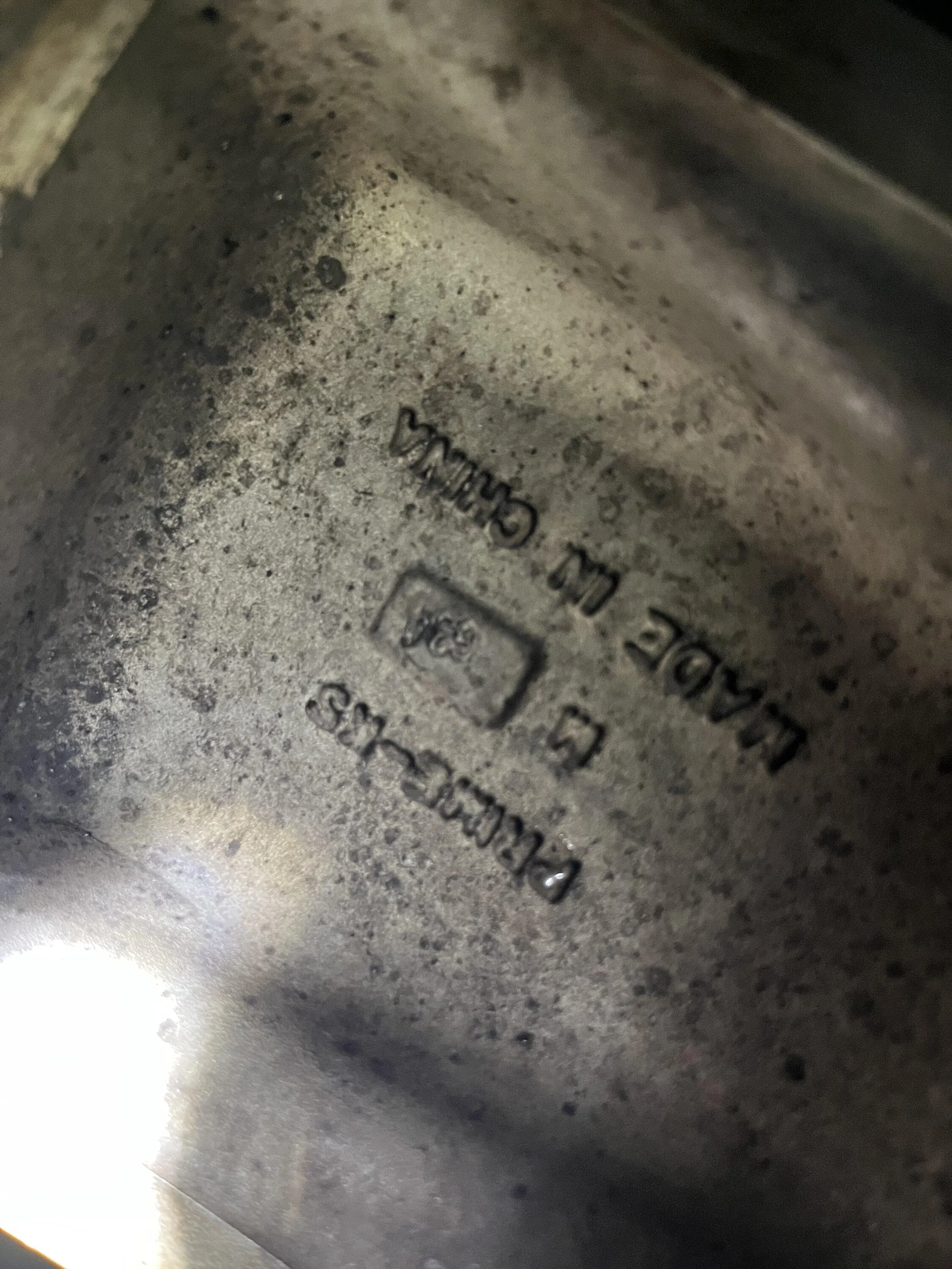

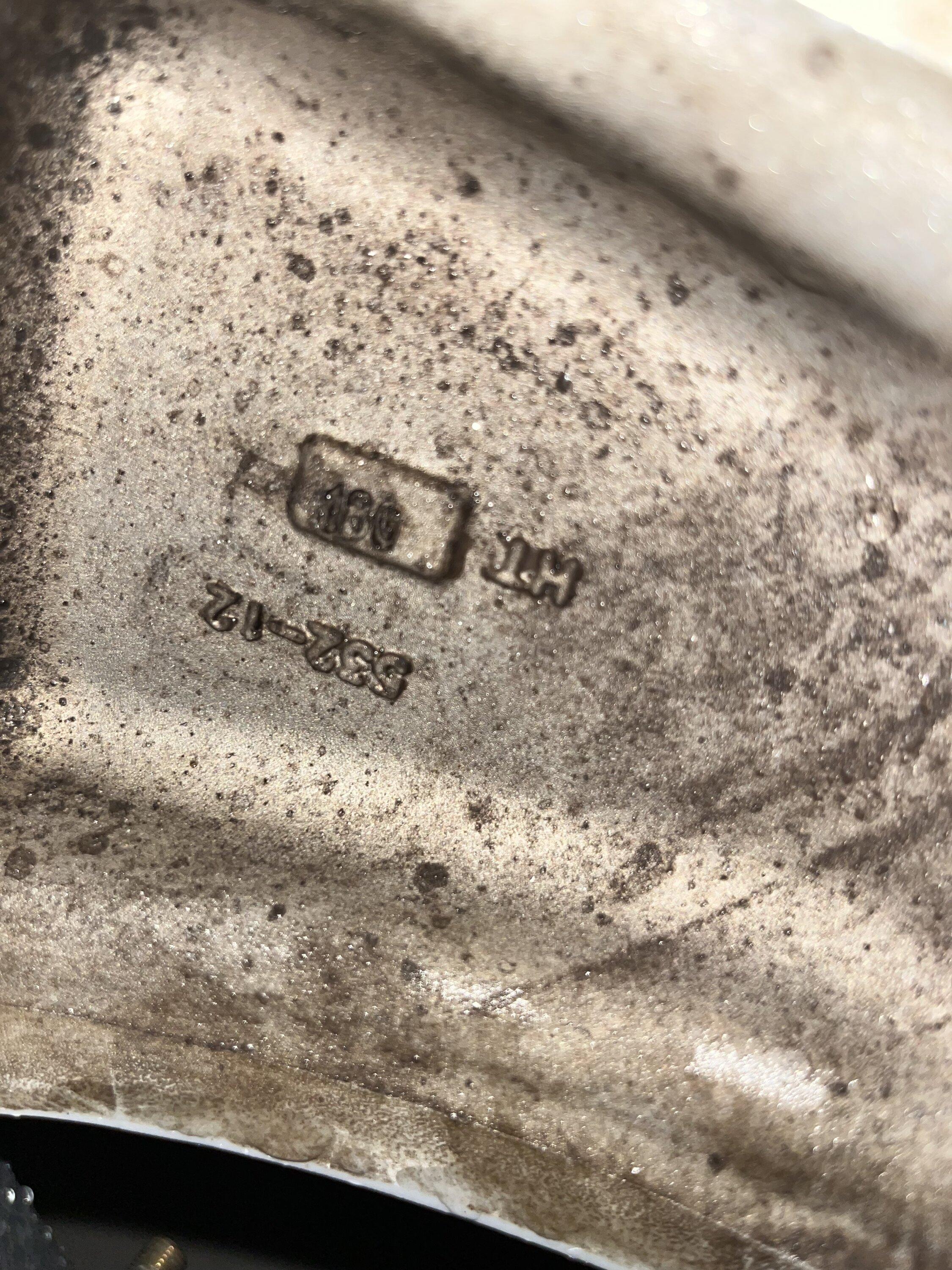

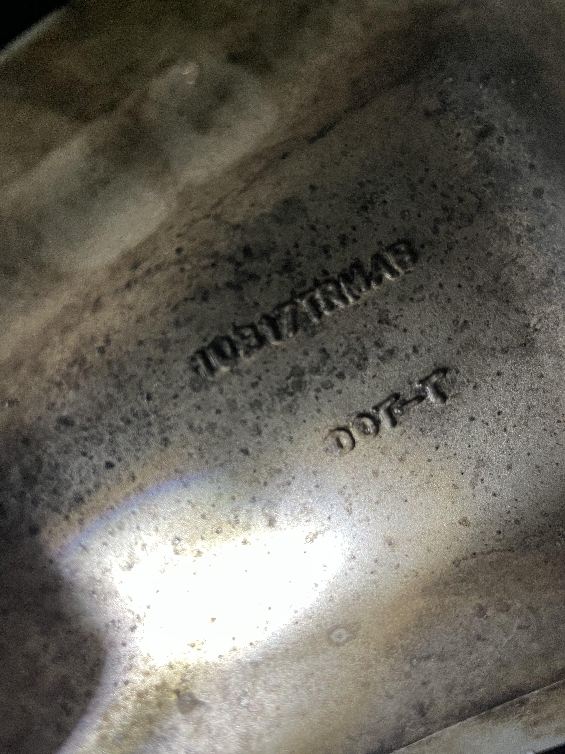

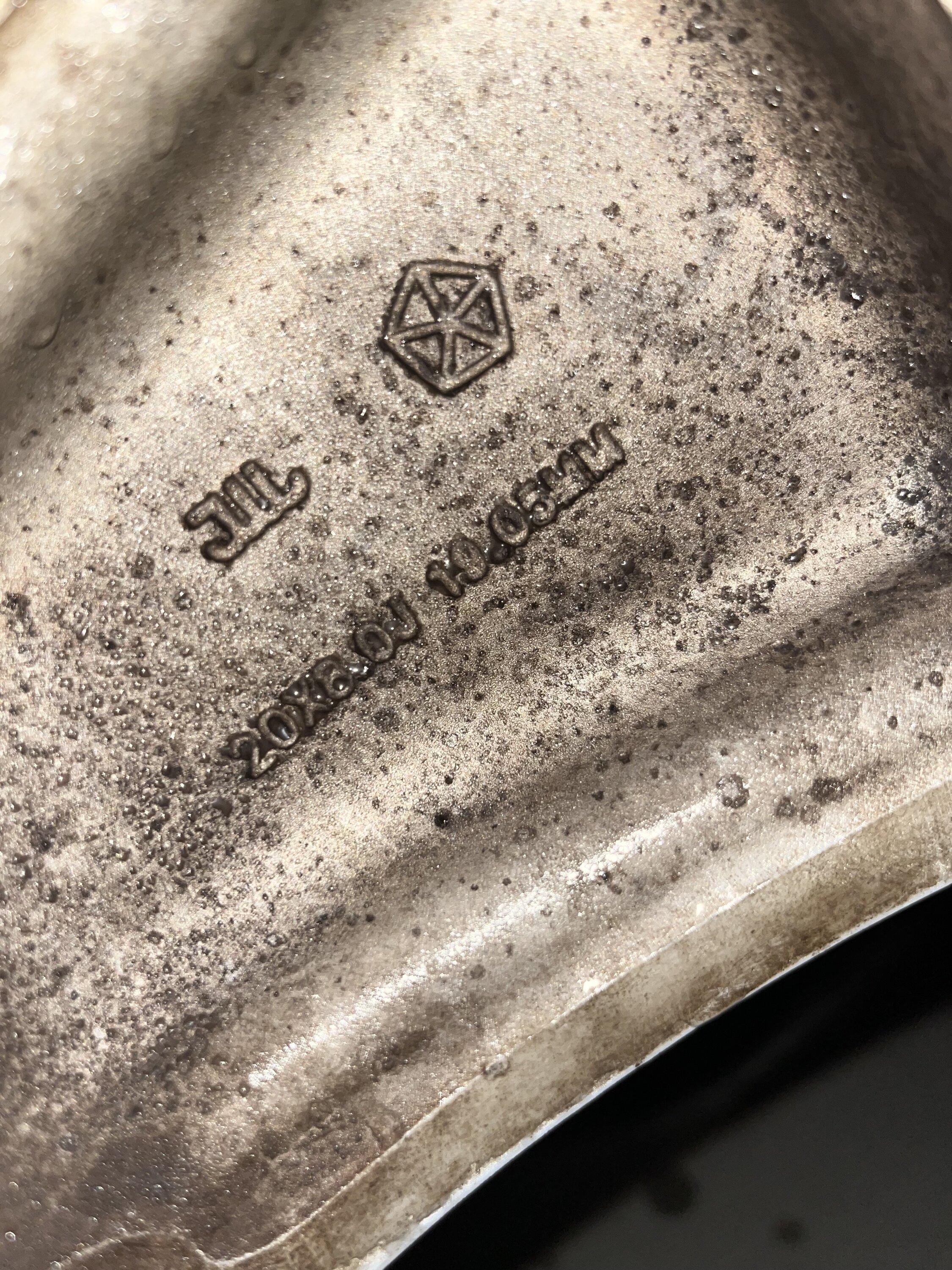

Hey Riviot, I found another set of wheels. They are supposed to be from a 2012. I have a few pictures and the size is correct, 20X8X19.05. The seller has taken pictures of every number on the wheel and there is no part number 2363. There are other numbers but I have no idea if they are part numbers. Do you know where the part number would be. Can you tell from a picture of the wheel if it is the right one?
Rivian R1T R1S Affordable Winter Wheels Setup: Ram 2363 IMG_6932
Rivian R1T R1S Affordable Winter Wheels Setup: Ram 2363 IMG_6935
Rivian R1T R1S Affordable Winter Wheels Setup: Ram 2363 IMG_6925

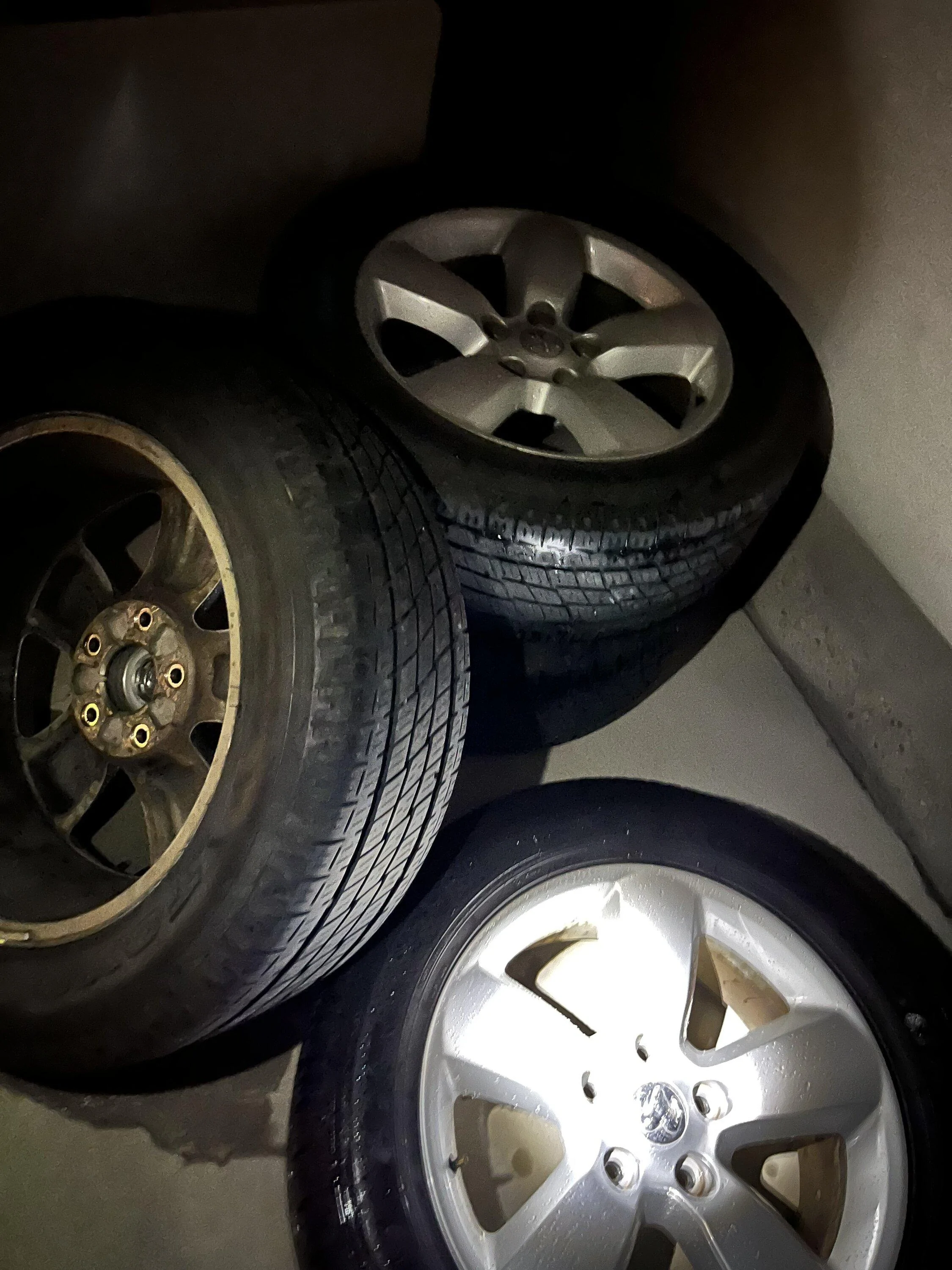

FYI...here's the original post from Rivian Stories that I constantly referenced when searching for these wheels many months ago. Members there clearly illustrated what to look for and why other similar Ram wheels (not 2363) would not work. It's a long thread, but worth a look: https://s00n.rivianstories.com/posts/27424783
Also, as @Riviot said...those are NOT the proper wheels, and I can tell by the front pictures of the spokes.

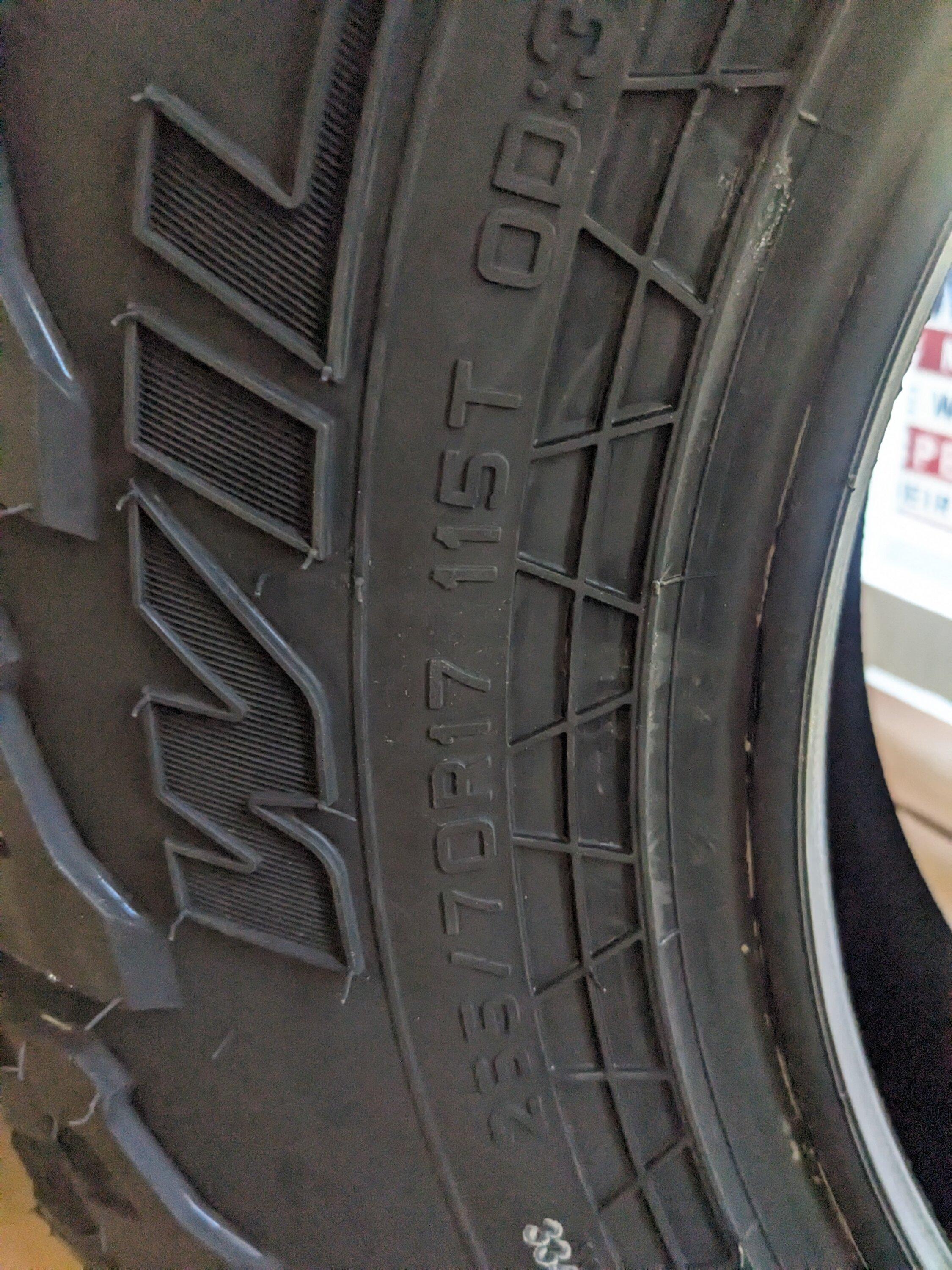

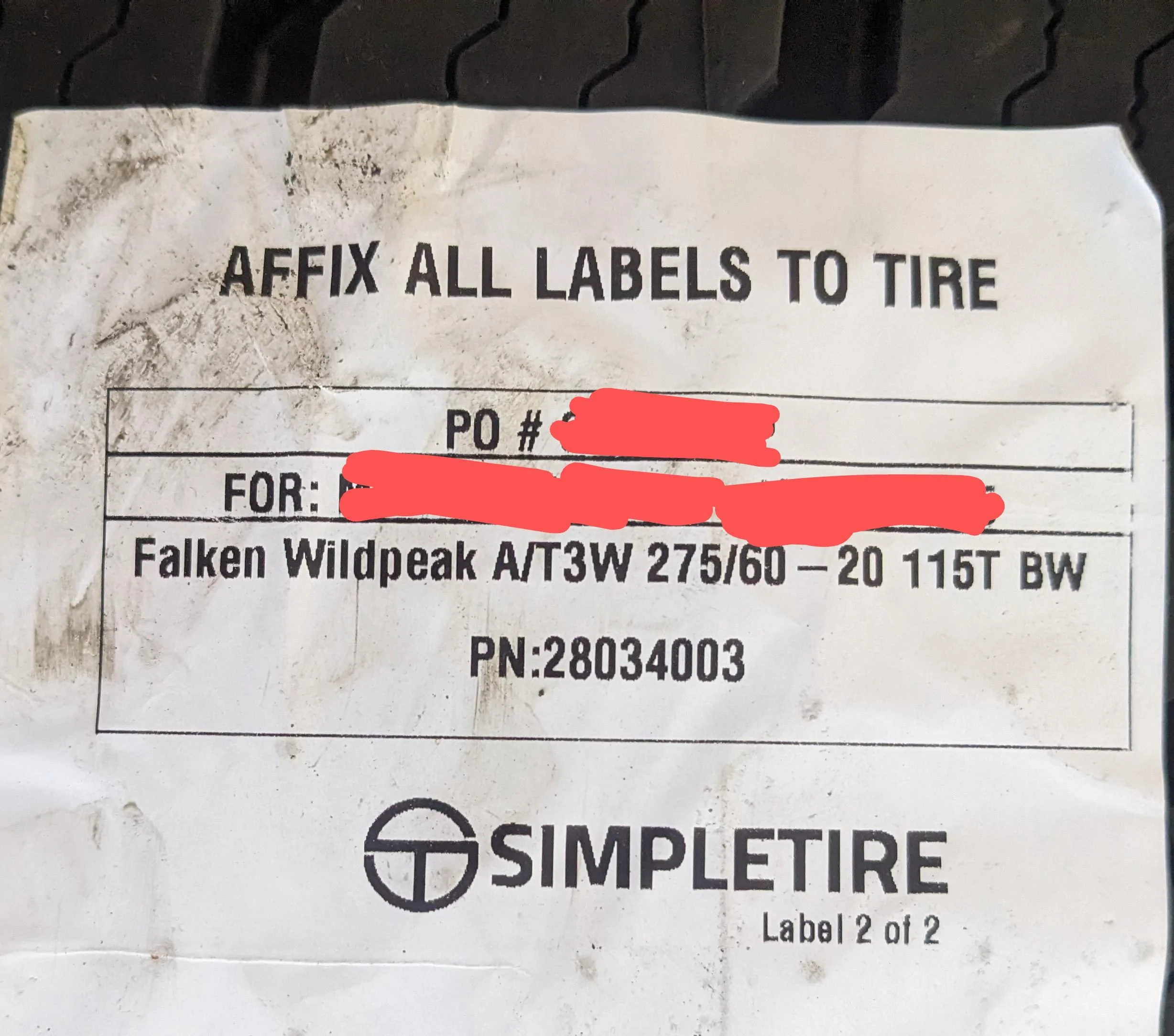

Well, I got half of my tires today. Simple Tire screwed up the pick on 2/4 tires. Saving instantly on Amazon may not be worth it, and applying for a tax exemption with Discount Tire Direct may be in order... Has anyone else had trouble with Simple Tire? The warehouse is 30 minutes from me, I wish I could just go down and swap instead of the wasted UPS drop off/pickup.
Rivian R1T R1S Affordable Winter Wheels Setup: Ram 2363 PXL_20230824_224408220
Rivian R1T R1S Affordable Winter Wheels Setup: Ram 2363 PXL_20230824_224404355.MP~2
