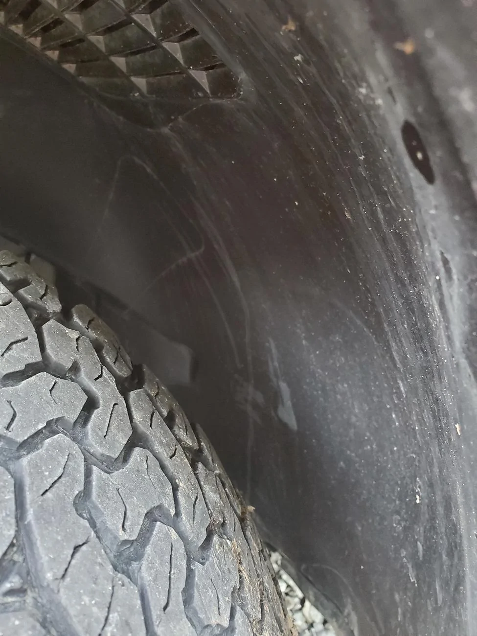

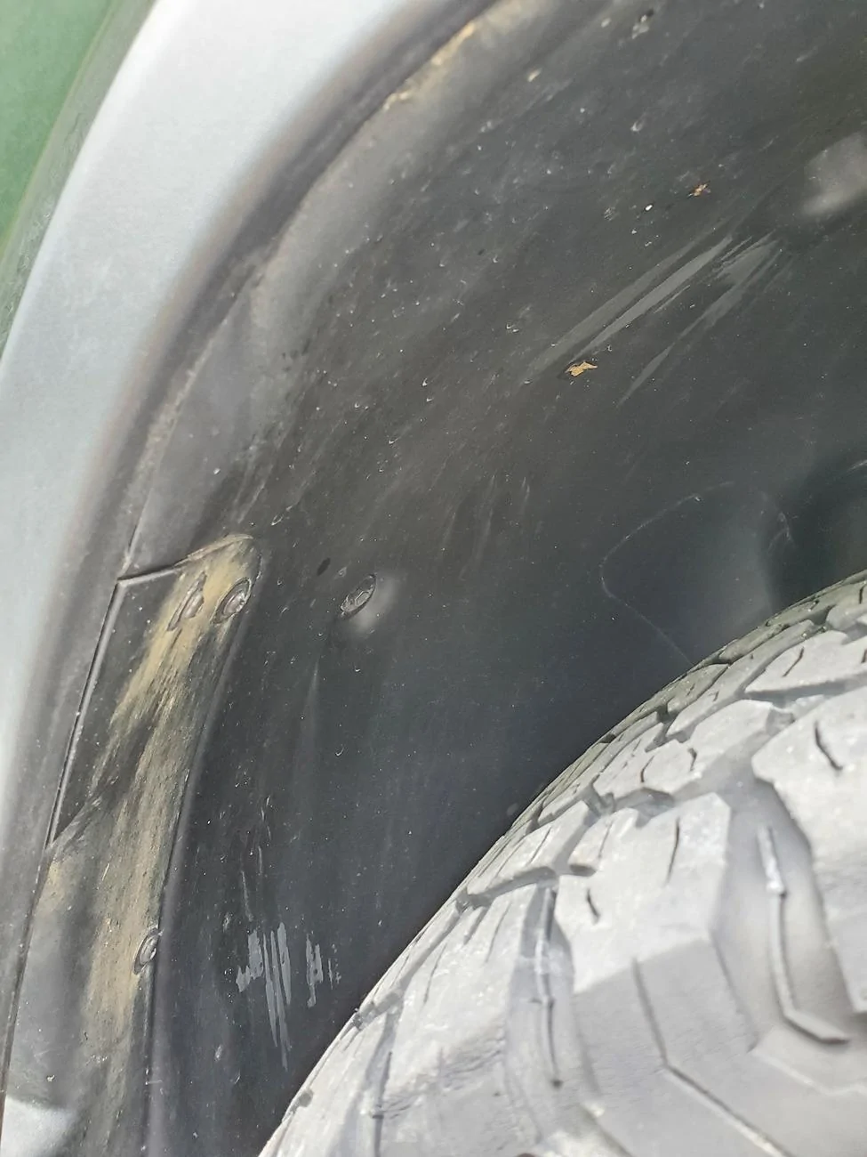

One question about rub - I know it's unlikely (sounds like the 275/60/20s don't generally have issues in standard/low), but is there anything I should be keeping an eye on to ensure it's not happening? Looking inside my wheel well right now I see some marks on the inside, but I'm guessing any rub from the tires would be at the top of the well, where the tire pokes beyond the top of the body?
If you go OEM 34", you'll get rub in low or lowest. I wouldn't ever go in Low or lowers with 34" if you can help it, definitely only in firm if you have to. We do low/firm with 33" on Rams and never rub.

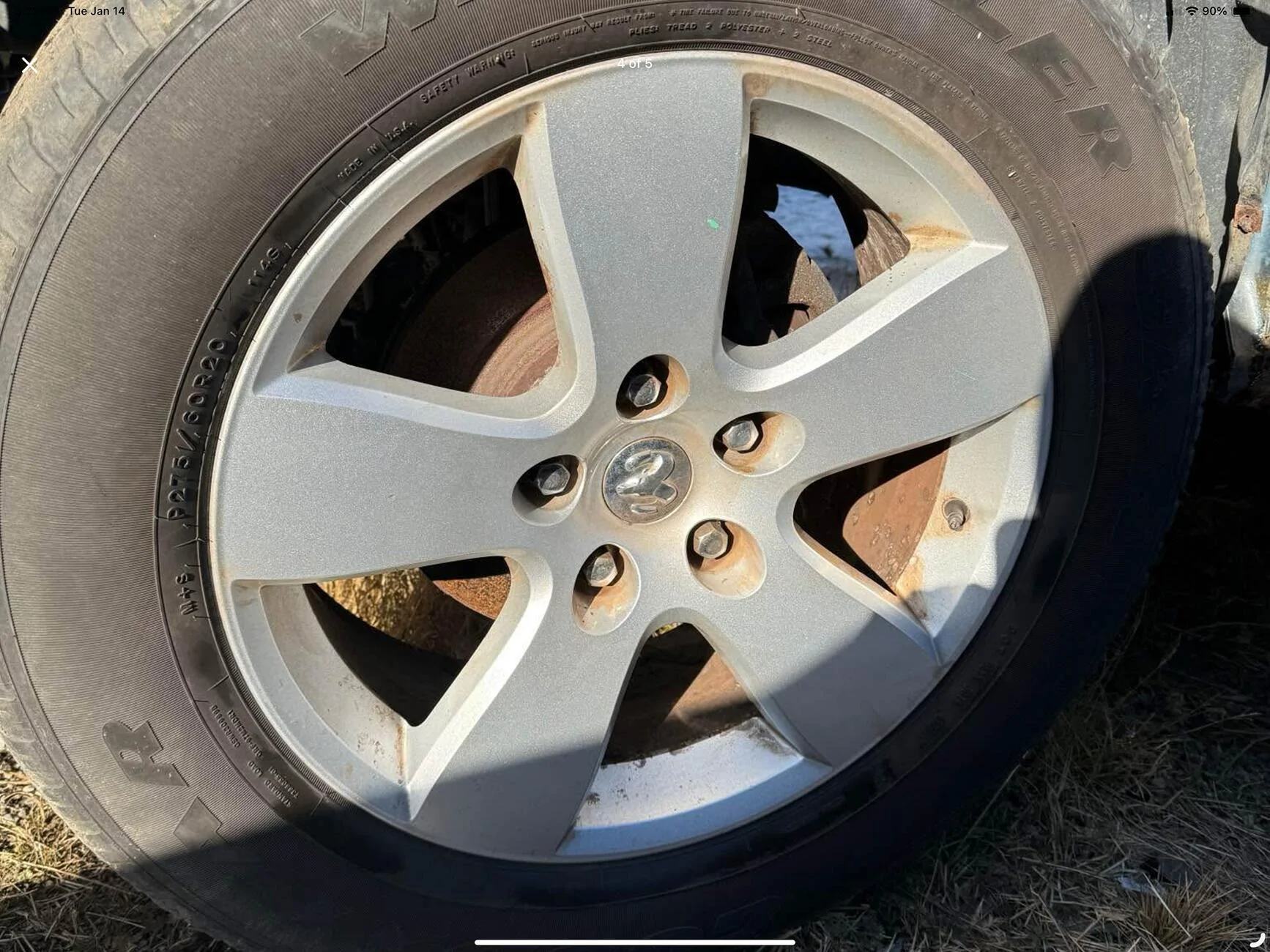

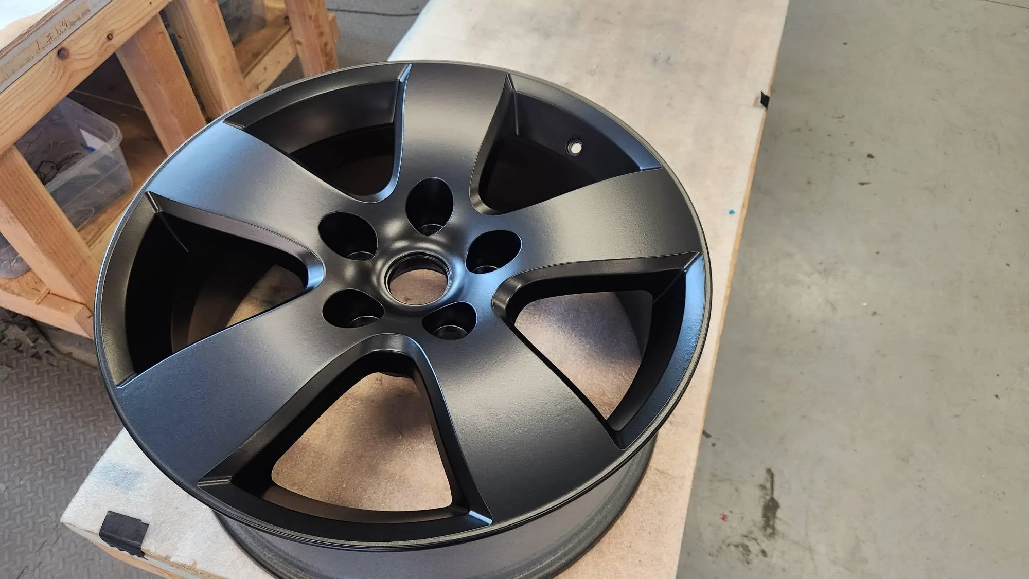

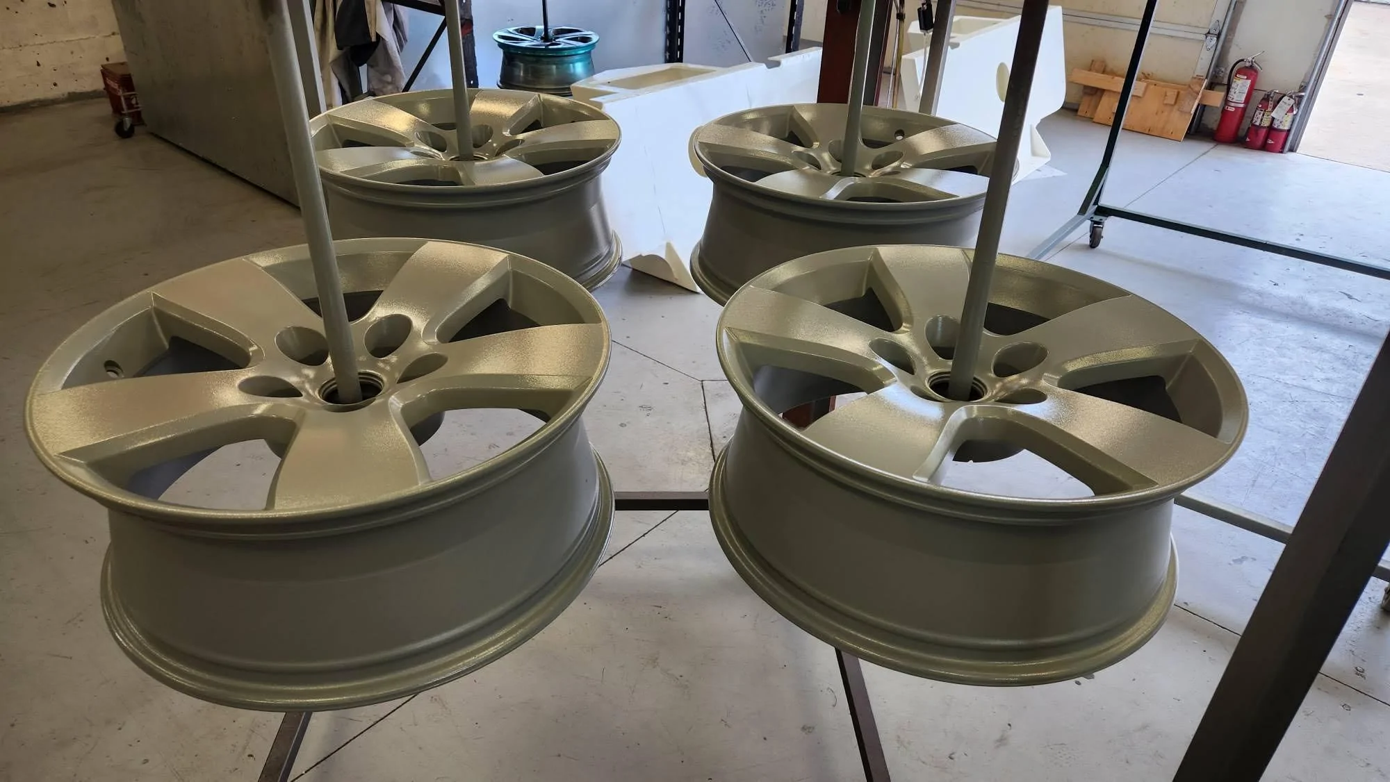

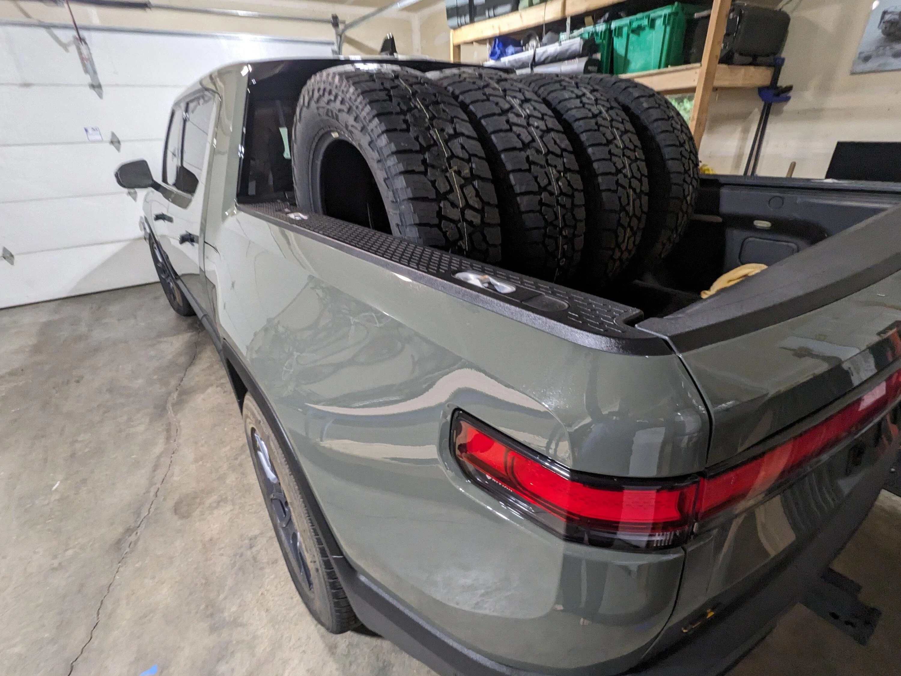

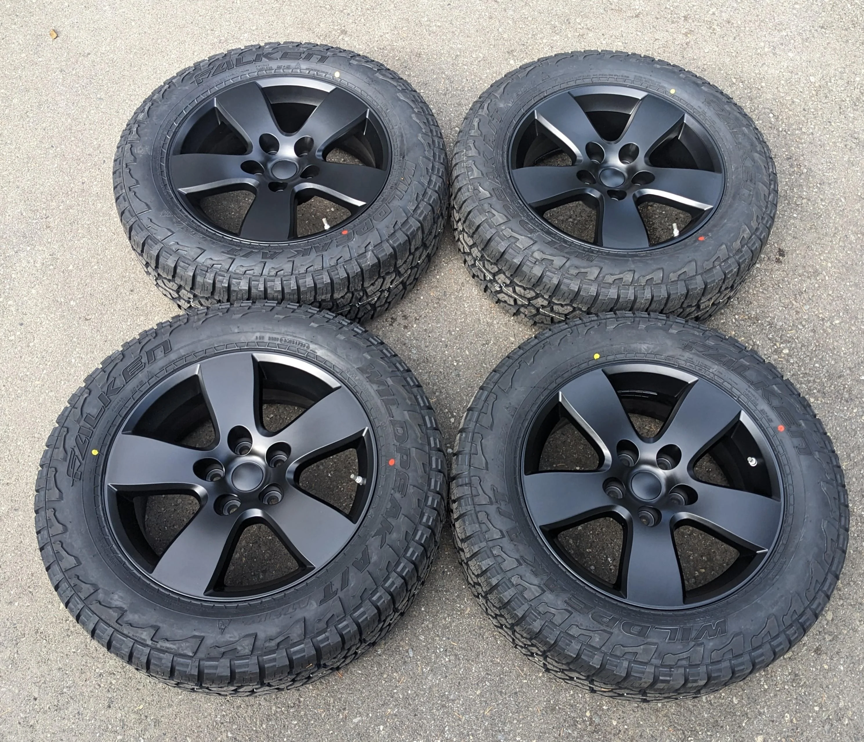

It's finally happened, I found some Ram 2363 wheels for a reasonable price! I'm picking up tomorrow and taking them to a local powdercoating shop to get blasted and painted satin black.
Edit: updated prices and picked some tires!
Wheels: $150
Sandblast/Powdercoat: $550
TPMS: $107
Center cap: $25
Hub centric rings: $15
Falken Wildpeak A/T3W 275/60R20: $1107
Mount/Balance: $116
TOTAL: $2070

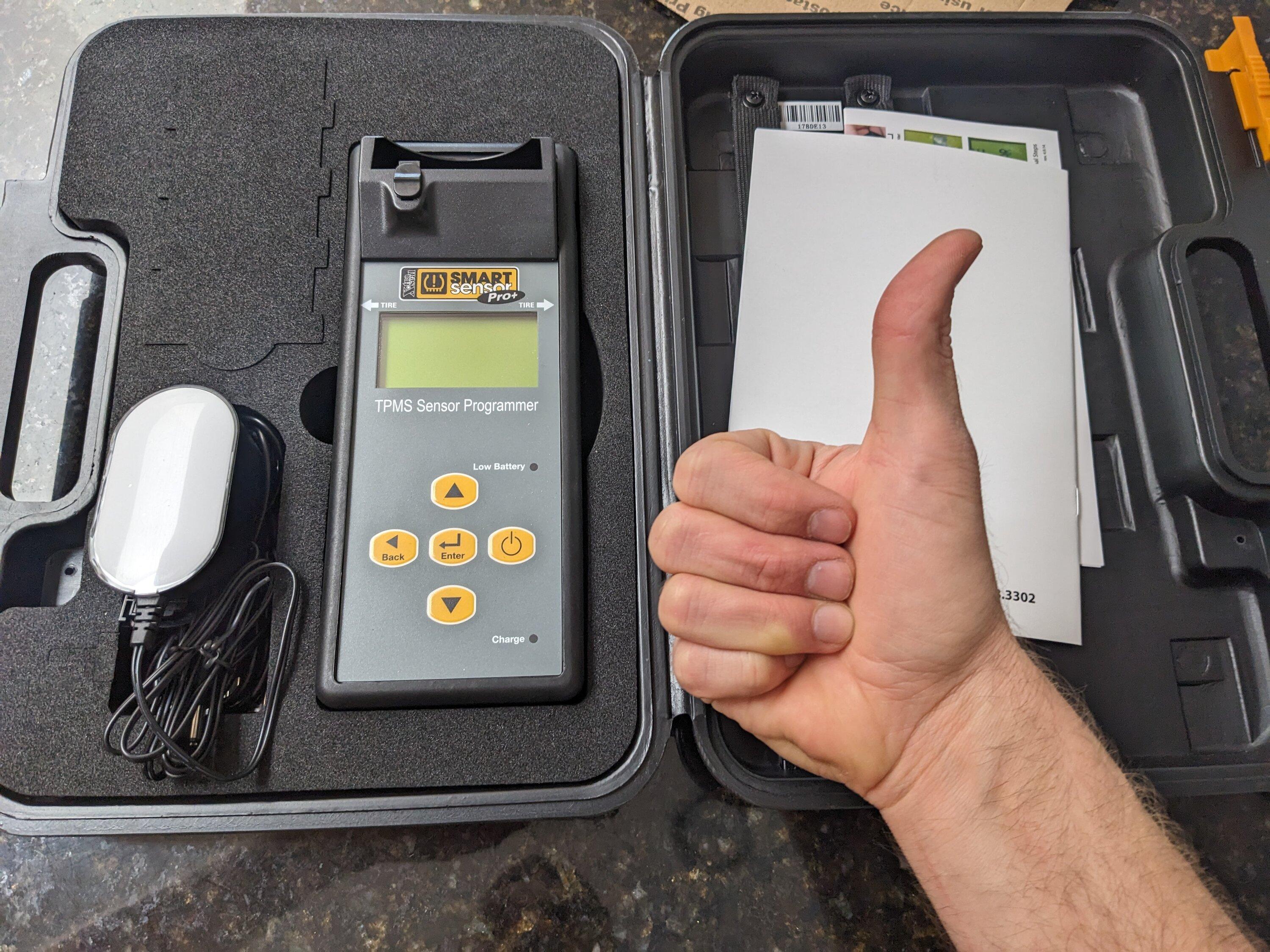

I bought the TPMS sensor programmer and plan on keeping it for at least a year, so if anyone needs it, PM me and we can arrange pickup or shipping. It fits in a small flat rate box, so round-trip shipping is $20.
Update: These TPMS sensors have successfully been used by other members without any programming needed, https://a.co/d/gV1P2dE

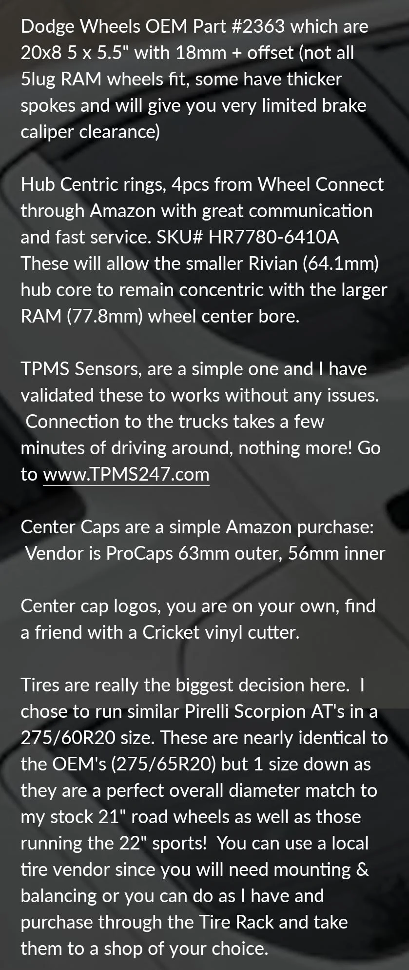

Thanks to @SeaGeo for previously posting this:
Step 1: Get some cheap wheels
Step 2: Strip and prime
Step 3: Spray in satin black (only acceptable finish/color)
Step 4: Take new tires to be mounted a week later because Amazon/Simple Tire took a while to correct your order after sending half of the wrong size ?
Step 5: Clone the sensors with the Smart Sensor Pro+ TPMS sensor programmer.
Step 6: Come home a happy camper and patiently wait for winter!
Step 7: Install at winter and hit the trails
Step 8: Find another cheap set of wheels and a good deal on tires, get addicted to the project, and start it again!
