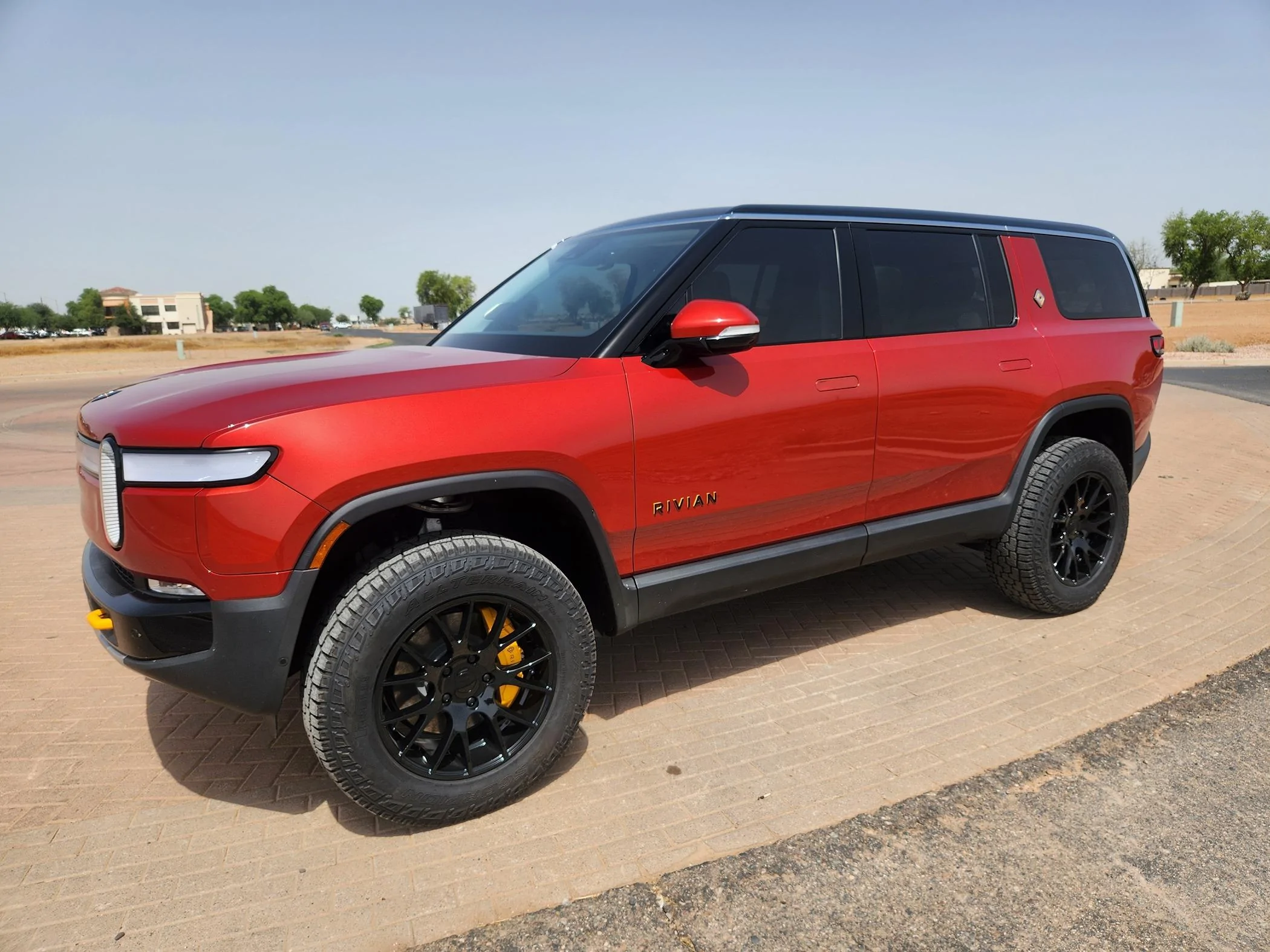

I've had this set of Dodge wheels ($550 delivered for all four, small scuffs) for about 18 months ,as a back-up set for my R1T. It was time to rotate the tires on the R1S, so I thought I'd toss the Dodge wheels on with the OEM 20" Scorpions.
Ton's of compliments and completely changes the look from a people mover SUV to something a bit more aggressive. No rubbing in daily driving in Low, which is surprising considering the +25mm offsets, which causes the tires to stick out a bit, but I actually like it.

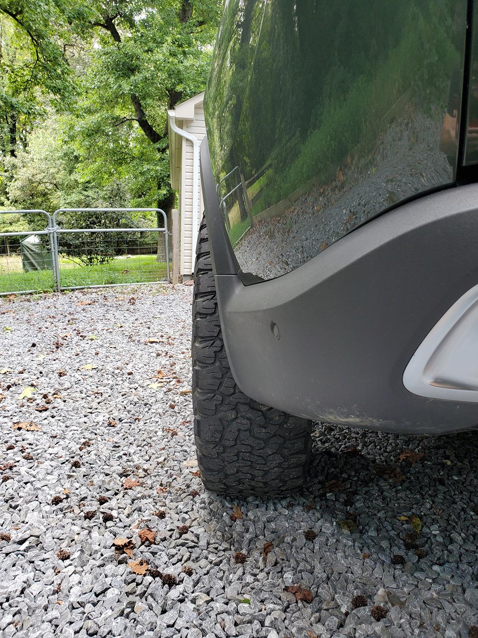

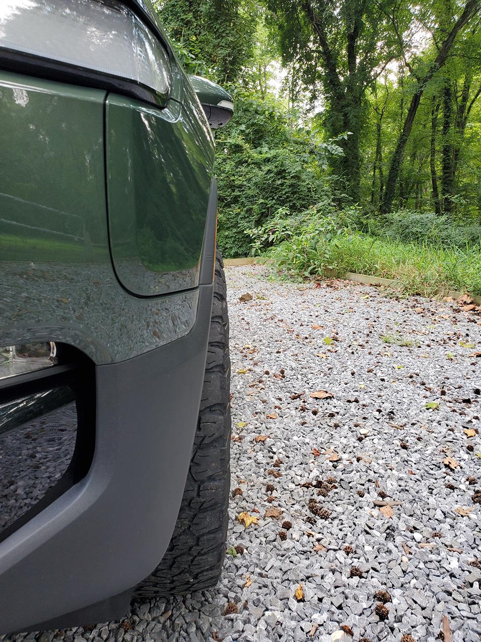

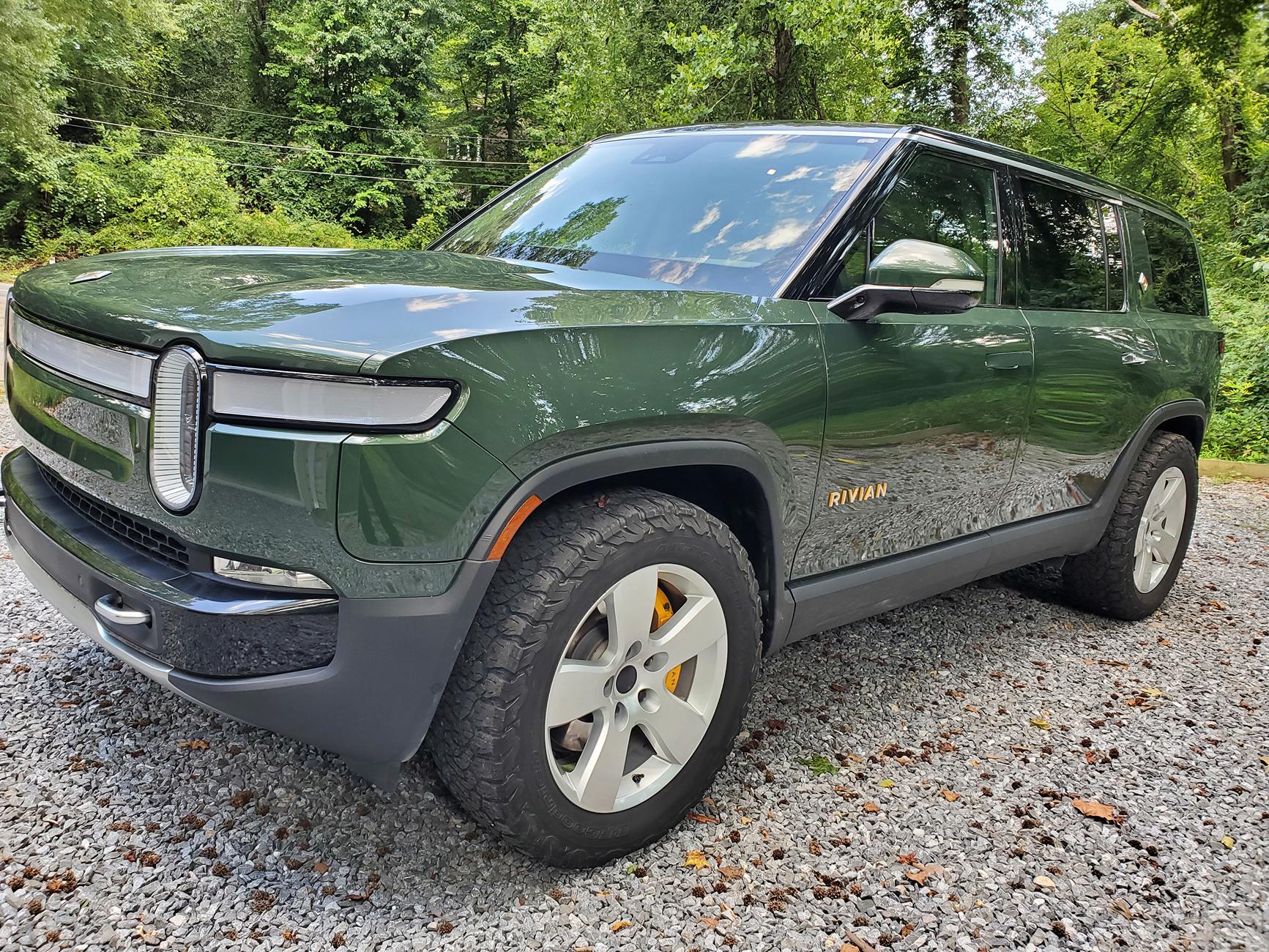

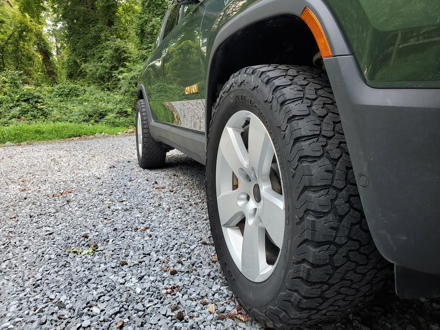

Just had a chance to get the RAM wheels fitted. Worked with a tire shop to get them fitted - they weren't familiar with the vehicle, but had me guide them through the process. I'd appreciate a double-check of my steps to check that I didn't screw anything up.
  1. Tire change mode on (forgot to put in AT/highest, though)
  2. Popped off the jack covers and used my jackpucks to lift with a floor jack
  3. Removed 21" wheel
  4. Tapped on hub centric ring and tightened down 20" RAM wheel
Anything I missed (besides the AT/highest for tire change mode, hoping that didn't damage anything)?
The RAM wheels/tires were previously being used on another R1S w/ TPMS. Is there anything else I need to look out for now that the wheels are fitted (balance problems, etc.)?
  • TPMS hasn't resynced yet, but I haven't driven much. Hoping they sync up on the next drive.
  • They definitely protrude much more than the stock wheels, will have to see how efficiency is affected for highway miles.
Rivian R1T R1S Affordable Winter Wheels Setup: Ram 2363 20240810_134117
Rivian R1T R1S Affordable Winter Wheels Setup: Ram 2363 20240810_134131
Rivian R1T R1S Affordable Winter Wheels Setup: Ram 2363 20240810_134207
Rivian R1T R1S Affordable Winter Wheels Setup: Ram 2363 20240810_140303
Mar 29, 2021
121
6,435
10,832
Kitsap, WA
You got the (corrected) steps right. Protrusion doesn't affect range as much as the tires themselves. I found similar range on identical tires, technically better range on the Ram rims.
Are these from @kanundrum ? If so, I would ask about the mileage warranty ?
