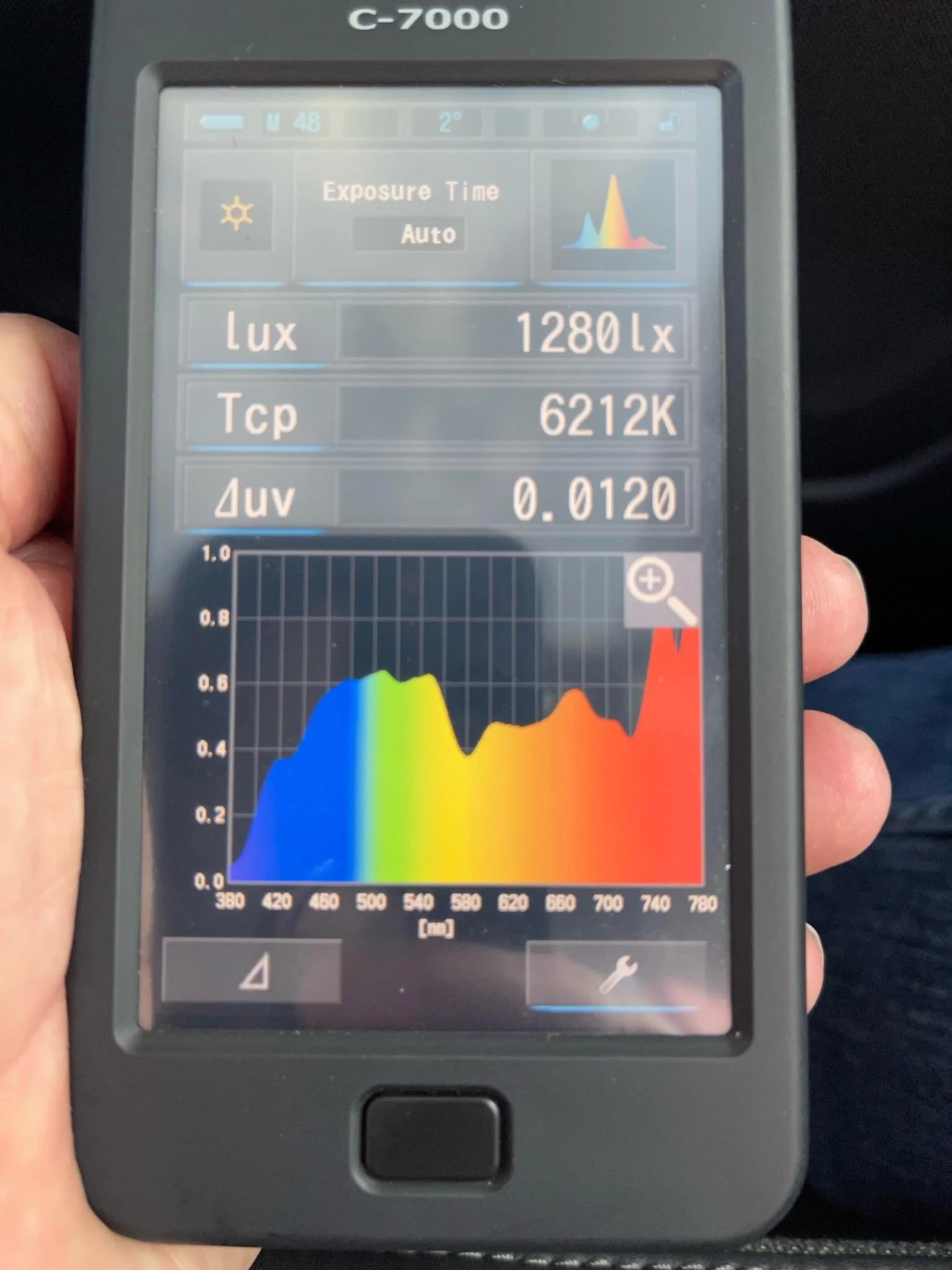

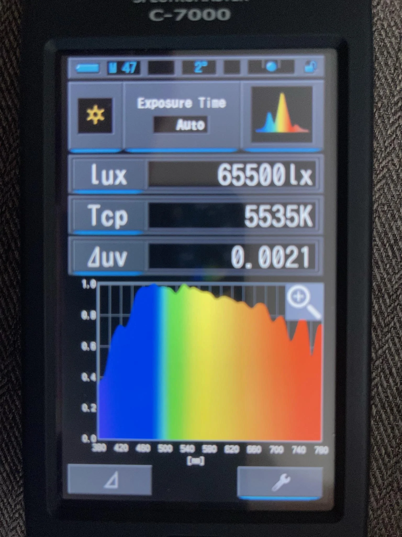

I did a light spectrum analysis of the outside versus the inside to measure the efficiency of the glass top. While the data confirms the glass certainly reduces the UV (Below 400nm) it also reduced the intensity from outside = 65,500 lux to 1280 lux inside. The data is attached.
While the intensity was certainly reduced, the heat radiating from the glass top could certainly be felt. Temperature today was about mid 70’s during our drive. We will need to engineer some type of insulated insert.
So am I reading that chart correctly that it doesn't knock down the IR pretty much at all? That's disappointing if they didn't put ceramic tint on it from the factory.

We had our First Mile today, and it was a blast…. Everything we had hoped for was delivered. We were the third drive for Dallas area.
Yes, the day they delivered mine it was 90 outside and full sun and it can be felt...I worry for the 100 degree days.
I can definitely feel the heat in my Model Y when temperatures go above 90.
