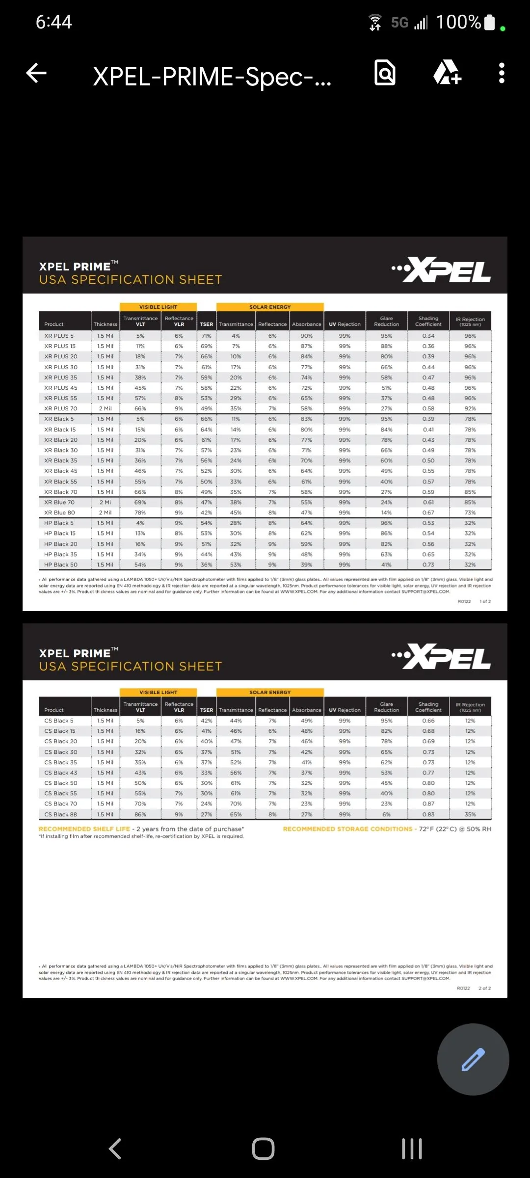

For what it's worth, I'm having Xpel Prime CS 88 tint put on the windshield. On the outside of the windshield and on top of the roof glass, I'm having Exoshield applied. The Prime CS 88 tint still transmits 86% of visible light while rejecting 99% of the UV and ~58% if the IR. I've been told it has none of the low-angle haze present in some other tints and far less of that oil-slick look you can get with polarized sunglasses (a must for me to kill glare).
The Exohield also takes out about 99% of UV, so that's a bit of overkill, but it'll also add glass protection to the windshield and roof. Being a sports junkie and living in the insurance field, I've seen the occasional rooftop cargo bar take an incoming fastball and lay down a bunt that makes it into your infield, otherwise known as the interior. Really spectacular play if someone's 90 feet away and heading home with the game on the line, but not so fun if you're 90 miles from home, and heading out on vacation in a driving rainstorm.
It's not a solution, but it's a start. If it stops even a little of the heat from coming through the roof (along with smaller rocks - the large ones won't be deterred), all the better. I'm actually toying with having a smaller pattern of high IR-rejecting tint put on the outside of the roof before the Exoshield. If the tint were cut to cover the inside dimensions of the opening and the Exoshield covers the tint, and the rest of the glass all the way to the edges, I'd think we'd avoid the phenomena of glass exploding due to interior tint retaing the heat as @SoCalTravels mentioned previously.

Rivian R1T R1S Glass roof UV reduction efficiency measured (@ First Mile Dallas) Screenshot_20220407-064433_Drive
