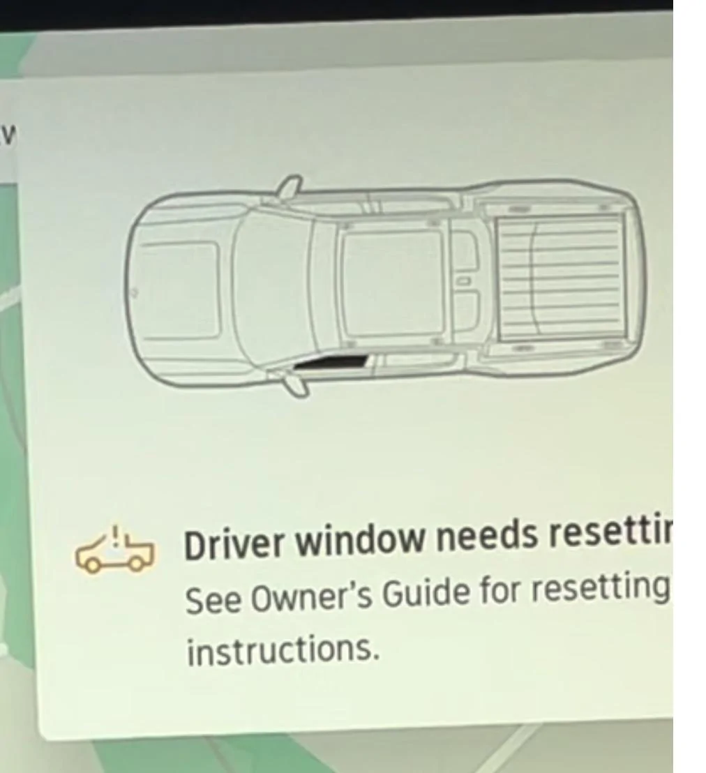

I've had the window rolling back down to the 66% closed position problem twice. First time required a service tech laptop connection to the ODB port and full recalibration to windows and seats. I've now had this condition a 2nd time and it's been a couple months. I've got a mobile repair scheduled for this coming week. But using this method today got me as close as I've been to fixing the issue. The window will close all the way and allow me to hold the rocker switch in the up position for a full 10 or 12 seconds. Both after holding the rocker (pre-dent click) down for 10 or 12 seconds and returning the window to closed flashed a screen (happened too fast to read). I thought I might be onto something... but alas nope: I video'd the process and did a screen capture of the single frame. Basically it's telling me what I already know. I'm not gonna cancel my mobile appointment.
