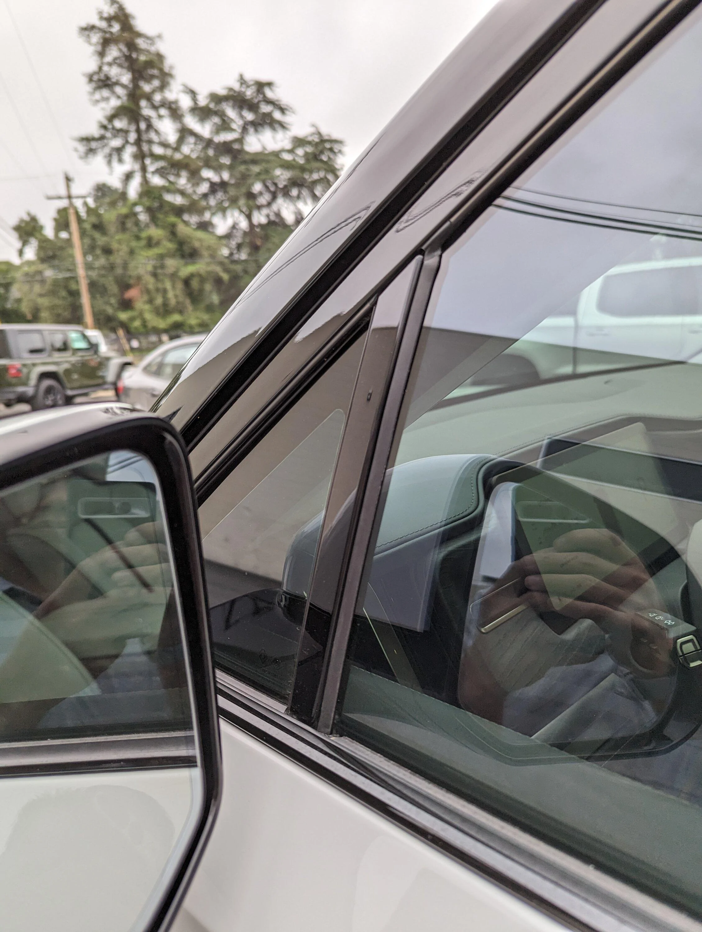

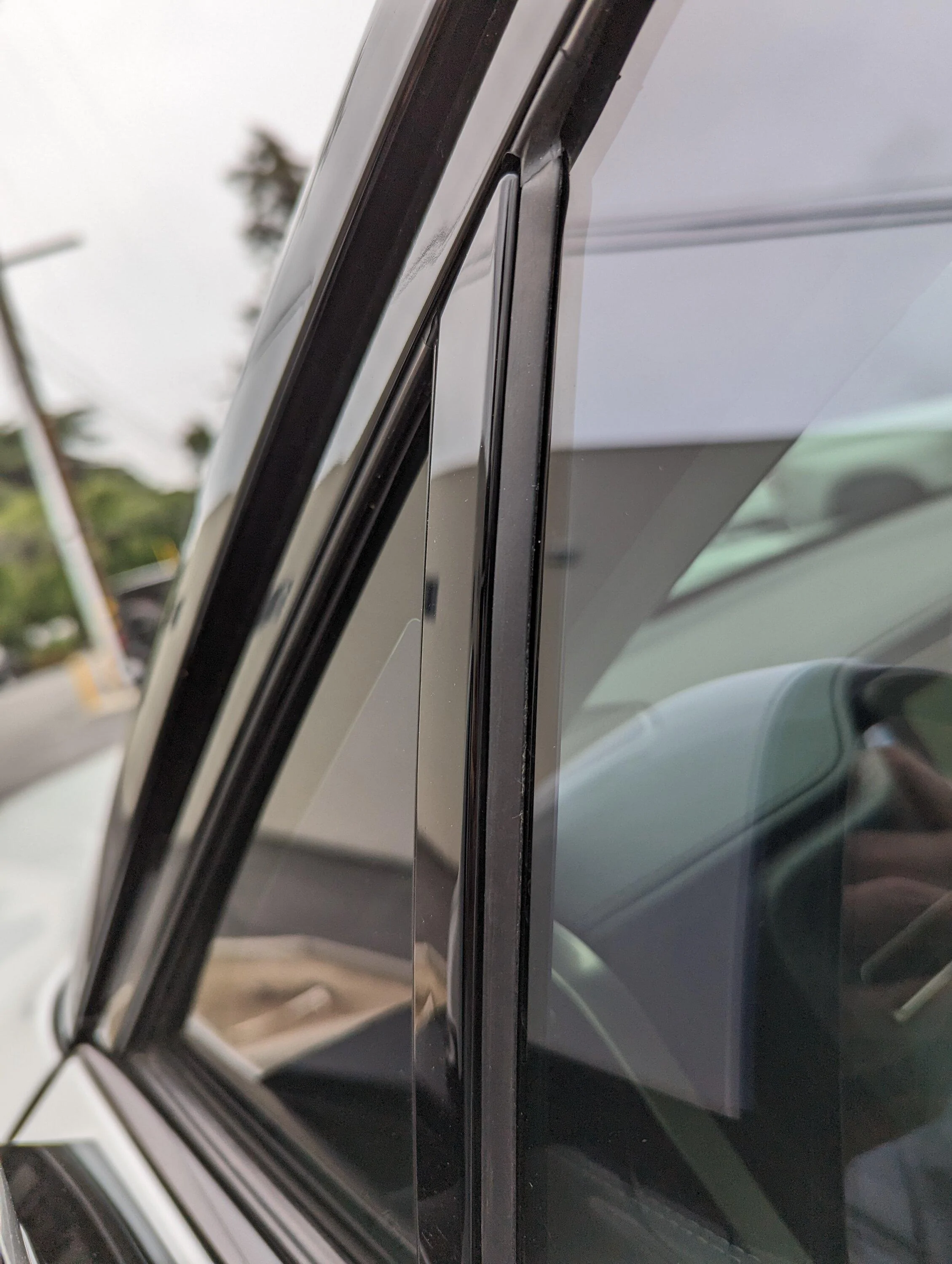

I just found the biggest culprit for my wind noise. It was coming from the vertical rubber piece on the triangle window. I looked closely yesterday and noticed that the rubber piece wasn't completely straight and seated against the window. It was off the window by only a small amount. With the window open, I massaged it by pushing it in and towards the car. Took it for a drive and it is now pretty quiet.
Hope this helps some of you. Quick test would be to just put painters tape over that area and go for a drive. Would've been nice to have found this out before my 2600 road trip last week....
