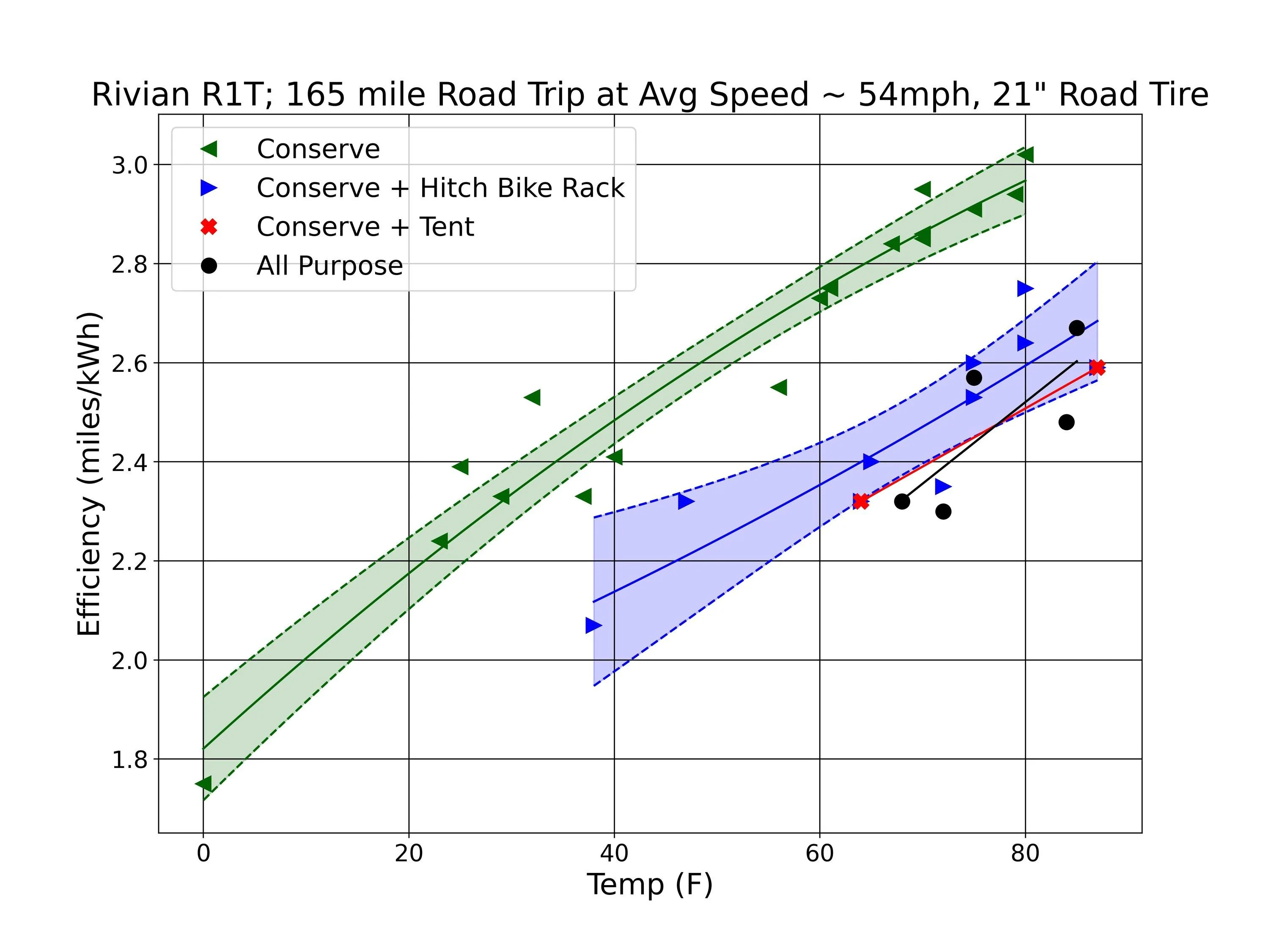

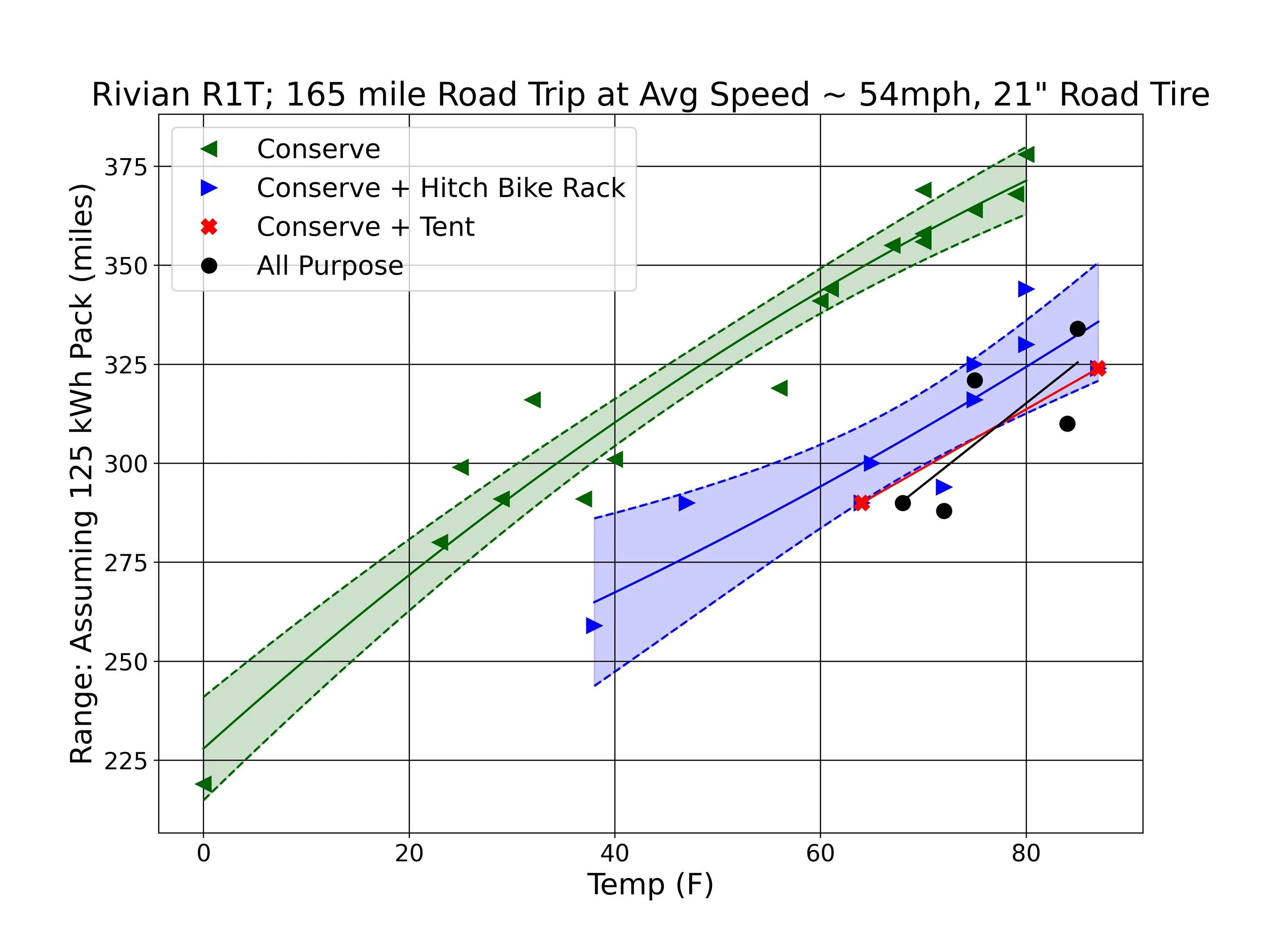

Anyone that says you only get a 5-10% range increase using conserve clearly isn't using both AP and Conserve that much. Yes I realize the EPA numbers are what they are, but manufacturers can play with numbers (namely lower them) to their liking.
I just did a 200 mile trip in conserve averaging about 60mph with a cross wind and only used 50%.
Between my experiences and the charts above you probably see a 20%+ range increase using conserve.
I know I know, you can go through tires a bit quicker, but I think this is only bad if you drive it non-conservatively in lots of stop and go.

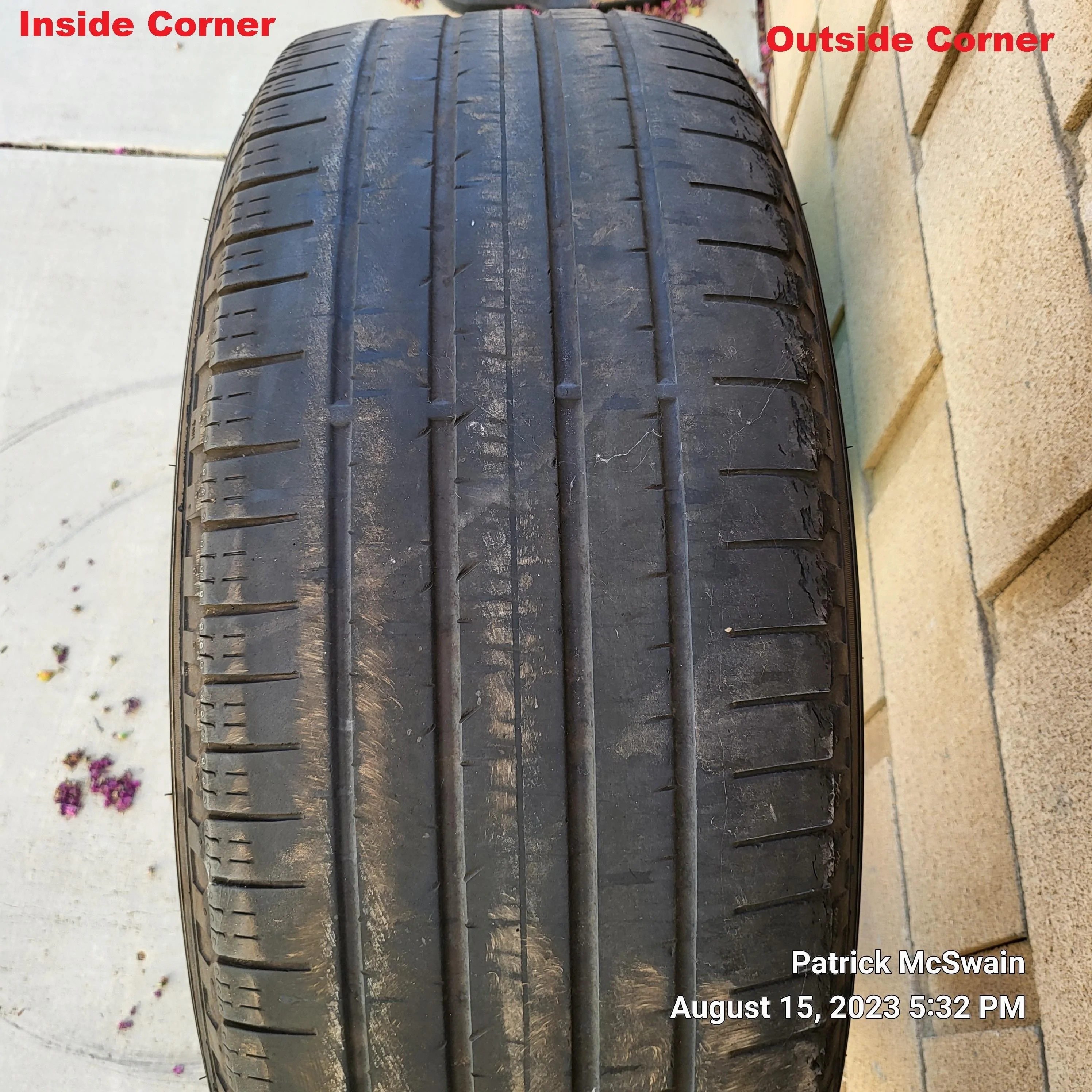

Front Tire Wear at 15k miles - Here is a picture of 90% Conserve, and 10% in Sport ALL OFF (<1% other). Autocross and 4-wheel drifting exhibitions chunked the outside blocks.
3 out of 4 wear bars are equal, since the other is < .030" lower, it could allowable mfr'g tolerance. The stipes on the inside are still there.
The outside was destroyed very quickly. Don't autocross or drift unless you have a sponsor.
