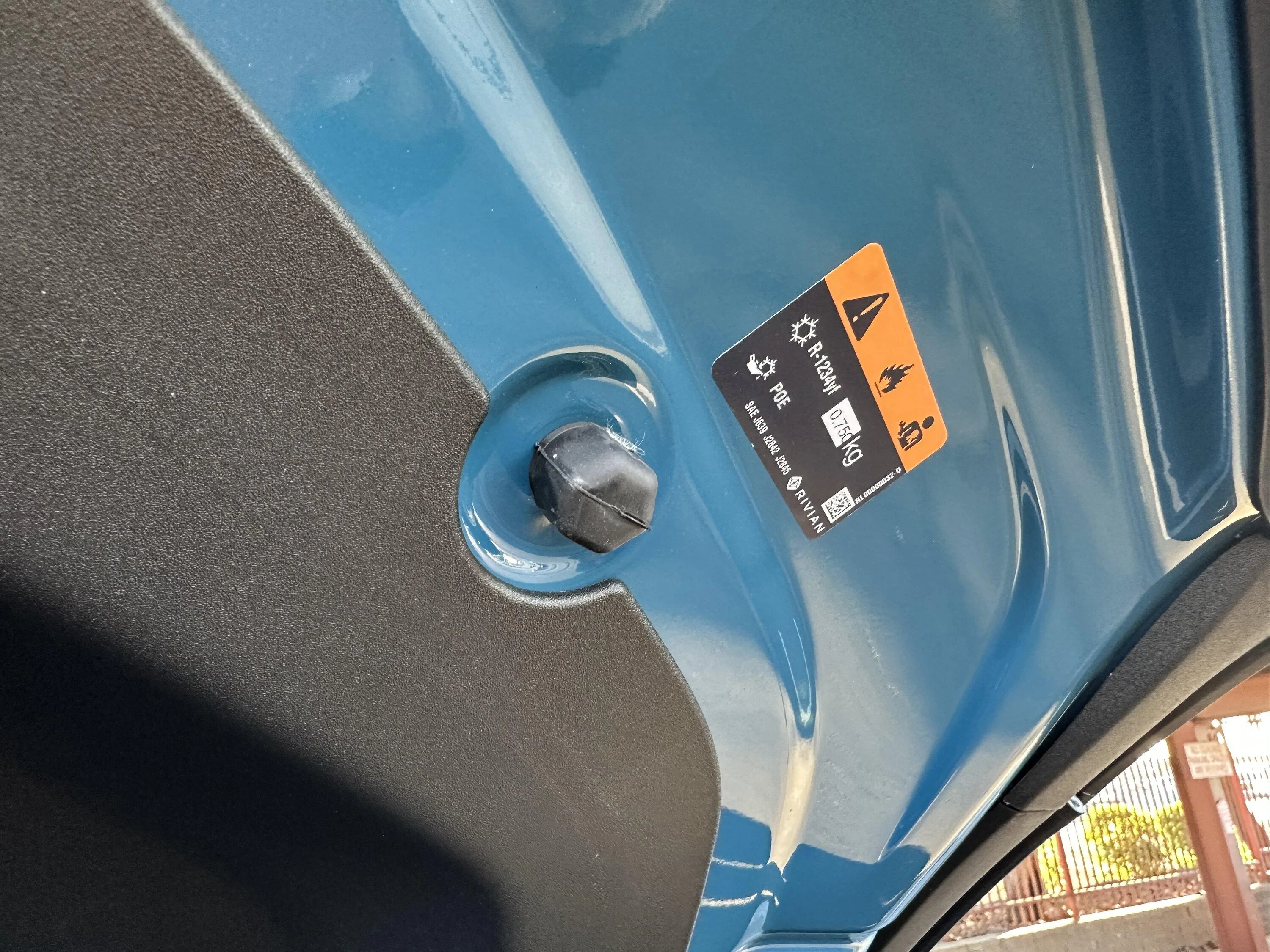

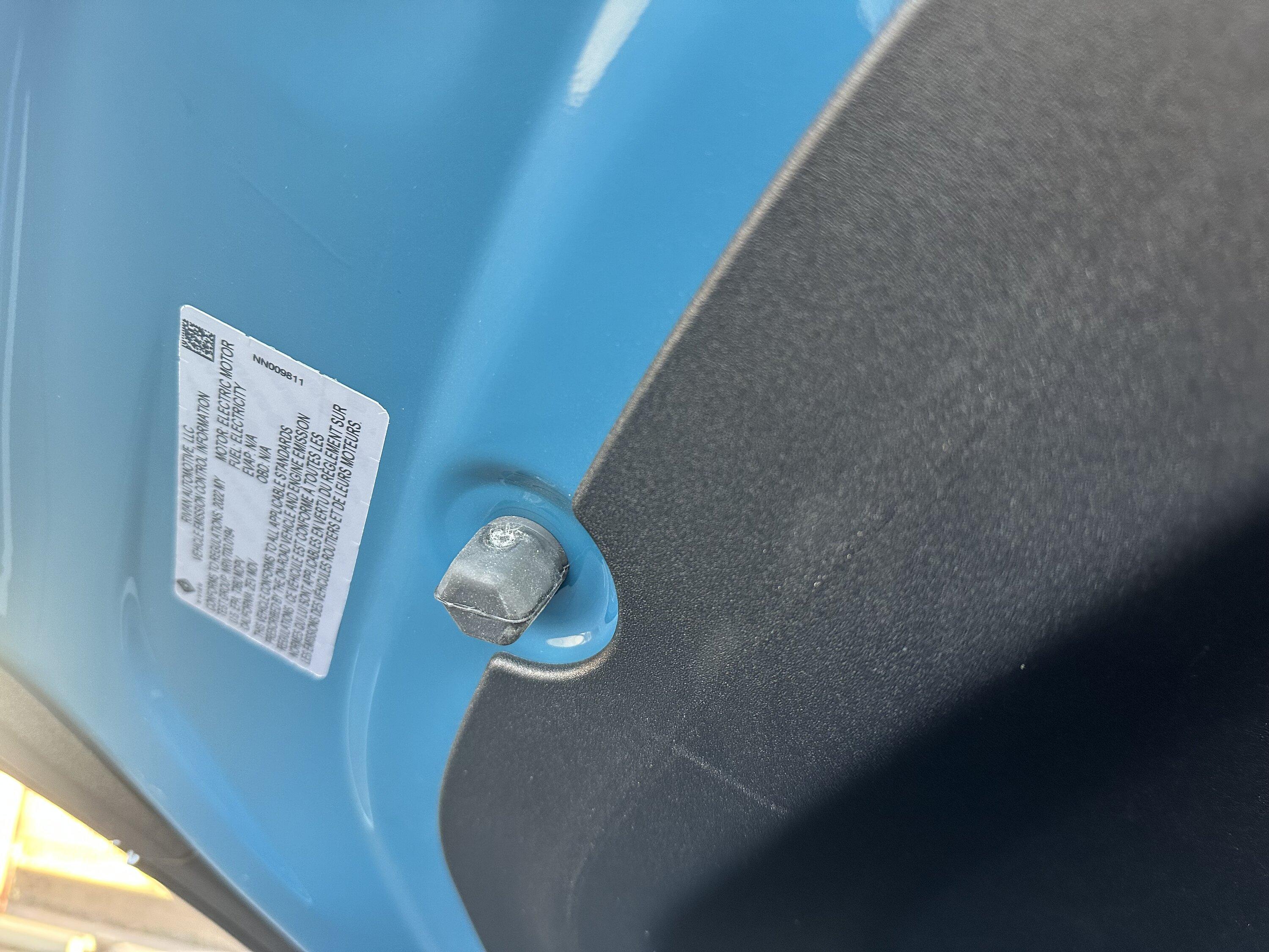

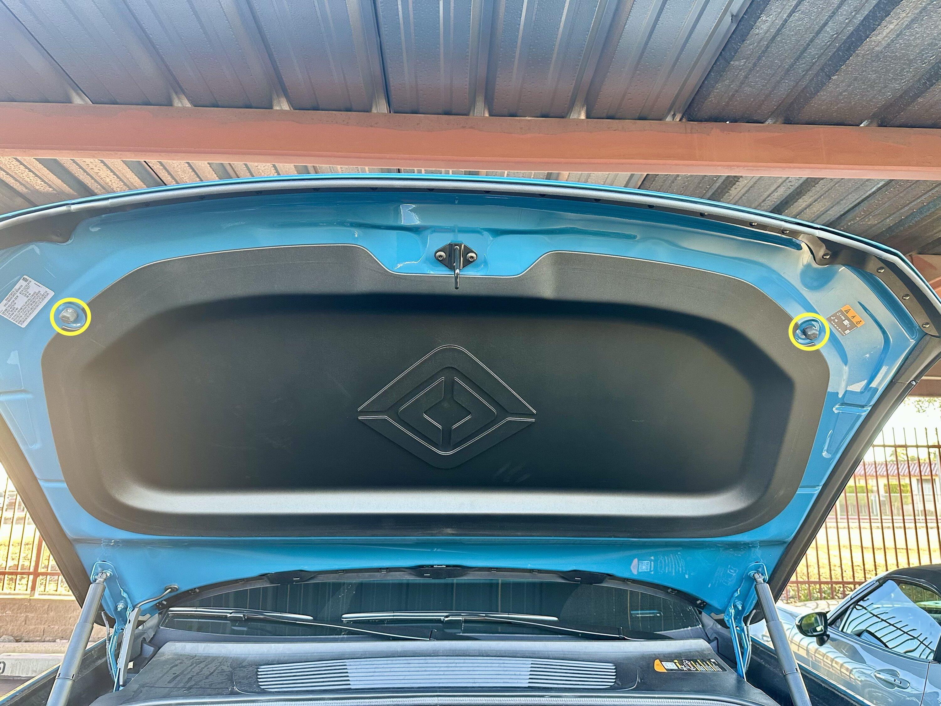

Have you tried just adjusting the latch length?
Funny you mentioned that. While I have no idea how to adjust the latch length, I did adjust the hood bumpers/bump stops or whatever they're called on the hood this morning for the first time. They are pictured below and circled in yellow on the overview photo.
I actually noticed the driver's side one was pretty secure, but the passenger side was sticking out significantly farther. I twisted it clockwise a few rotations until it stopped moving thereby shortening the length it sticks out. The hood should theoretically be able to close even tighter.
I have no idea if it made any difference, but I noticed every time I launched the app from my work office today, the vehicle was sleeping.
I may play around with things a bit and re-install the frunk liner piece and see what happens.

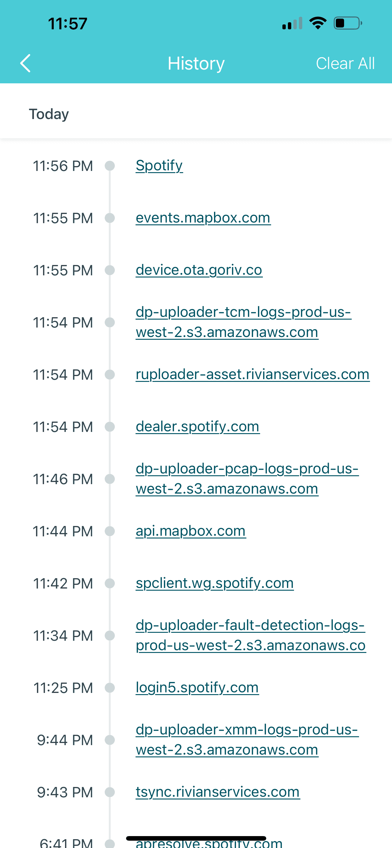

If you log out of Spotify, will it still be that chatty? It’s just so strange to reach out that frequently.
I was wondering the same thing. It would be interesting to know the sample rate of people who are experiencing vampire drain and use Spotify and vice versa. Or, as you said, log out of Spotify and see the results.
When I get my truck in a couple weeks it’ll be parked in subterranean parking completely isolated from any signals. I wonder how that would effect the vampire drain.
Most likely the patch will be out by then and this will be a nonissue anyway, but it’s interesting nonetheless.
