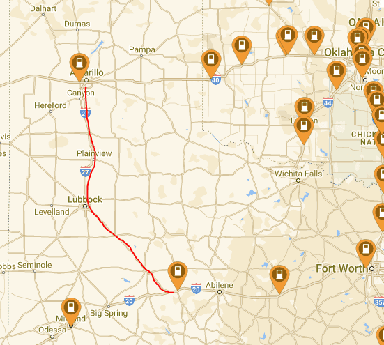

Well, just completed a trip from San Antonio, Texas to near Tucumcari, New Mexico. Rivian's map estimation is that I would not be able to make Sweetwater to Amarillo and ABRP also showed that I had to stop in Lubbock at a slow charger, but I soldiered on....as it is 240 miles and at 100% charge in Sweetwater, truck showed 293 mile range....so going 68 mph and in the second lowest setting and conserve mode, I arrived at the Amarillo Electrify America station with 82 miles remaining! Efficiency showed 3.15 miles per kwh on very flat terrain for a good stretch. :D (Loaner on AT tires, 3 passengers, 300-400 lbs of cargo, etc) The return trip with some wind, still had 58 miles remaining.
That's 318 Wh/mi which is appreciably less than the truck's rated consumption which is around 450 - 500. Thus you must have had a tail wind.
More than likely...it is very windy in that area...mostly flat plains....on the way back the wind came from the side, so 30 miles less pushing me around.

I'm glad to know this is possible. It certainly makes trips from Texas to New Mexico a lot more viable.
The key word here is "possible". OP was able to do it comfortably because he had tail wind sufficient to get his consumption down to 318 Wh/mi. Going in the opposite direction he'd have a headwind that would get his consumption up to around 700 Wh/mi and the story would be quite different.

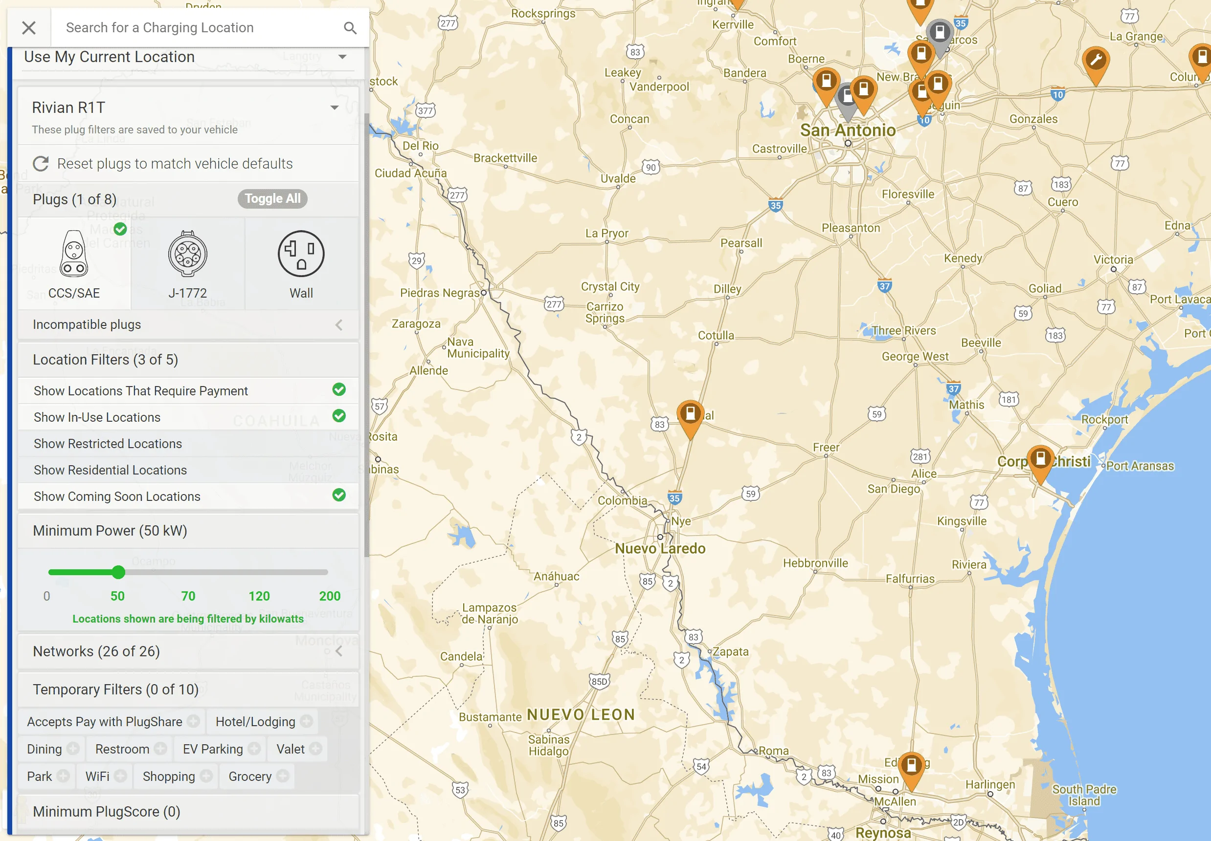

Another dead zone is in South Texas. Taking a trip to South Padre Island is painful with the current infrastructure:

DaveA
DaveA
Nov 17, 2020
1,915
3,407
All of those sites in New Mexico are going to be awesome. We need to invoke some state pride to shame us Texans into doing something similar.
Ooof....yeah, EA needs one in Brownsville and Corpus for sure.
