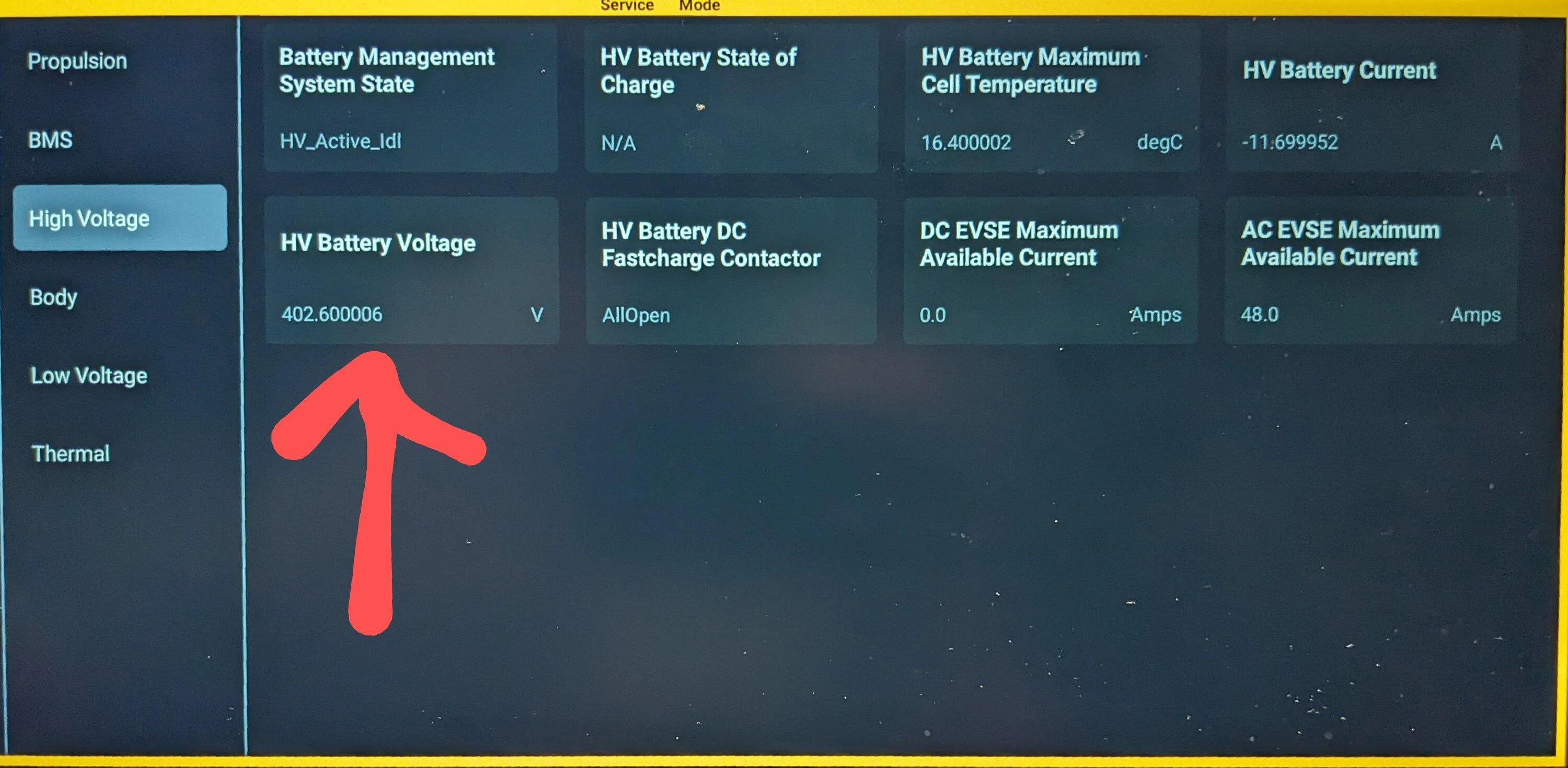

I think @OnePedaler's logic goes something like this:
(1) This loss of battery capacity is really strange.
(2) Maybe the Forum participants can tell me how to diagnose something I can fix myself.
(3) If it needs a Service Center visit anyway, then further DIY diagnostic steps don't matter much to me.
That's the logic I would use. I don't find @OnePedaler's posts frustrating at all. Sorry if others do.
There, have I mansplained it sufficiently? Can we all let @OnePedaler do her thing, and hope that her good experiences will attract other female Rivian owners to participate fully in our community?
Thanks to all!
NY_Rob
Feb 9, 2022
5,506
8,153
long island

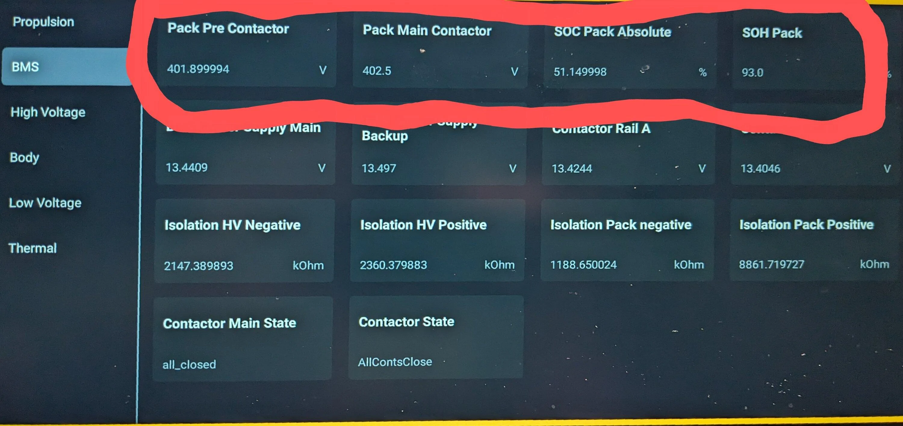

By what you have posted, it's likely that one or more of the battery modules have a capacity problem, but is still online so that explains the absence of warnings/codes thrown. If a module goes offline the vehicle throws all sorts of codes and goes in to limp mode. Hopefully that doesn't happen on your way to the Service Center and you are very fortunate that didn't happen when you were on your trip.

Definitely a service call. Does anybody have a wiring diagram for the battery? Sounds like approximately half of the battery is disconnected.

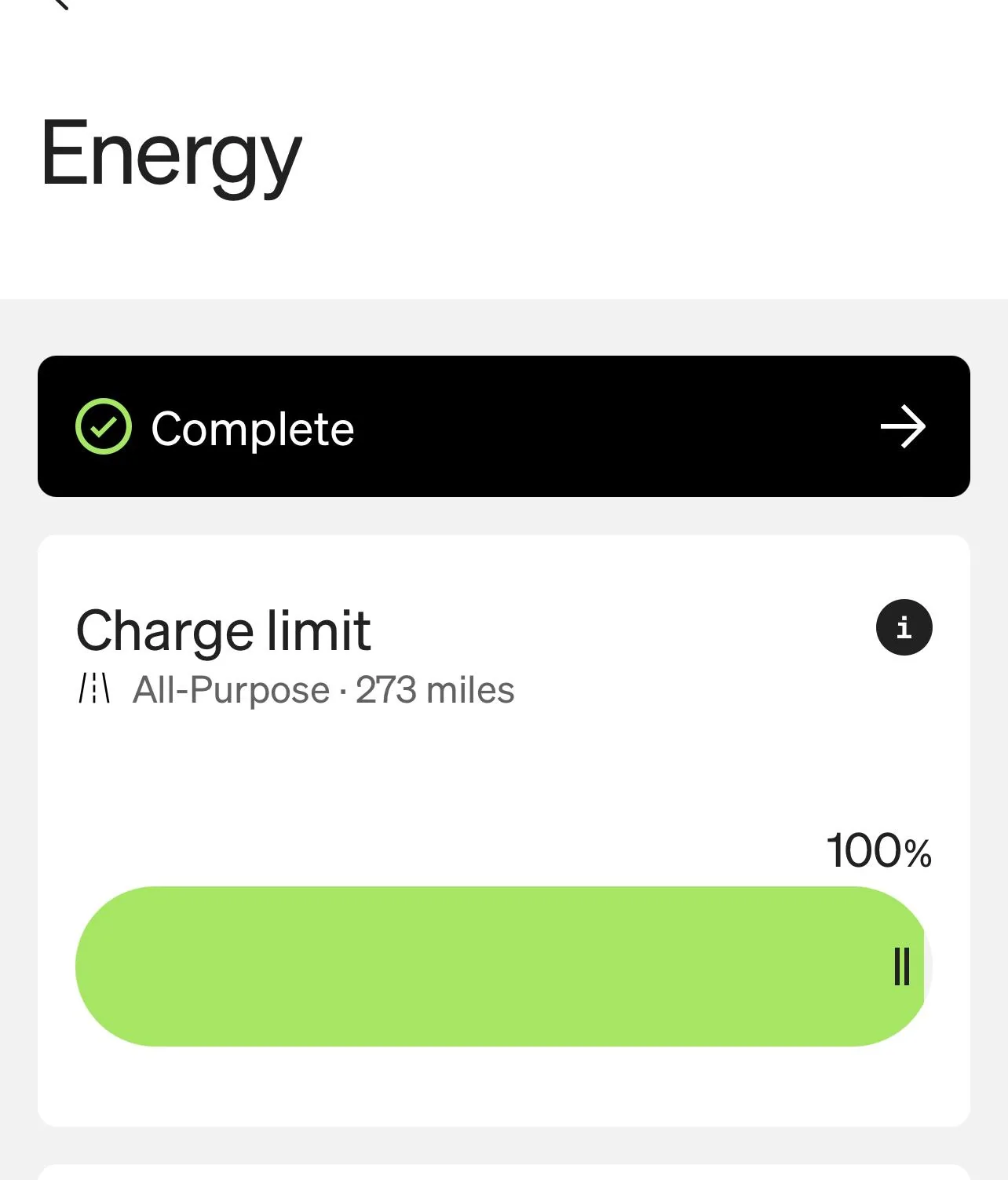

Update: Making progress but the repair isn’t done yet. Dropped off Tuesday. The SC confirmed the battery was the problem. The new battery arrived. Now being installed and synced with firmware and software. We hope to pick up Monday and will drill down with the tech to understand what the damage was and theories on why it occurred. Will share that info with you all. (We miss driving our R1S! Our rental is a Mazda CX-9 SUV)
OnePedaler
OnePedaler
Karen
Aug 25, 2023
117
Nemo
R1S, Ford Explorer
Final update: Repair complete. Took 9.7 hours of labor to replace battery and sync systems up with the new battery. Test drive by SC confirmed all is good. See attached Energy status and range of 273 miles (vs 150 miles) estimated for All Purpose Mode at 100%.
In shop from Tuesday to end of day Friday 3/8/24. We will pick up today. The battery was sent to a Rivian location to do forensic work on what went wrong. The SC manager told us that Rivian does not reveal results of that investigation as it’s considered proprietary information. Disappointed not to be able to know more and share with you all!
We look forward to our road trip from Ohio to SD with a full capacity battery (and at least one Waffle House stop along the way).
