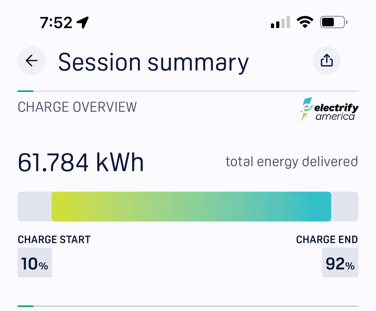

Here’s a screenshot from one charge on our trip. Gives a good idea of battery capacity but from 10% to 92% fill . 62 kw added. So we estimate from this 75 kw battery capacity.

Our battery capacity has dropped in half as measure in miles at full charge in all drive modes on our R1S. Purchased in Aug 2023. Last 5 numbers of VIN 13736. Large Pack battery. Quad motor. So battery capacity is nominally 125 kw. We have all recent vehicle updates complete.
We noticed the problem since about Feb 10 in around town driving. We had to home charge each night instead of every couple days.
Now we are on a road trip with good weather (50-70 degree F), no wind and pretty flat on Interstate 90 from SD to IL. Going 65 mph. After 810 miles of driving our Trip A records 2.23 mi/kw in Conserve mode. This should translate to around 275 miles of full battery range (which we have achieved in similar conditions on past trips).
But, we get only 150 miles when we charge the battery to full amount. We switched to All Purpose for about 50 miles and didn’t see any difference. So we are stopping every 120 miles to charge up to 70-85% which gives us only around 125 miles range.
We called Service and tried to reset History on Energy screen tab, soft reset, hard reset and sleep cycle of 5 hours. Still have the problem. We do have an appointment with Cincinnati Service Centwr on March 5.
So basically getting good efficiency but limited range. Any help or suggestions our there??
