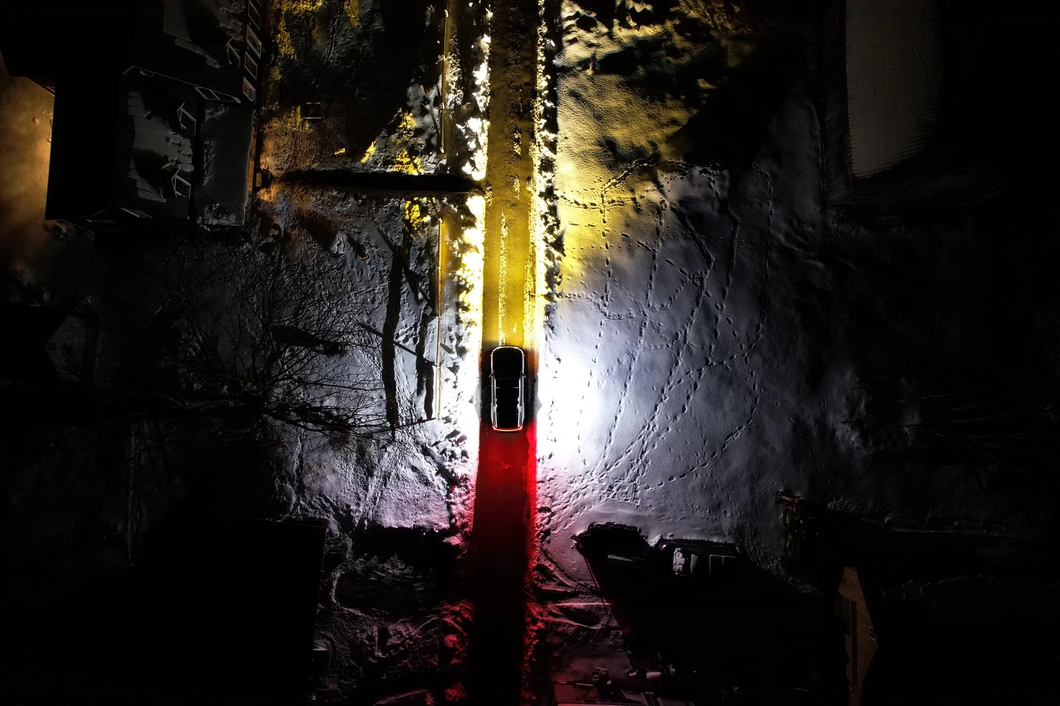

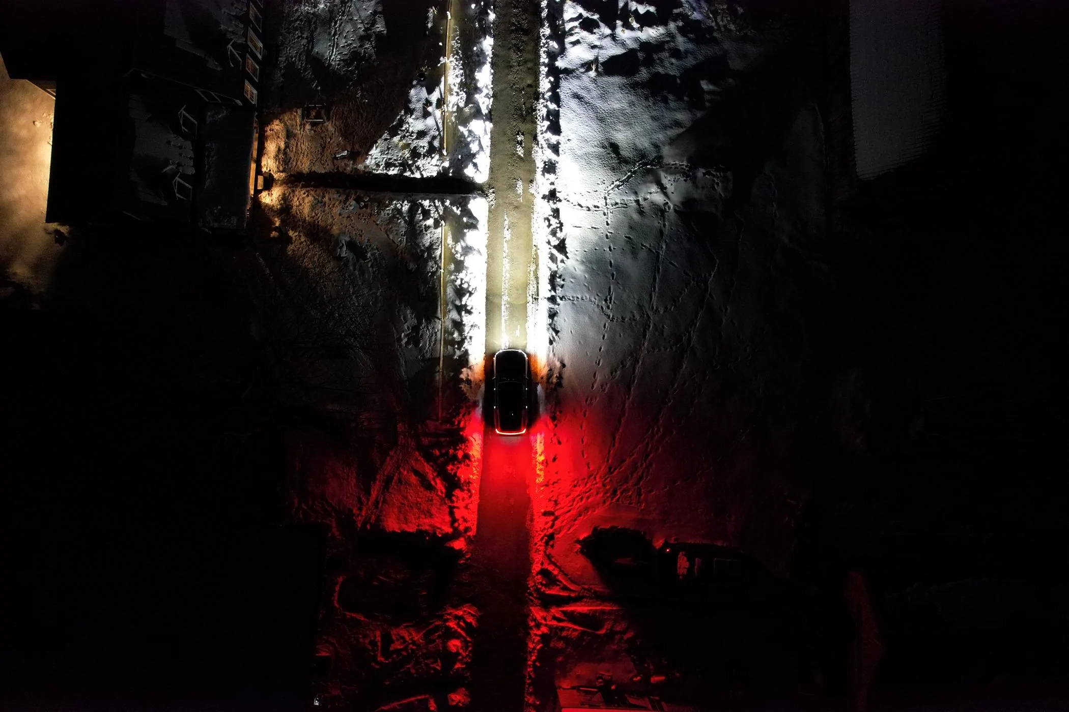

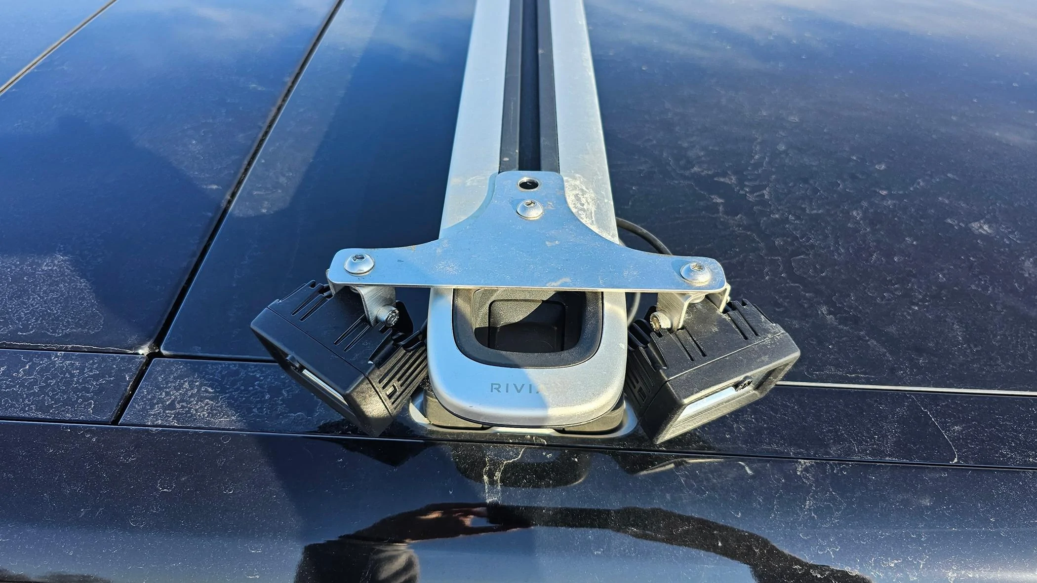

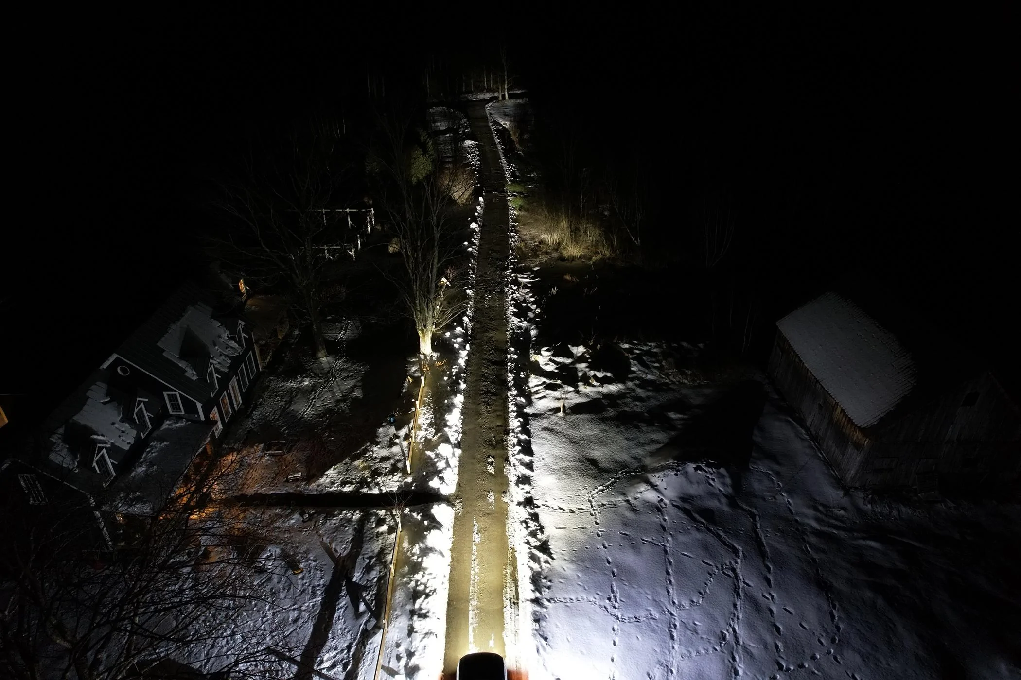

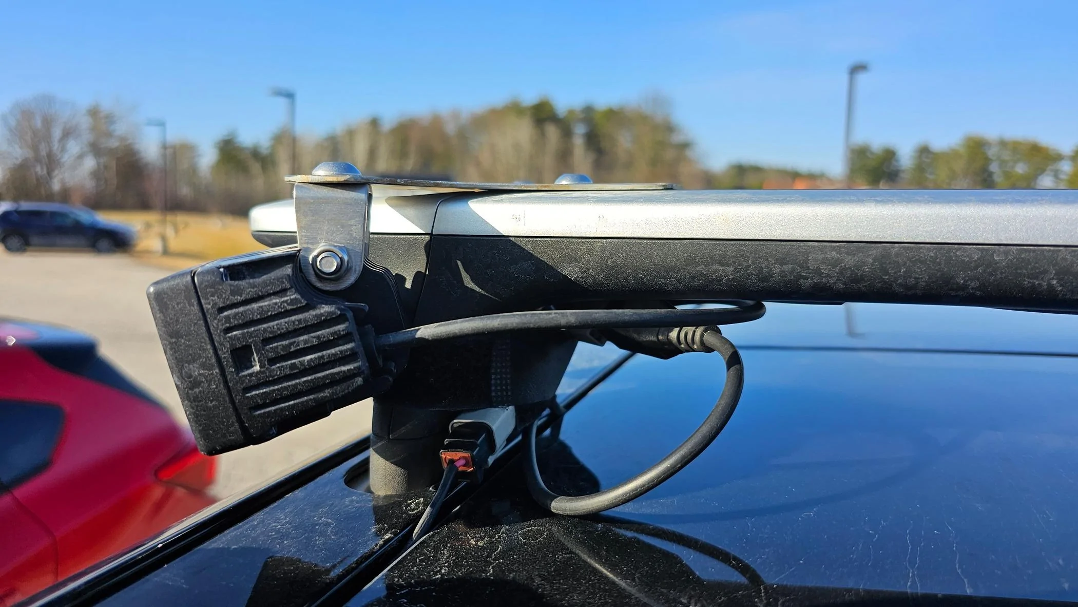

They work great! Here are some overhead shots of vehicle:
1. High Beams
2. High beams + critter lights
3. Highs + Morimoto Fogs + critter lights
We call them that because they let us spot the critters that just crossed the road and are no longer in the headlights!
Also included a couple pics of the brackets to hold two floods per side.
Rivian R1T R1S Stowable 40" Light Bar Setup Rivian Overhead no side lights
Rivian R1T R1S Stowable 40" Light Bar Setup Rivian Overhead High+Sides
Rivian R1T R1S Stowable 40" Light Bar Setup Rivian Overhead Fog+Sides
Rivian R1T R1S Stowable 40" Light Bar Setup 20240313_164129
Rivian R1T R1S Stowable 40" Light Bar Setup 20240313_164137

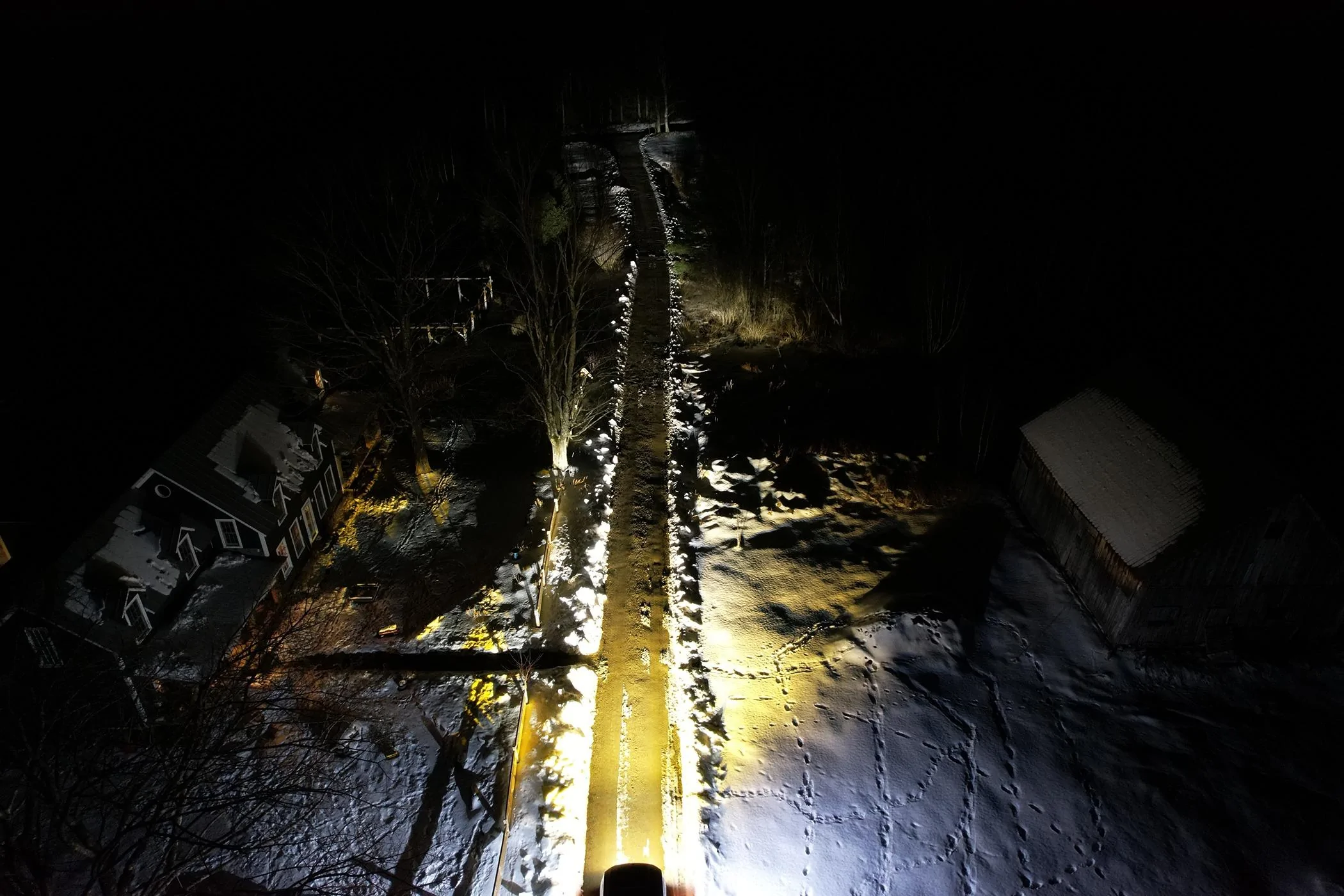

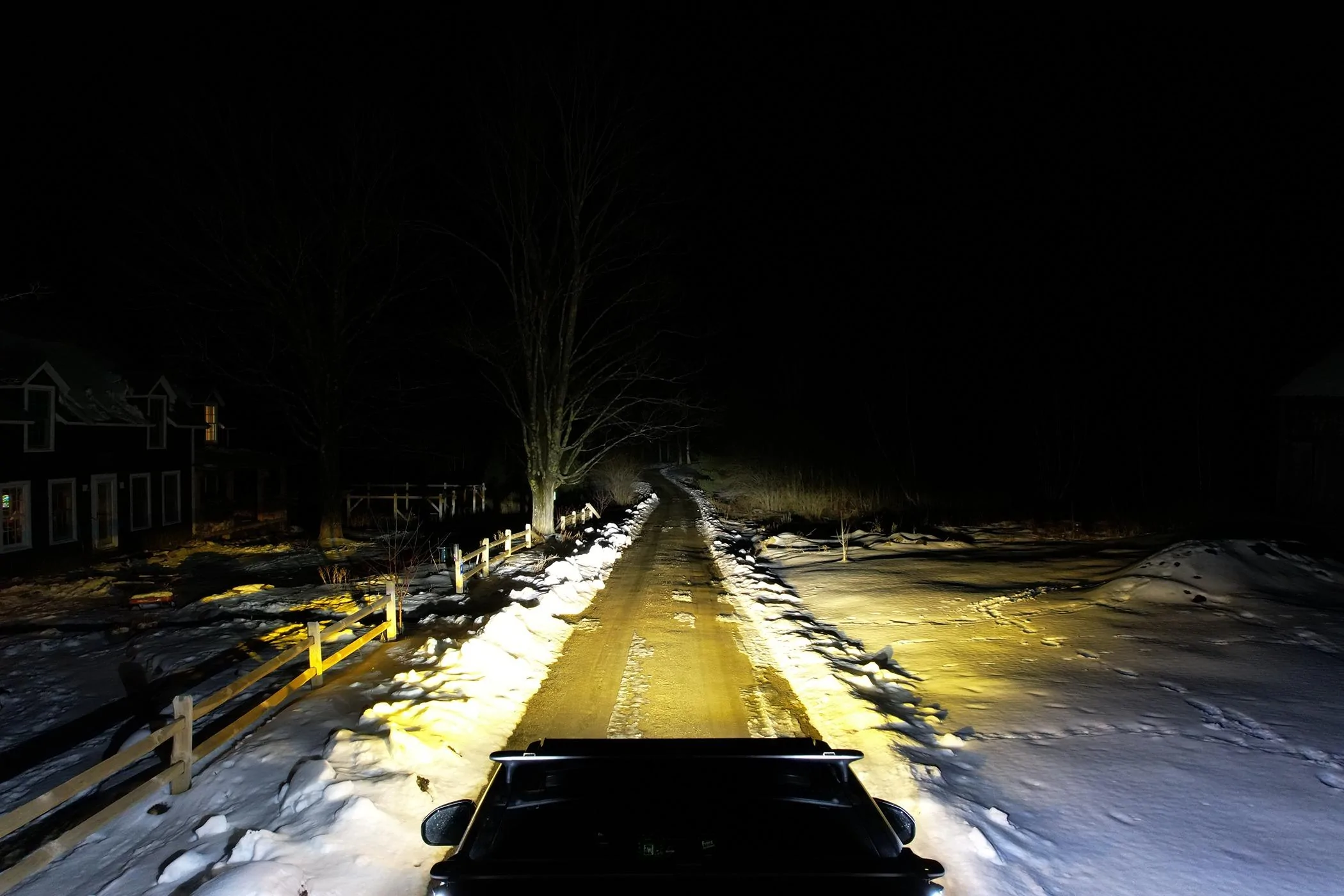

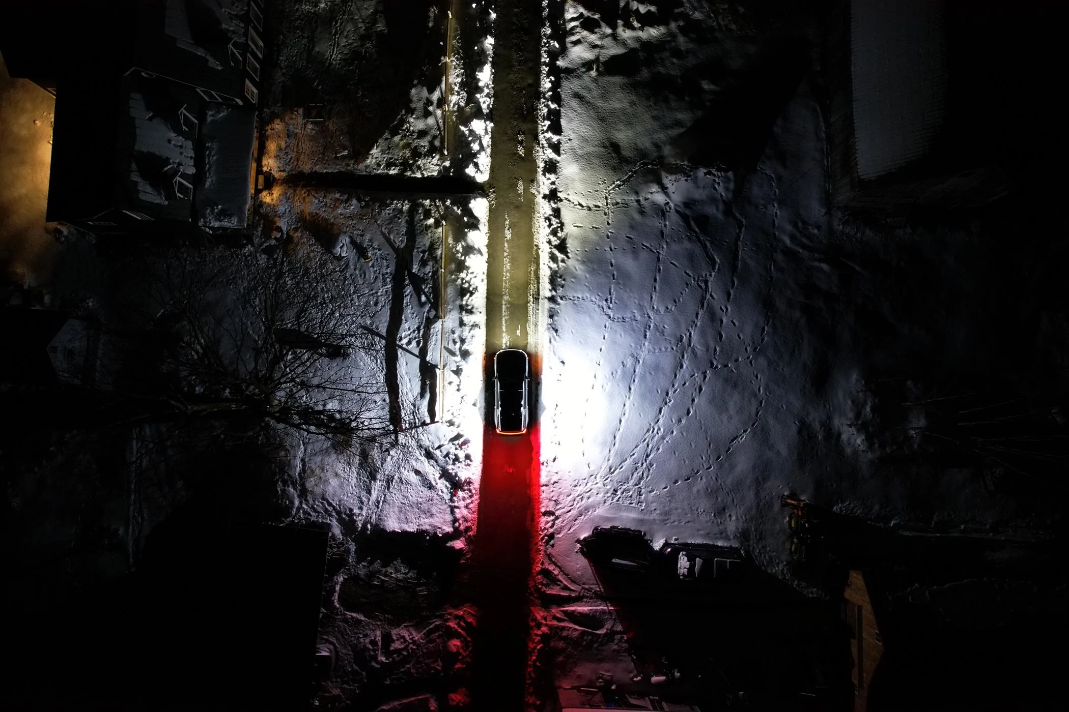

And here are a couple overhead shots with and without the light bar.
1. High beams
2. High beams + Morimoto Fogs
3. High beams + Fogs + 40" bar
And lower angle of Highs vs with the bar
Rivian R1T R1S Stowable 40" Light Bar Setup Rivian Overhead Forward High
Rivian R1T R1S Stowable 40" Light Bar Setup Rivian Overhead Forward High+Fog
Rivian R1T R1S Stowable 40" Light Bar Setup Rivian Overhead Forward High+Fog+Bar
Rivian R1T R1S Stowable 40" Light Bar Setup Rivian Forward High+Fog
Rivian R1T R1S Stowable 40" Light Bar Setup Rivian Forward High+Fog+Bar

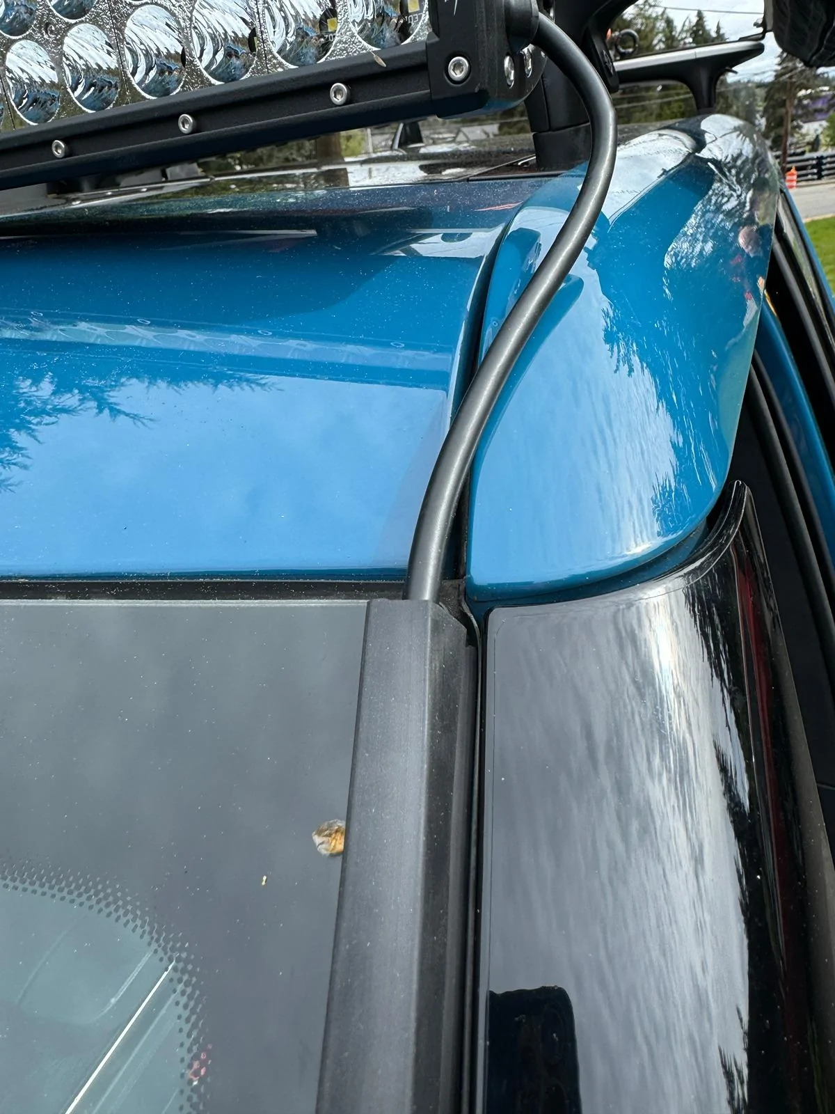

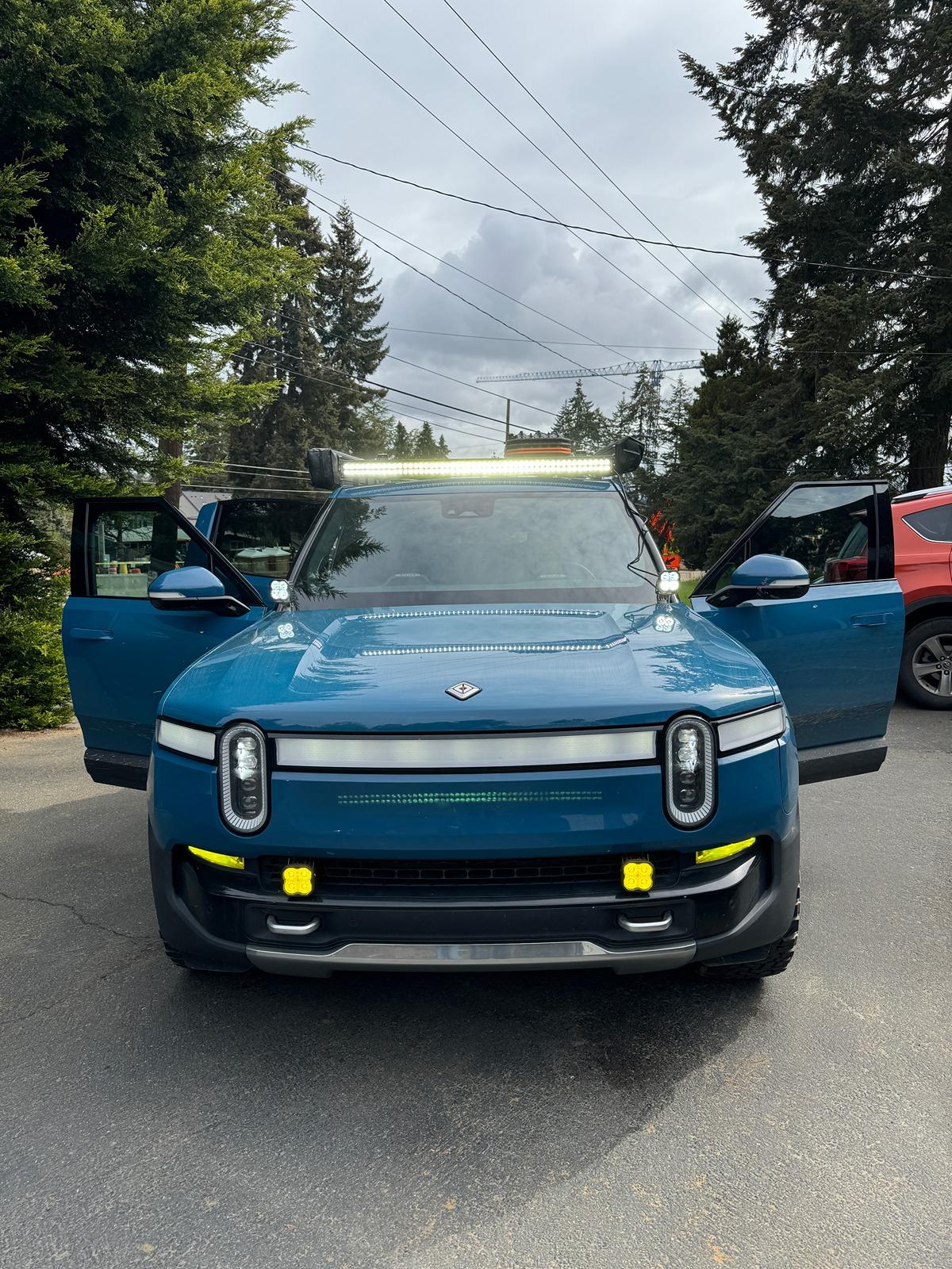

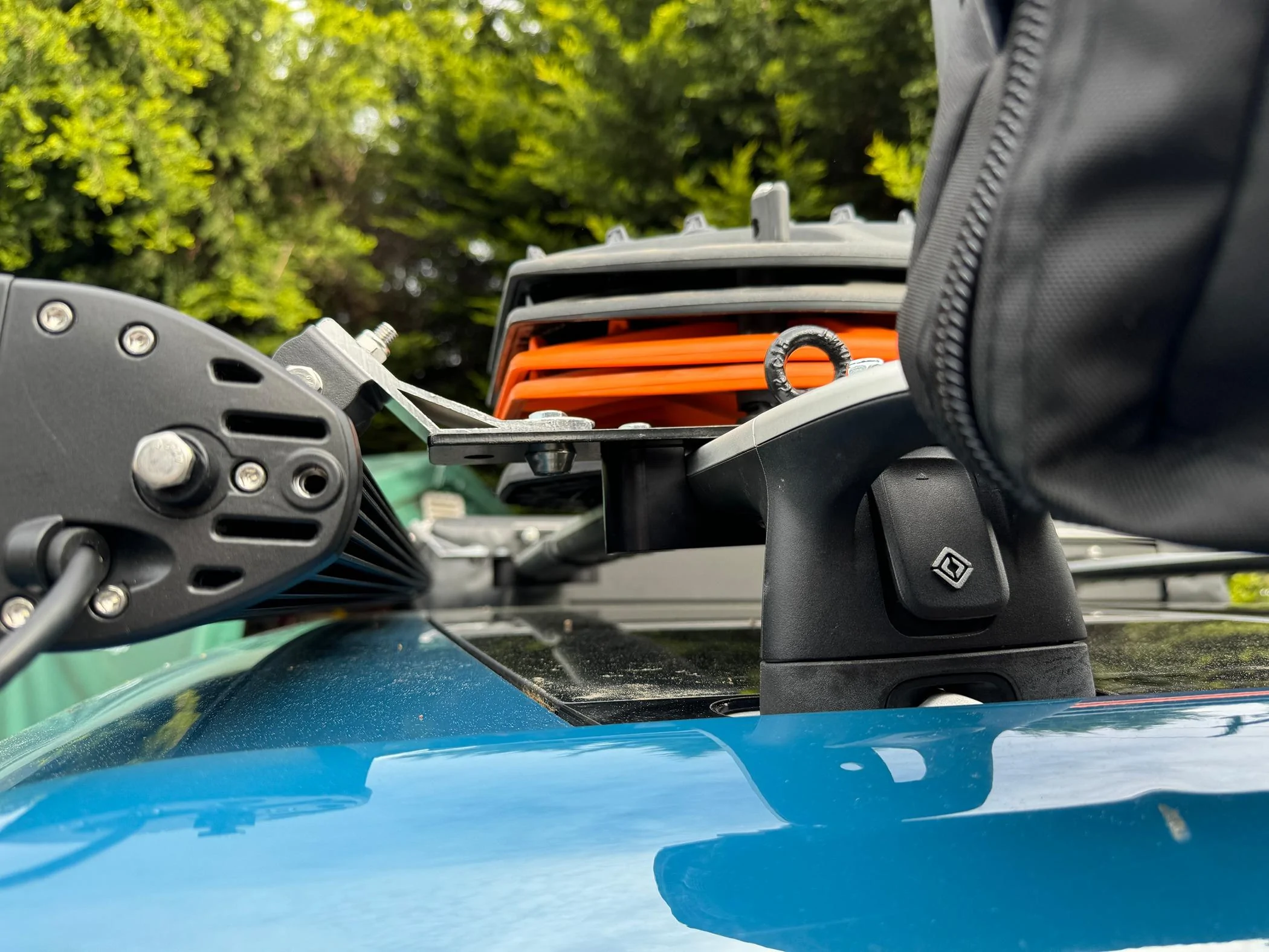

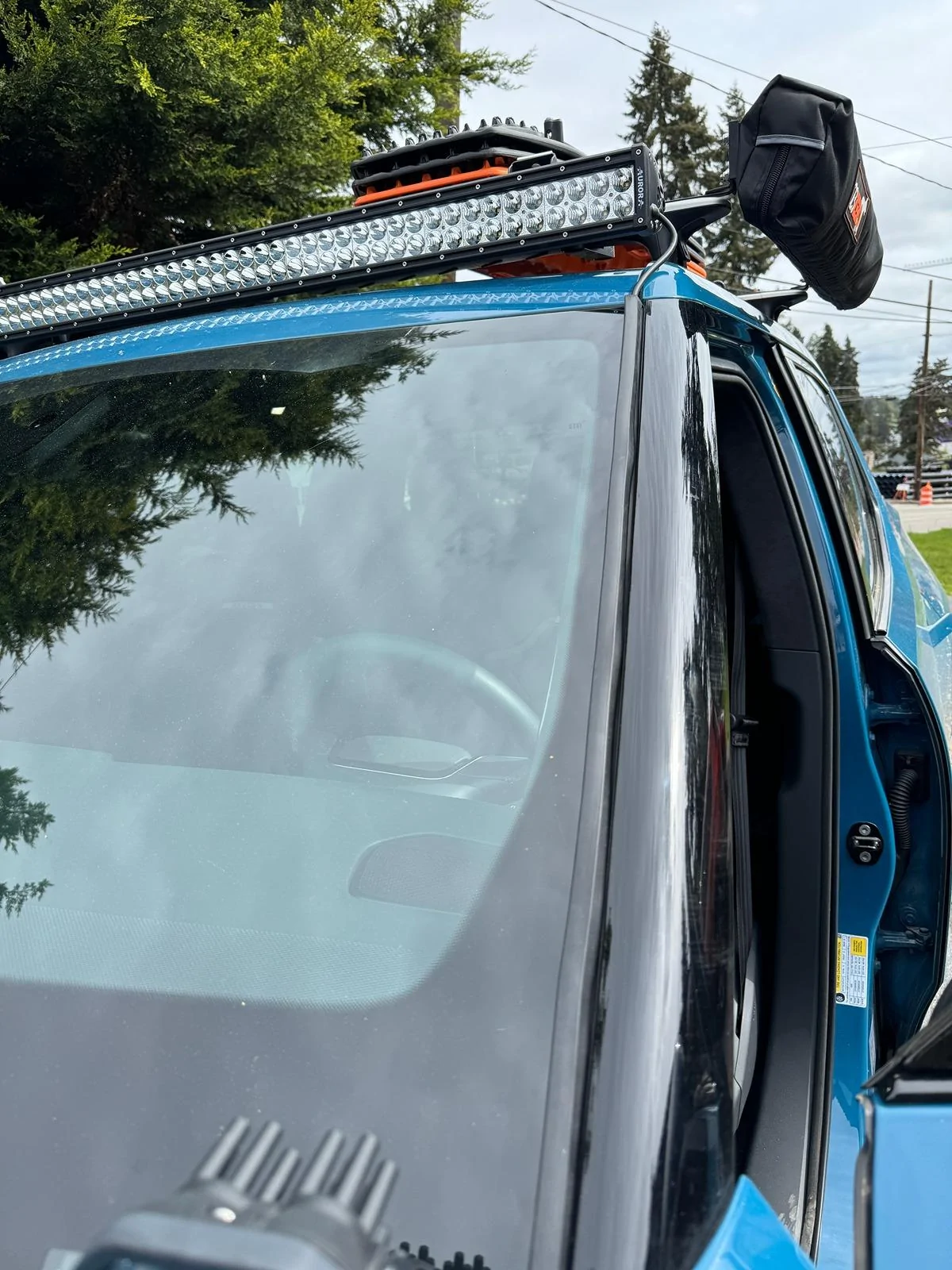

@Riptonite this thread inspired me to finally make a contraption to mount my 50" lightbar.
I just love the modularity of the Rivian! I can have a "roof rack" with 2 crossbars that mount my awning, shower tent, maxtraxx and now a 50" lightbar and I can unplug the lightbar and 5 min later the truck is back to stock.
I used some scrap steel plate, some 120 degree mounts from amazon and these brackets, which I also used to mount my iKamper 3.0 mini:
https://www.wheeleveryweekend.com/products/rtt-security-mounts?variant=44245427749142
The wire runs through a rubber channel, also from amazon:
https://www.amazon.com/gp/product/B093HJJ36F/ref=ppx_yo_dt_b_search_asin_title?ie=UTF8&psc=1
Rivian R1T R1S Stowable 40" Light Bar Setup IMG_0319
Rivian R1T R1S Stowable 40" Light Bar Setup IMG_0318
Rivian R1T R1S Stowable 40" Light Bar Setup IMG_0320
