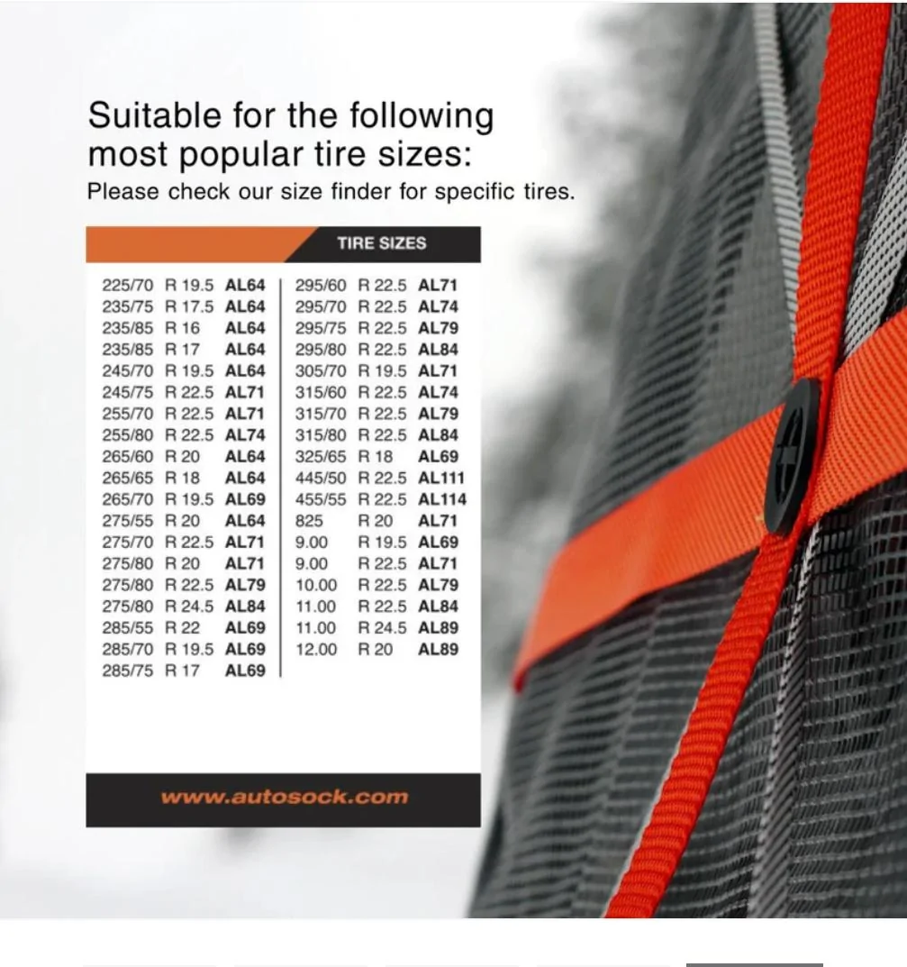

confused, i dont see 275/65/R20 explicitly listed but youre saying size AL69 will work?
I just used the Size Finder tool on the website. Each sock fits a range of tire sizes. There isn’t a unique AutoSock for each unique tire size
Apparently, 275/65/R20 is not a ‘popular tire size’, so you have to use the Size Finder

On 20" ATs, got the Autosocks AL69 but will probably never use them. But they satisfy the legal requirements in CO if extreme traction law ever went into effect. The Pirellis seem great in fresh snow so far, I'm not sure the socks would be better in a blizzard situation.

I don't believe the AL69 will fit the 2756520. Have you tried to put them on? Thanks..
Funny, just tried today, and I'd say they were just a little bit loose. But no issues staying on after driving a mile or two. Incredibly easy to take on and off.
