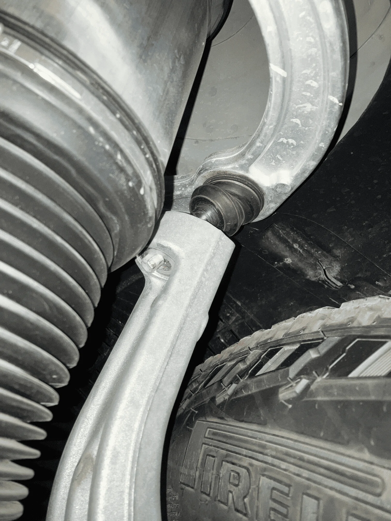

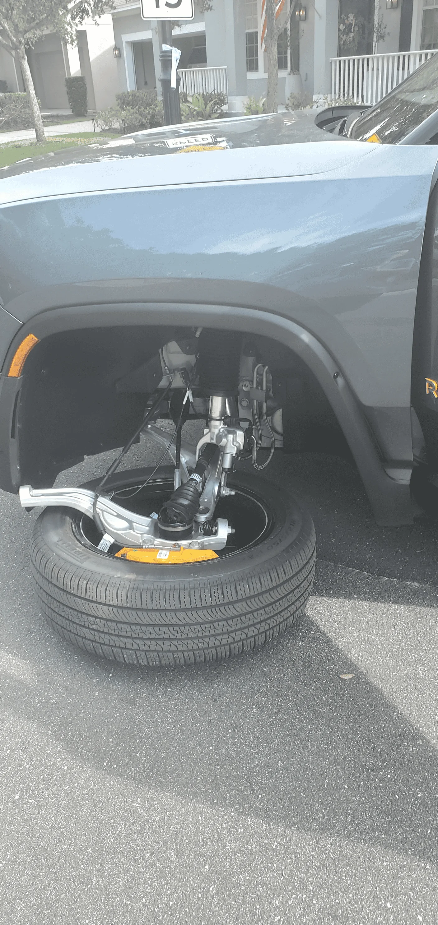

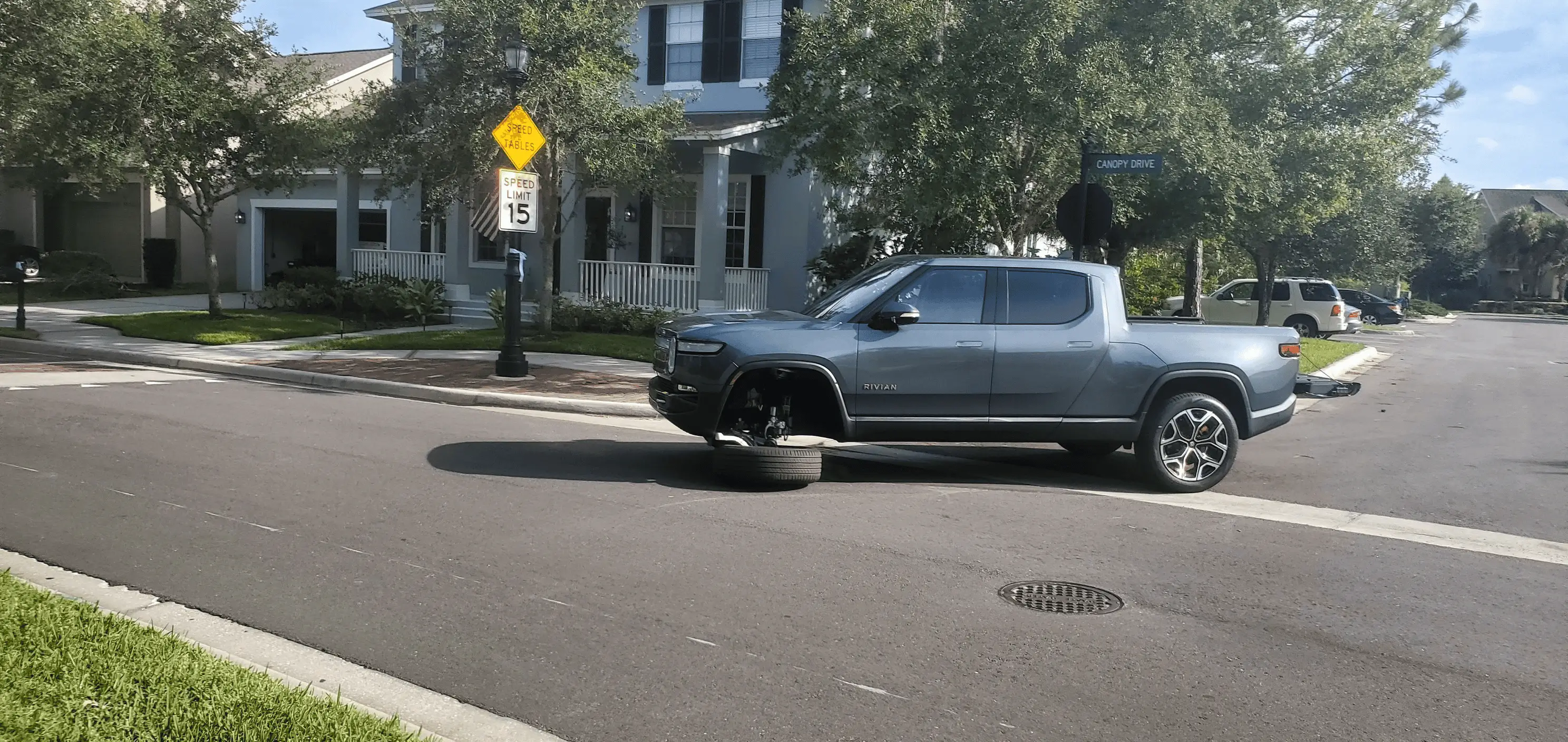

Is this upper ball joint failure?
Definitely some sort of catastrophic upper ball joint failure. The CV axle joint was destroyed in the process. This looks like a part supplier fault as the way these are assembled is for vehicle weight to seat the ball joint, not to separate. It seems the recent industry-wide auto parts quality issues may be at work here. We’ll see upon investigation.
