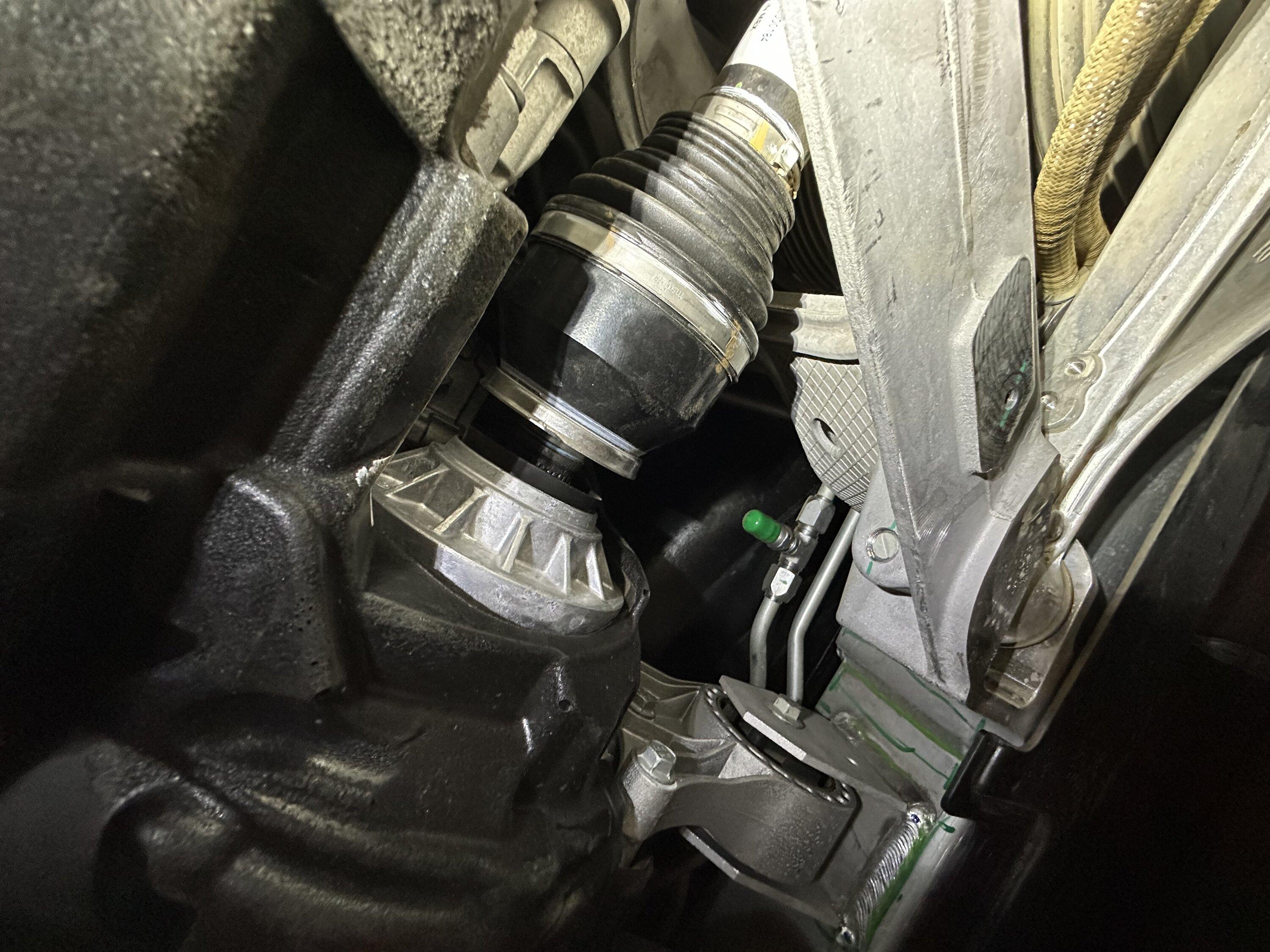

So this is what happened with my rear driver side shaft. Spline pulled out of the disconnect and stripped the splines on the shaft and disconnect and apparently the hub side as well. Sc replaced all three. It would make a rhythmic clunking occasionally. When it finally stripped, there was a spline grinding noise and I got the turtle mode with rear motors unavailable error.
Just had this happen on my R1S.
