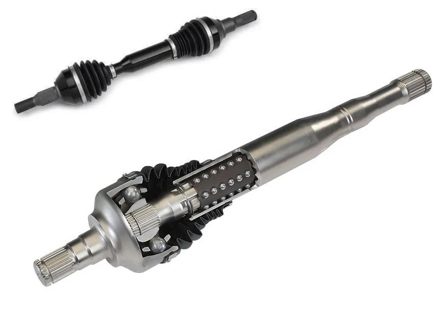

I suspect that Rivian's front driveshafts incorporate a ball spline (to accommodate the extreme "plunge" motion of the R1 suspension). I noticed in the OP's video that the driveshaft diameter is larger inboard than outboard. If my suspicion is true, then Rivian's driveshafts are different from the garden-variety front-wheel-drive driveshafts which typically incorporate an inboard tripod joint to accommodate plunge.
I found a couple images to illustrate ball spline driveshafts. Top image is a Chevrolet Performance aftermarket driveshaft for the ZR2 Colorado ($4700 for a pair). The bottom image is a cutaway from a GKN Automotive website.
The movement that the OP demonstrated in his video may or may not be normal for ball spline driveshafts. I'm not an expert. I'm just a farmer, and I know just enough to be controversial.

I didn’t watch the video but if you are moving the shaft in and out on the inner joint this is normal. The outer joints are typically fixed and the balls/cage are held in place with a snap ring or c-clip inside the boot. The inner joint is a different design called a stroking joint and as the suspension arcs through it’s range of movement the inner joint has the ability to allow the CV shaft to move in and out over a small range. This is normal. On some more severe articulation cases there is often a sliding splined shaft (usually with ball bearings but sometimes just splined against a splined mate). The Rivian could be different design but this is the typical setup.
The problem demonstrated in the video is radial play, not axial.
