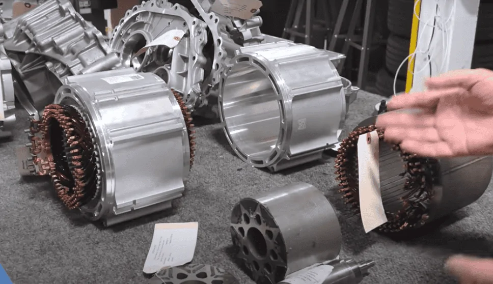

The quad uses Bosch motors. The picture below shows a disassemble motor, actually 2 motors. The component in the bottom is the rotor. It is assembled within the stator housing, the center-left aluminum piece. It contains the stator winding and the rotor. As you can see by the size of Sandy's hand, it's not really very big.
I have noticed this just a bit also. I think the my motor whine is slightly louder now than it was 9,000 miles ago, but it does not bother me at all. It could be temperature related, although the it does not seem to get quieter as the motors heat up.
