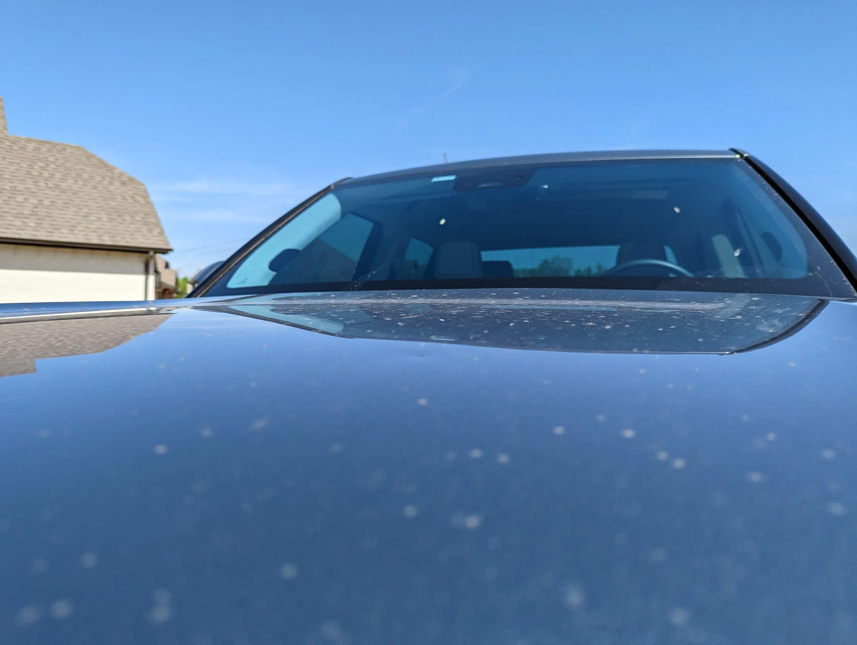

Mine picked up 2 hood dents from quarter sized hail in Oklahoma yesterday. That sheet metal is thin.

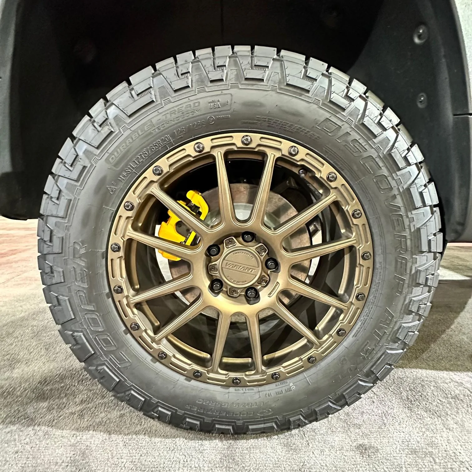

60 psi….lol
Not sure why there is an lol here ? They are rated to 80psi just like my Coopers (pictured). Nittos in OP truck look excellent!
I run my 80psi rated Coopers at 60-65 psi daily for 8,000 miles. Load range E tires, are 'designed' for the higher pressure applications because of the load possibilities the tires can operate in. I have unmeasurable loss of range running at this range and my ride is comfy and wear is 'better' than the 20 AT's from the factory.
I'm going to try 70psi in my next range test track run next week....Load range E tires are a great addition to our possibilities.
Typically you don't see damage until you have 1" hail...which is basically the diameter of a quarter, so no unexpected.

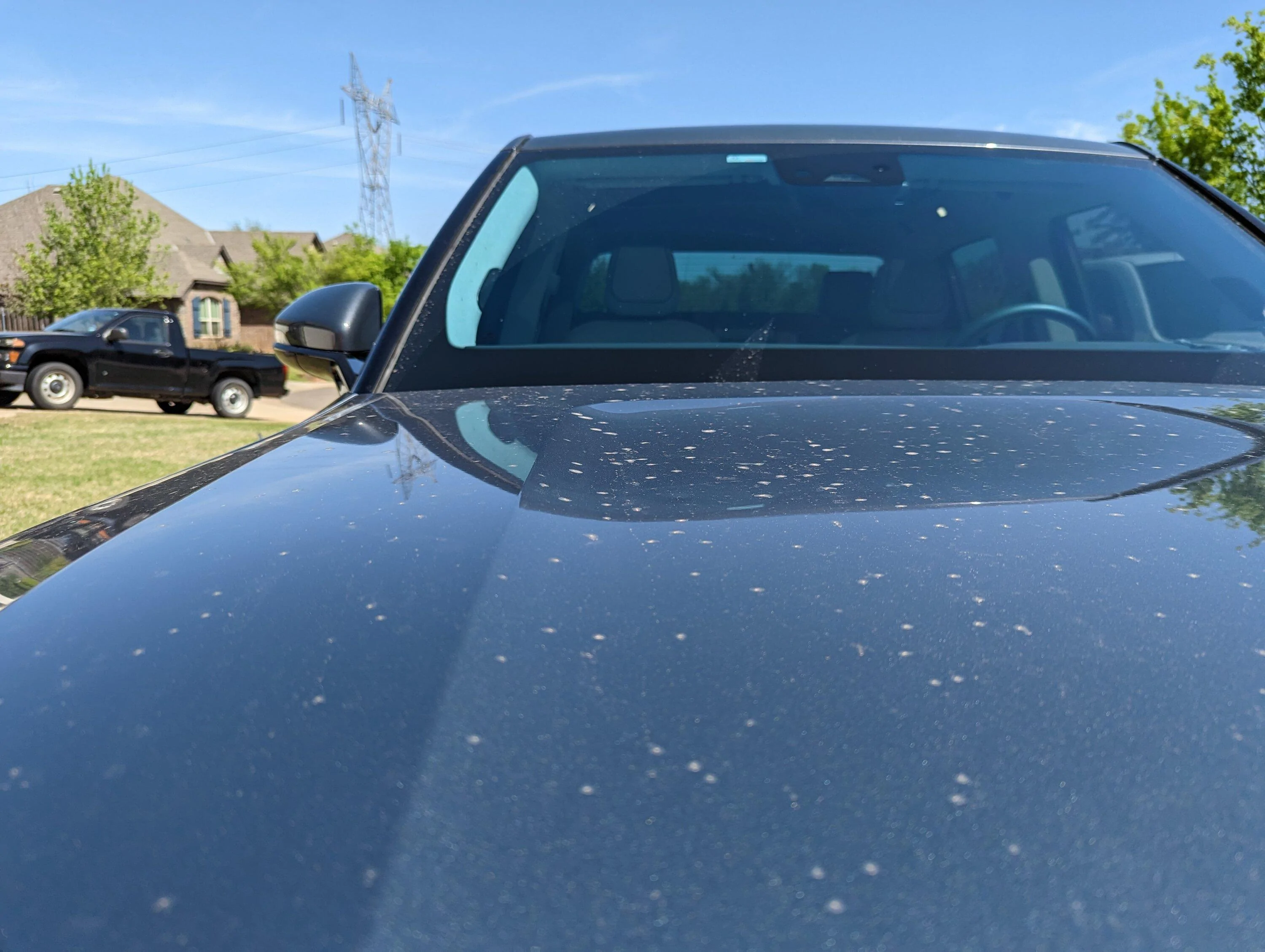

My f150 was considerably more resilient. But this far hail resistance is the only thing at which it was superior. Other than the range of course.
Haven't washed it yet, but you can barely see them.

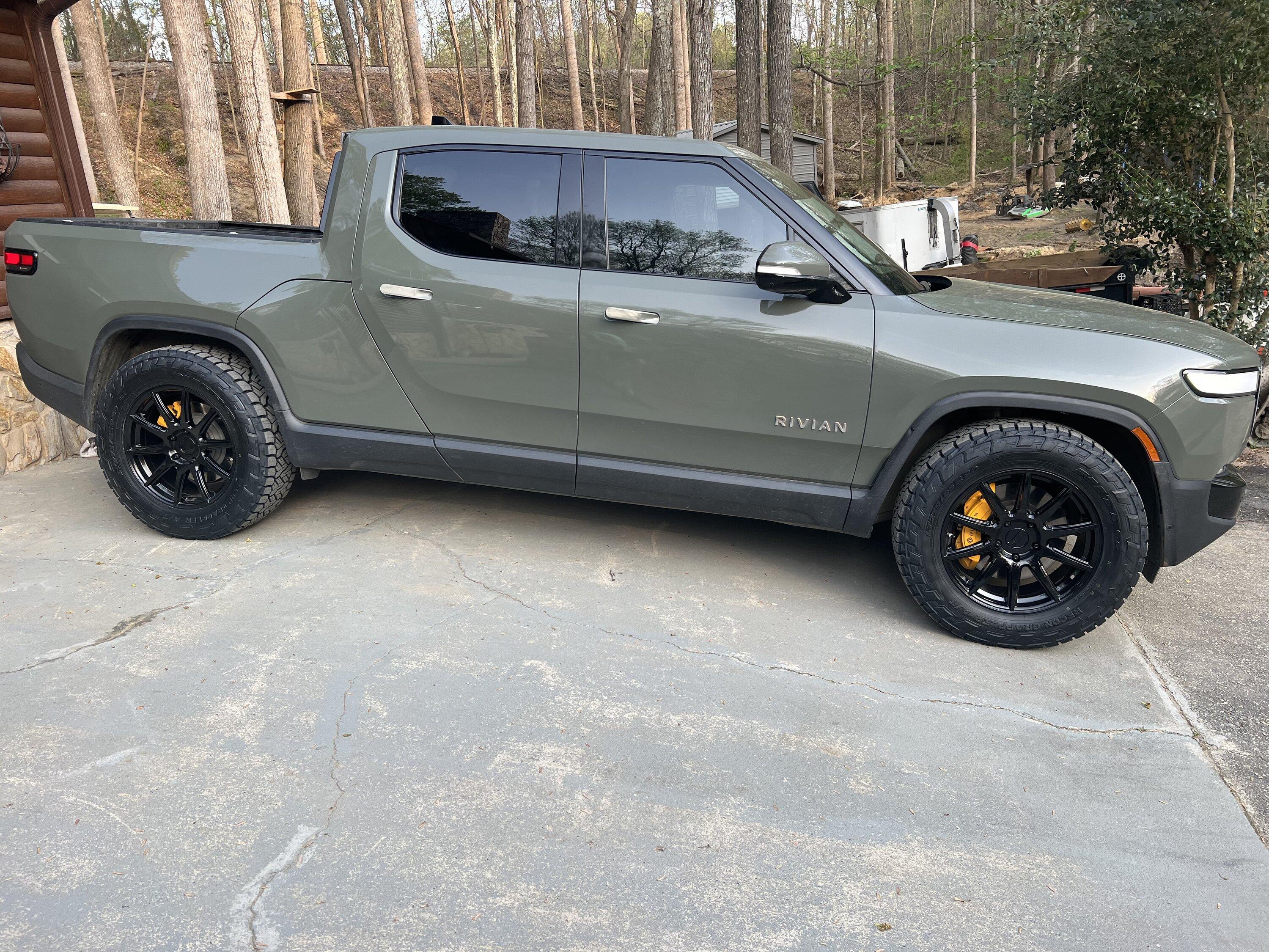

Got some new tires on my ATs today. Nitto Recon Grappler LT 275/65/R20. Currently running them at 60psi.
To get the obvious questions out of the way. They do have a bit more road noise but I was running the 21s before this but I think they are louder than the Pirelli ATs. No idea on the efficiency loss yet.

I got the same tires with aftermarket Raceline 20” rims and sold my 21” with old perellis on eBay 1200$ im happy with new tire set up but in sports mode they do rub tire well when hitting bumps 🤨
That's odd, did you get the OEM 275/65/R20. Other than tread depth they are identically sized at least according to literature. Are you talking about sport mode in lowest suspension? I've heard of that happening to peeps on the OEM Pirellis but never happened to me (with the exception of when my suspension was broken)
Looking sharp though, I like those rims.
Thanks my tire size is- LT 275/60R20

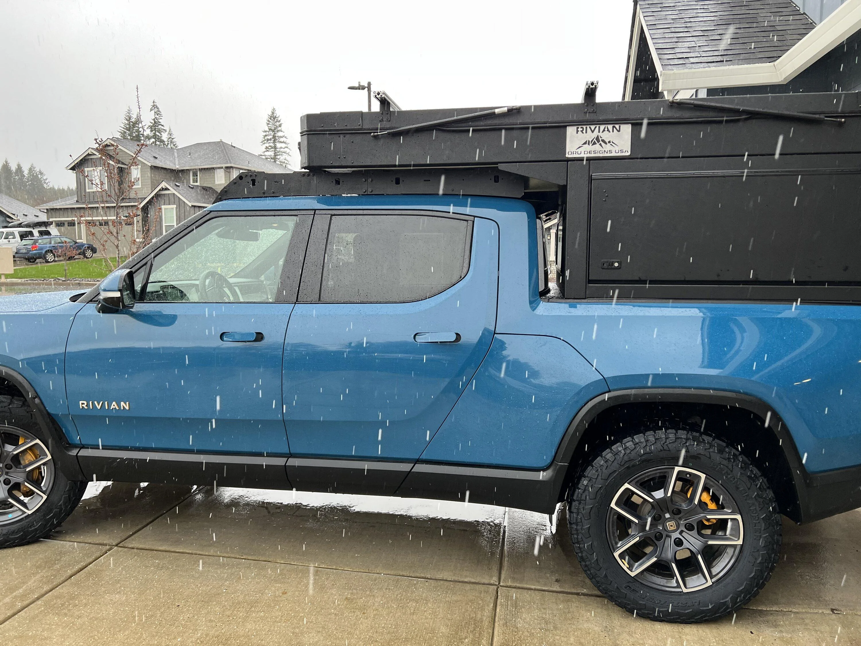

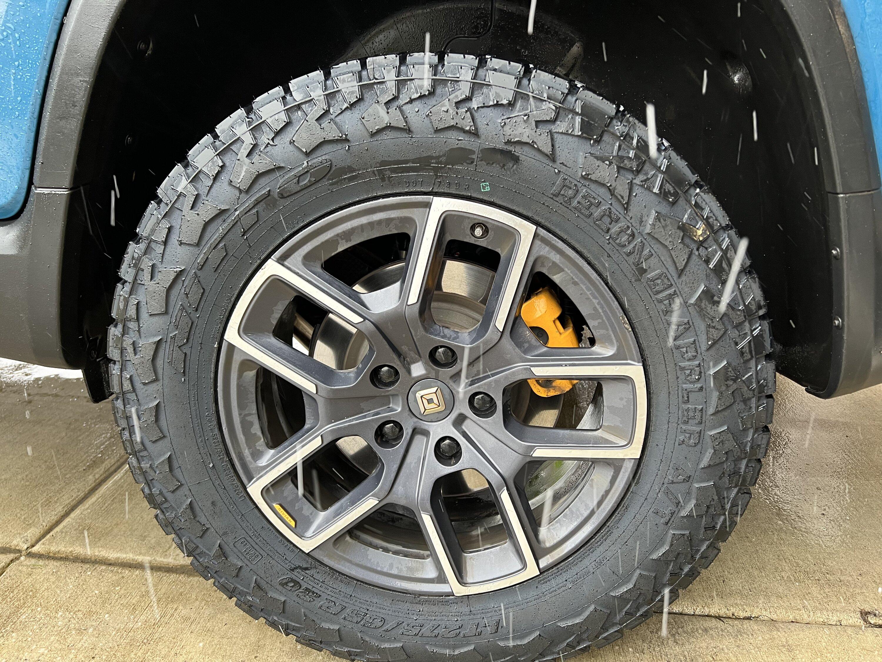

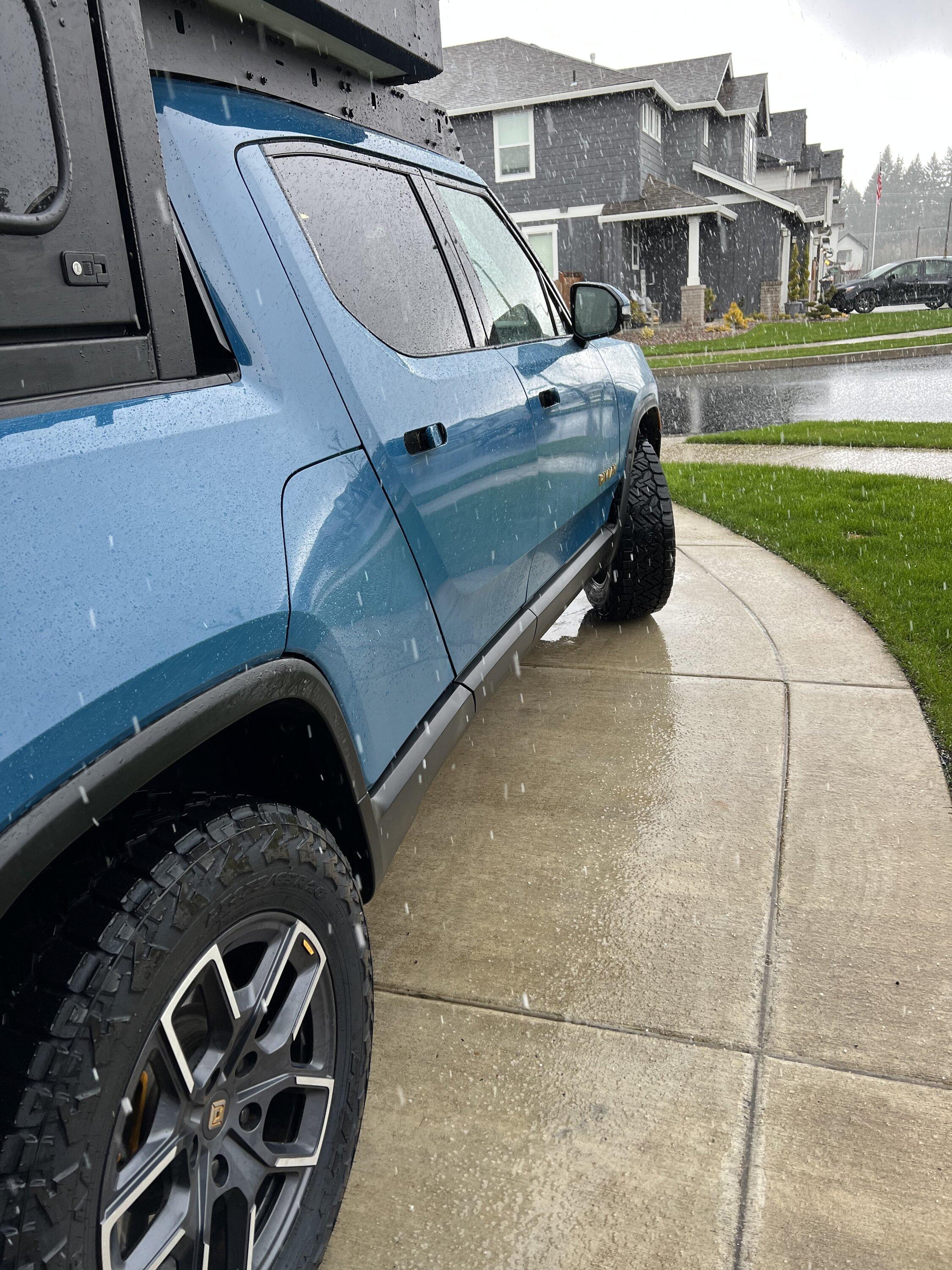

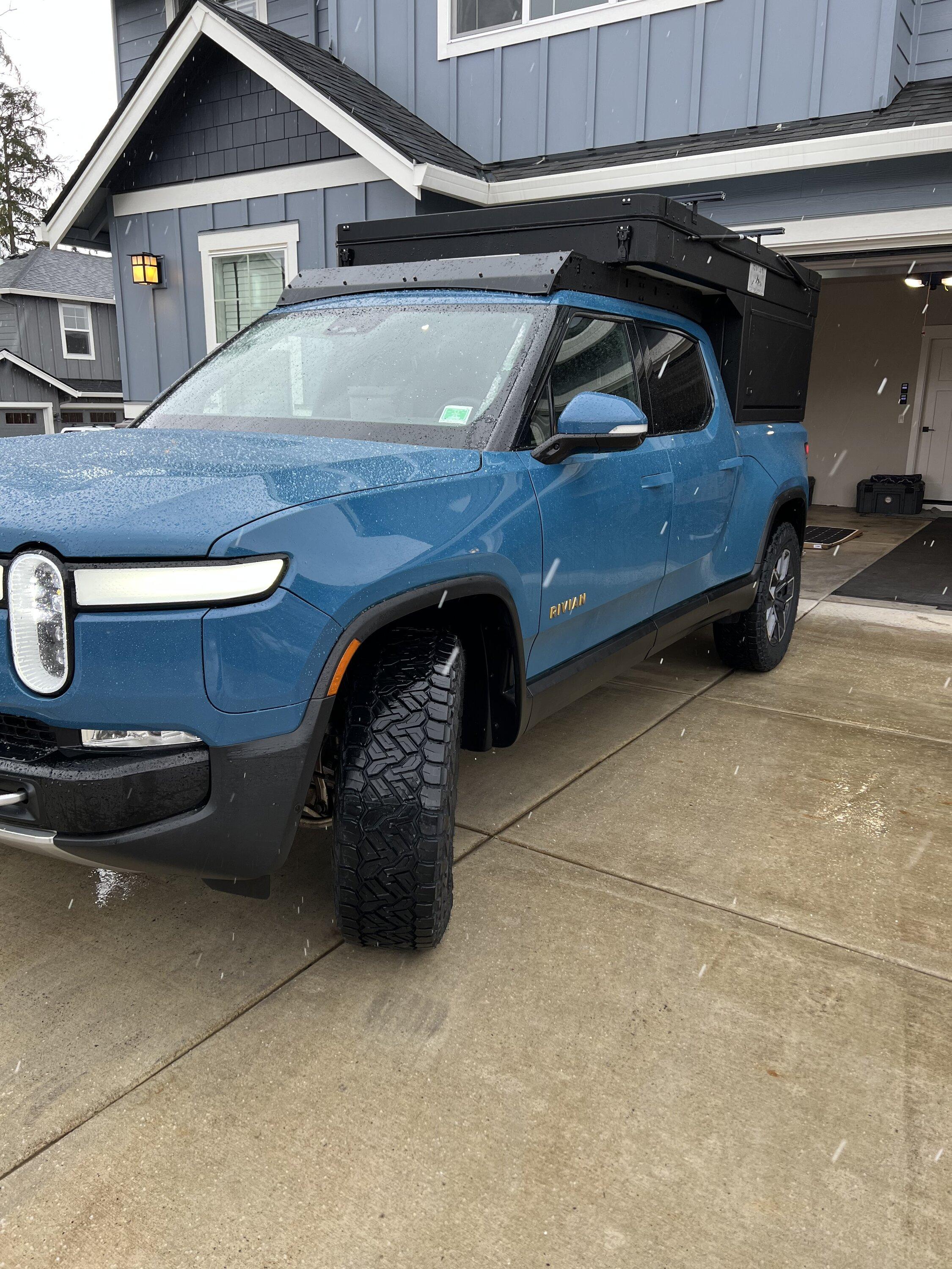

Now that I drove these around for a few thousand miles and also spent some time switched back to my 21s a couple of observations about the Nitto Recon Grappler's.
1. They can get a little squirely on the highway on rougher roads, I assume this is due to the aggressive tread pattern. Its not something I recall on the 20" Pirelli ATs.
2. The difference in efficiency of the Nitto Recon Grappler vs the 21" Pirelli AS tires is about 14% (1.64 vs. 1.9 mi/kWh) - Note the lower number is due to aero effects from my camper shell. This is also an upper bound since I spent more time off road on the 20" Nitto's.
