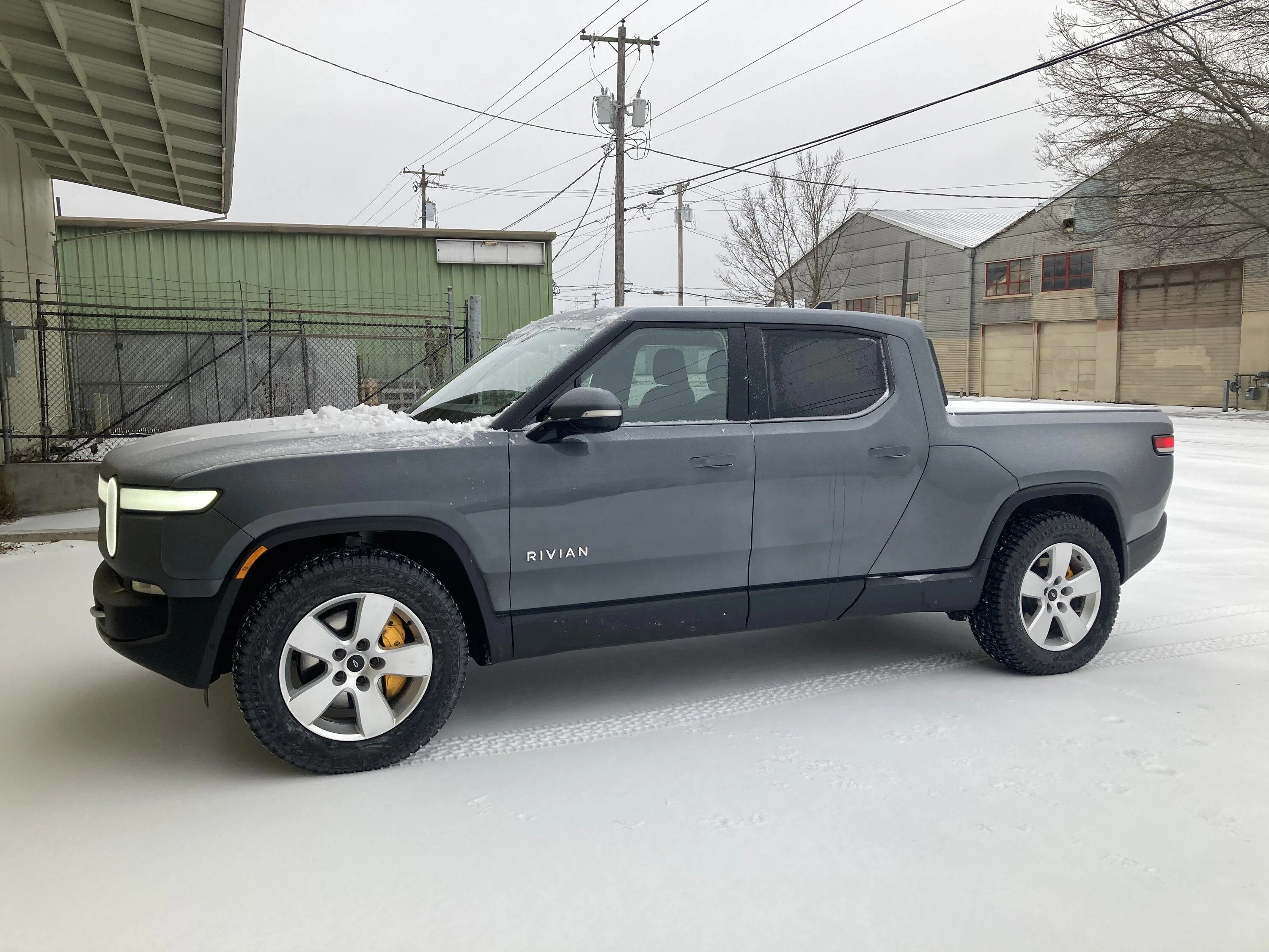

Ok I want more pics :) I'm looking at these now more seriously... What tires you got on there? Will 275/60/20 fit fine with the 8 inch width? TIA!
They're 275/65R20 BFG Mud Terrain T/A KM3s.

Any rubbing on lowest ride height? How long did the Wheels take to arrive? Did you mount them yourself?
These are the stock 20" size tires. I have not experienced any rubbing at any height, however, I don't drive in the lowest setting a ton. The wheels came with tires mounted and arrived in less than a week.

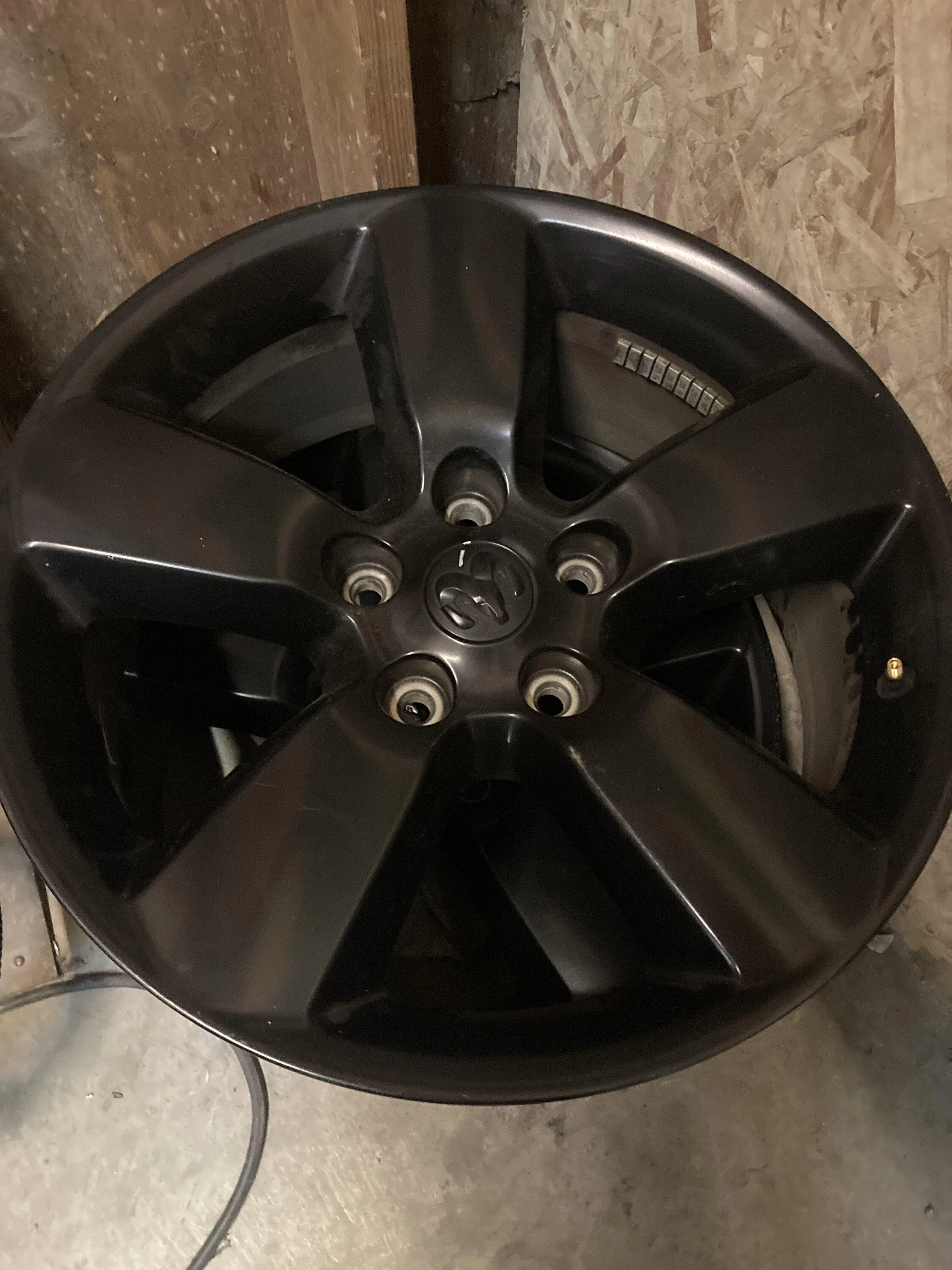

I got one for my spare tire kit since Rivian is taking their time and the 2363 wheel clearly needs a spacer to clear the Rivian calipers in the front. I forgot to take a picture when I was dry fitting the wheel.
Has anybody else put a spacer on their 2363 wheels? I am thinking 3-5 mm is plenty.

You don’t need spacers. These wheels already have a smaller offset than stock so they are out a little further to begin with. What you do need are hub centric rings.

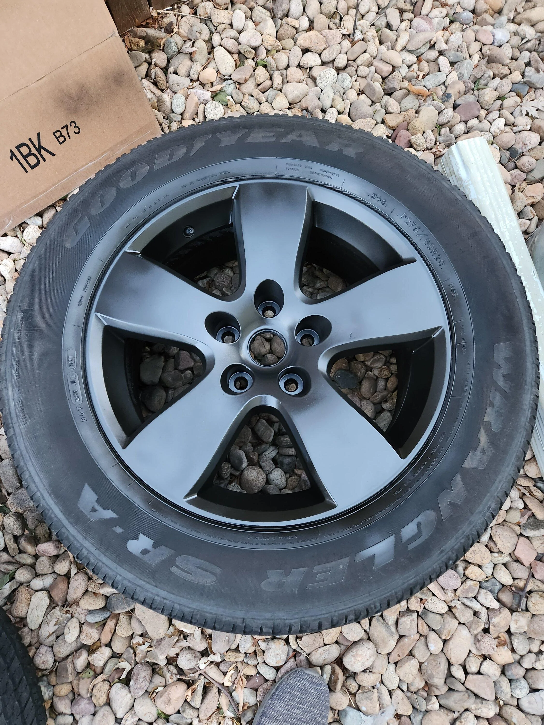

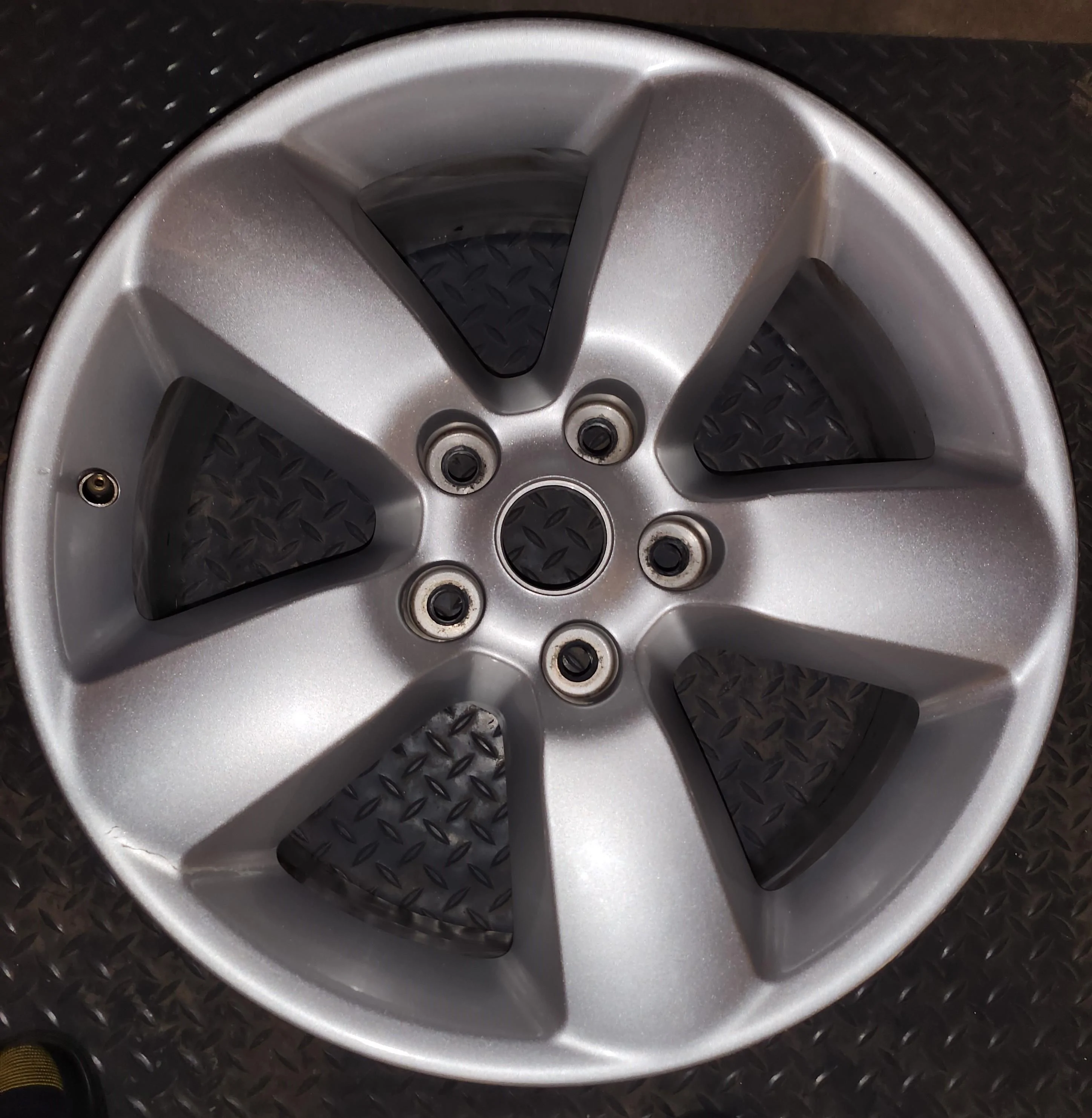

You just need to be sure that you have these wheels:
And NOT these:
They can be easily confused. Don't ask me how I know.
That might explain why mine wouldn't clear the caliper in the front.
