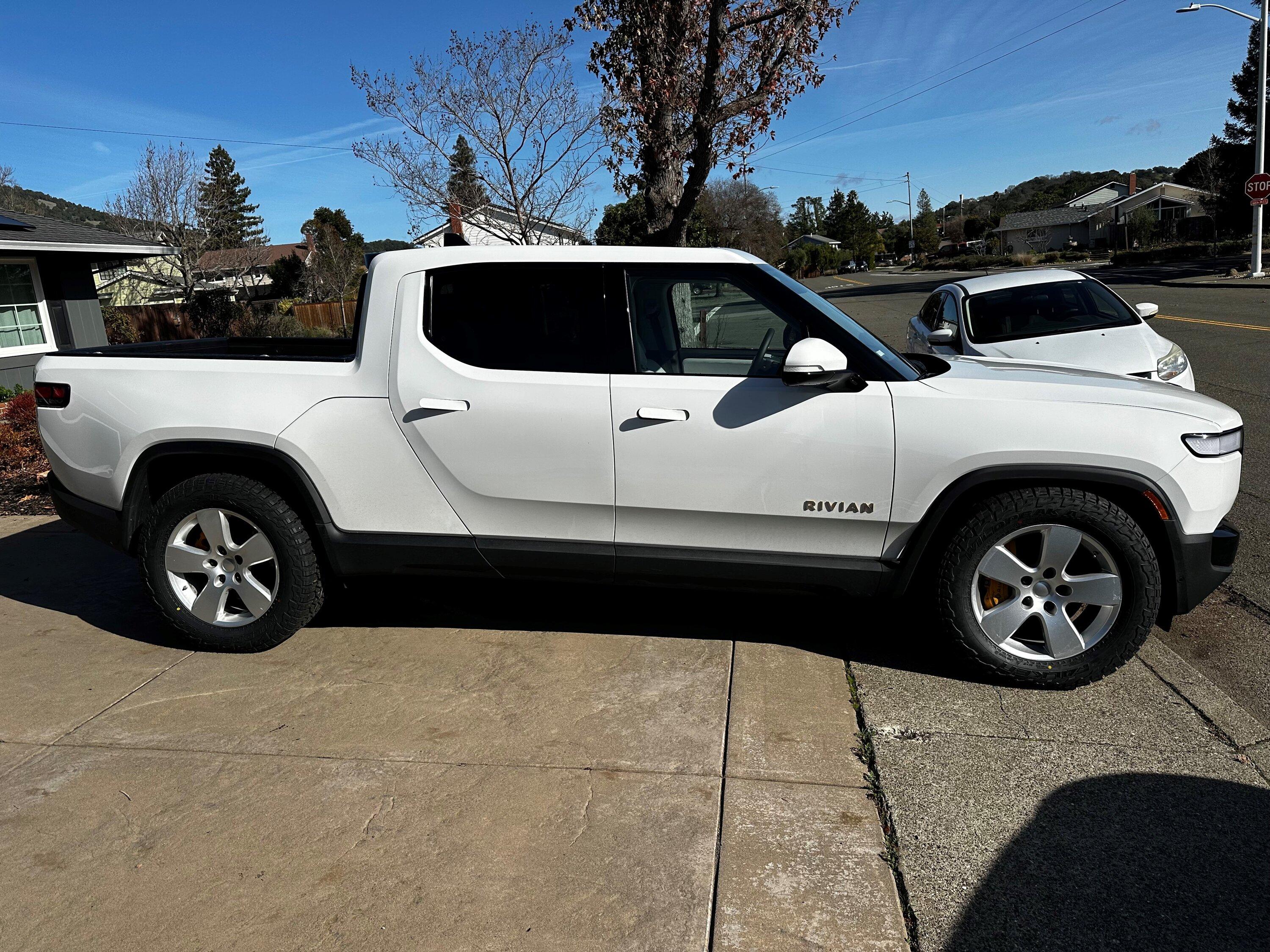

I too went with Ram 2363 set. Thanks to all those who posting about this. I had the stock 20s, but traded for the 22s with the idea of alternating between the 22s and this set of 275/60/20s for off-road/winter driving.
Had trouble finding a set of Tpms sensors, but ended up buying a programmer. Worked beautifully with the guide posted elsewhere here. These are rattle can wheel paint, but while it didn’t turn out bad, I probably would have powder coated if I did it again.

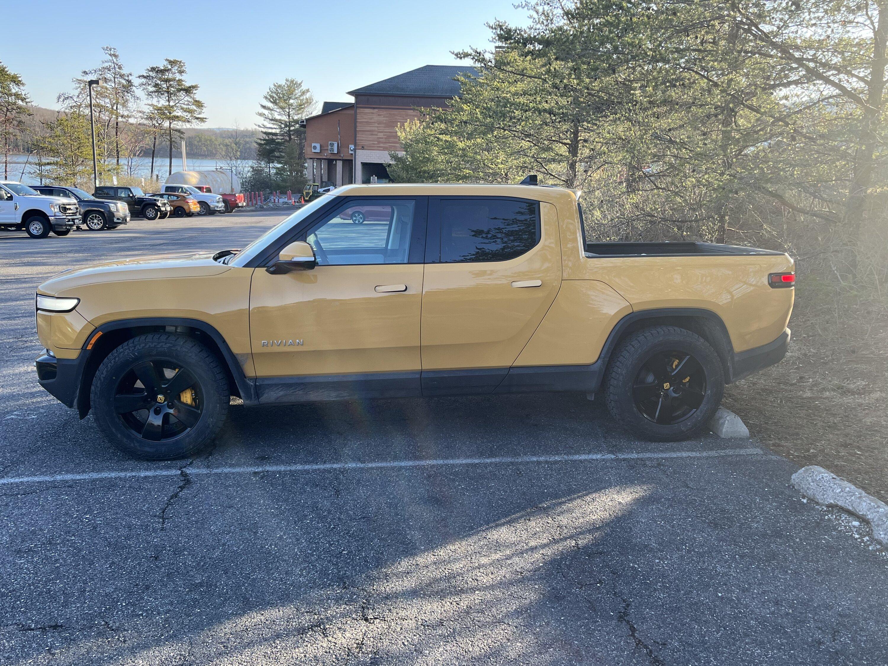

Finally got my Dodge 2363 wheels w/ the 275/60r20 Falken Wildpeak AT3W mounted, mostly for dirt/sand but making a trip up to the snow this weekend. For me the TPMS took 9 miles before they finally sync'd up, seemed like it was quicker for most the others I read about, so just throwing that out there.
Roads will probably be plowed by now so I don't expect to see much snow, but I'll report back mid next week how we look on efficiency. If I recall correctly these are about 20 lbs heaver per corner then the OEM 21" setup so I expect a bit of a hit versus the 2.5 mi/kWh I've seen since I got the truck 2 months ago.
My 2363 setup on the Pirelli Scorpions came in at the exact same weight as the 21" roads. 84lbs each

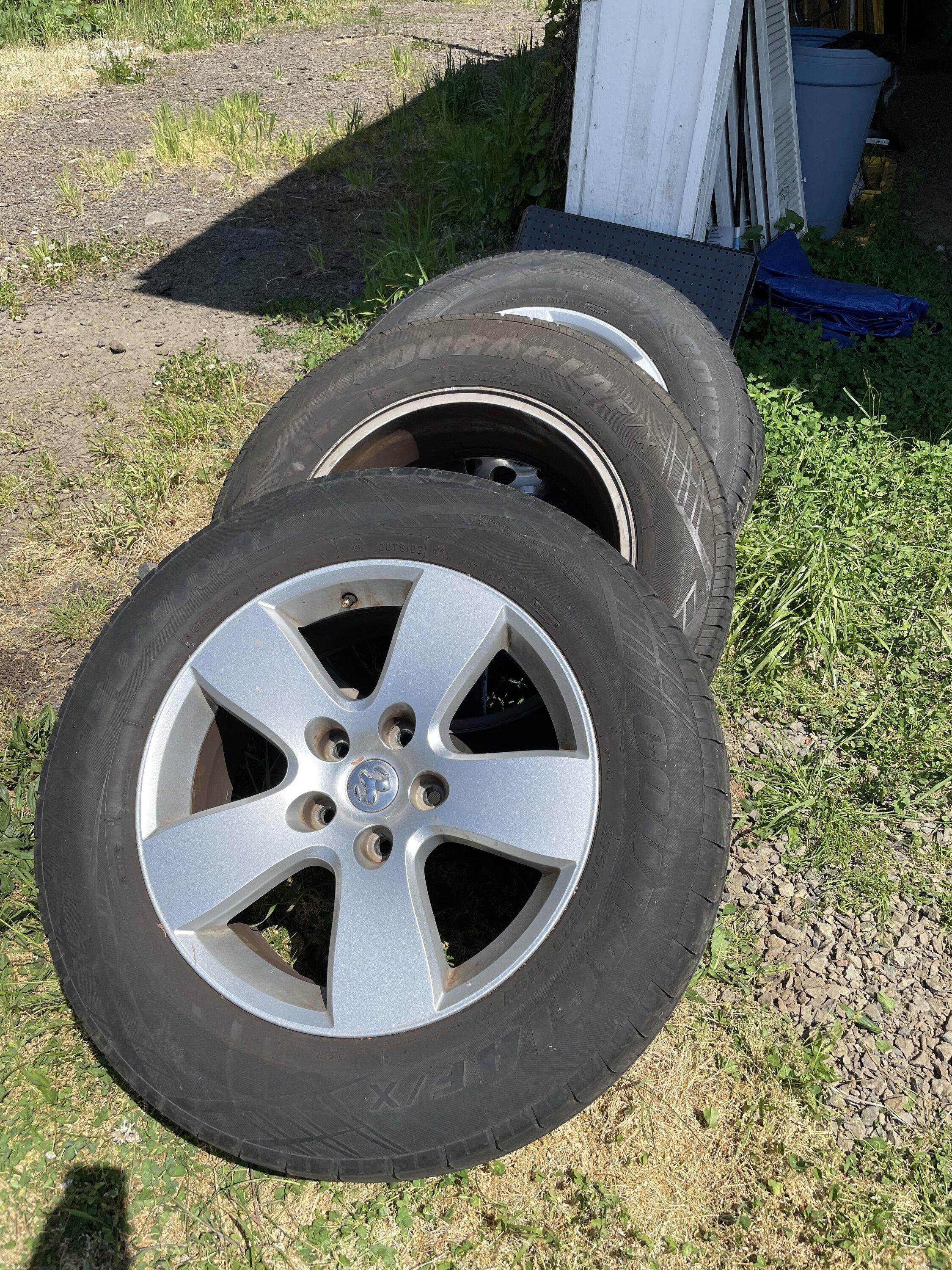

Just picked up 4 of the dodge wheels for $100. Tires on them are done, but I was planning to replace with winter tires anyway. Can’t beat that deal!
