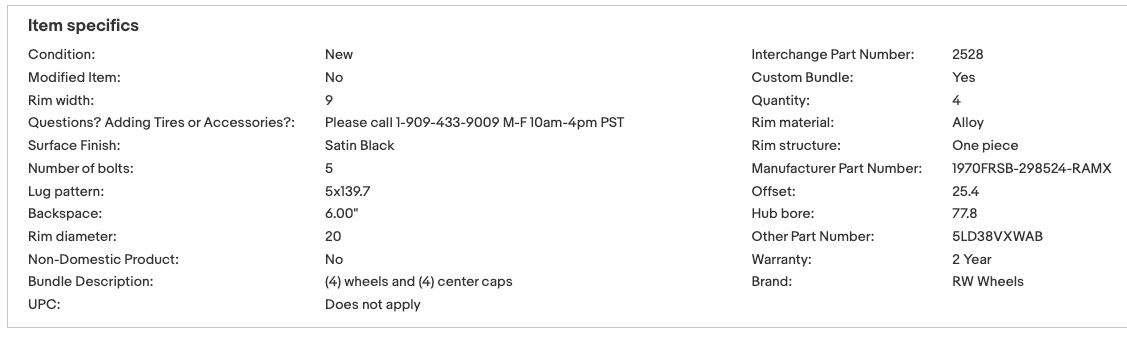

Curiously following this thread as I'm looking to get a separate set of winter wheels (truck is on 20" AT wheels). These are the specs of the wheels I'm considering, aftermarket wheel for Dodge RAM 1500:
Rivian R1T R1S Random 20 Inch rims (cheap) for snow tires 1674851625180
Would love to get feedback from folks who've got more experience/insight with this stuff!

I think the part# you want for the dodge ram wheels that fit is 2363. That is what i have on my truck with no problem. I dont know about the 2528.

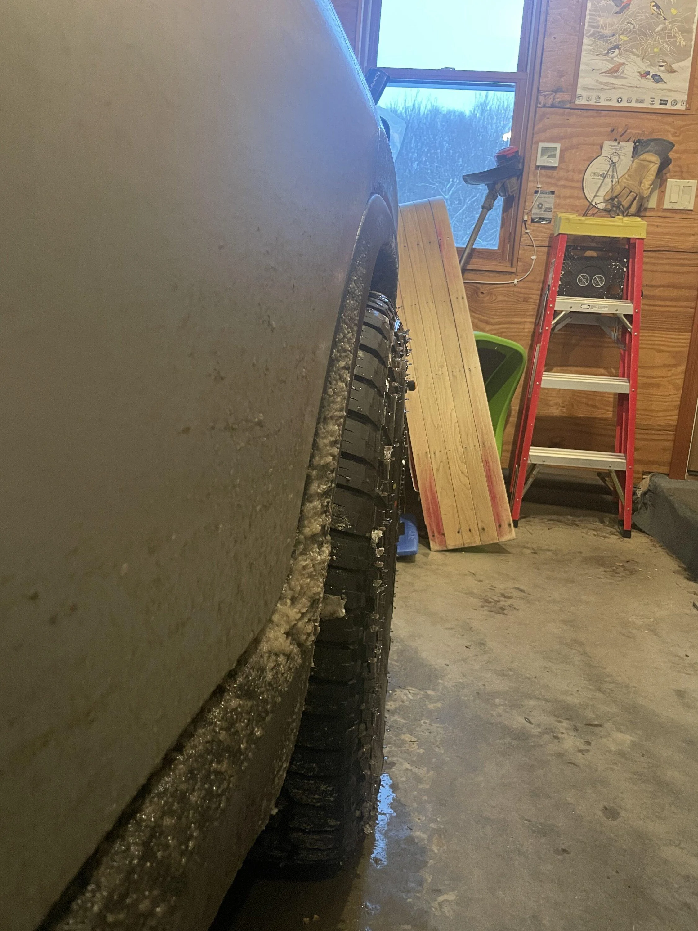

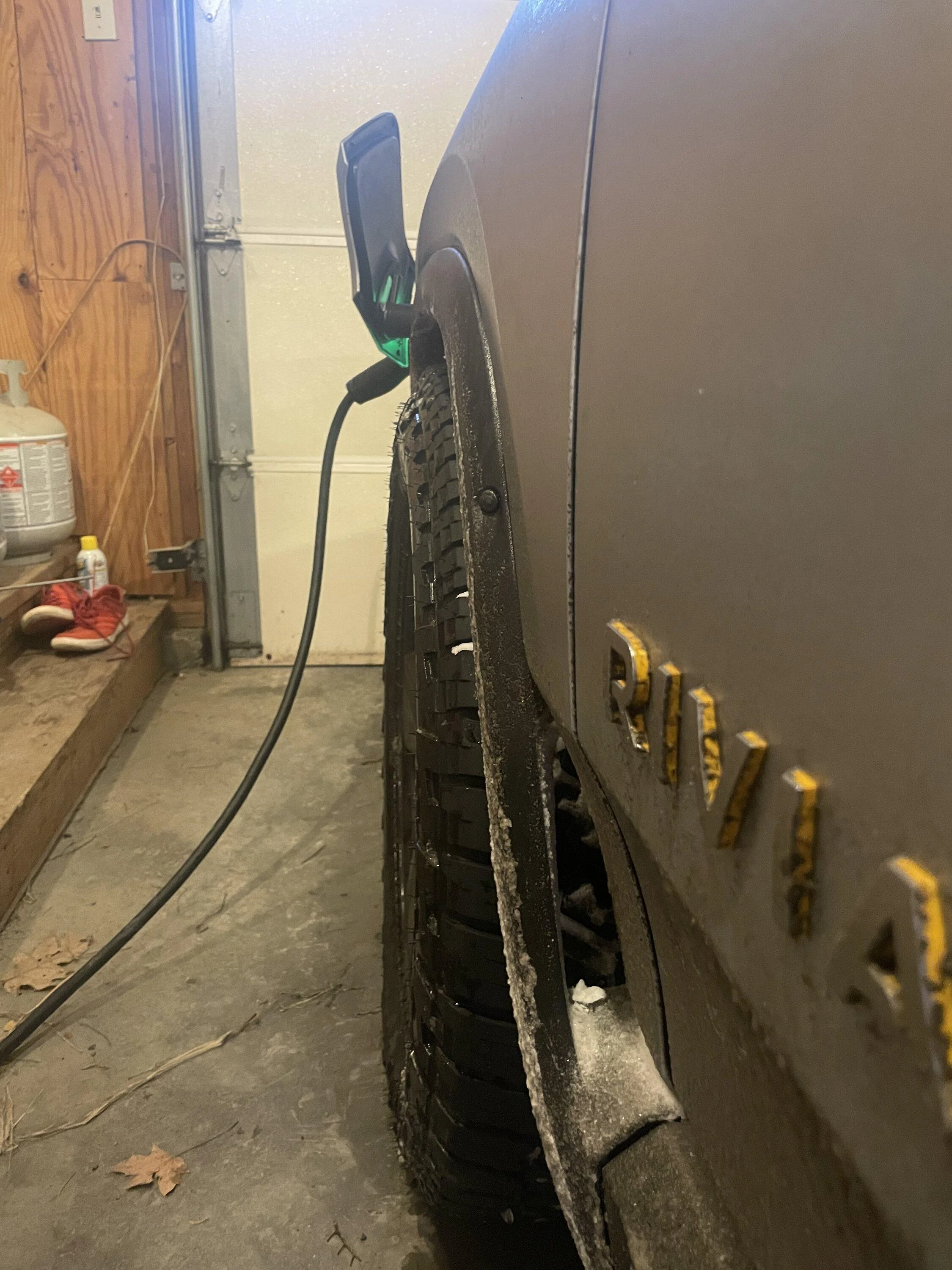

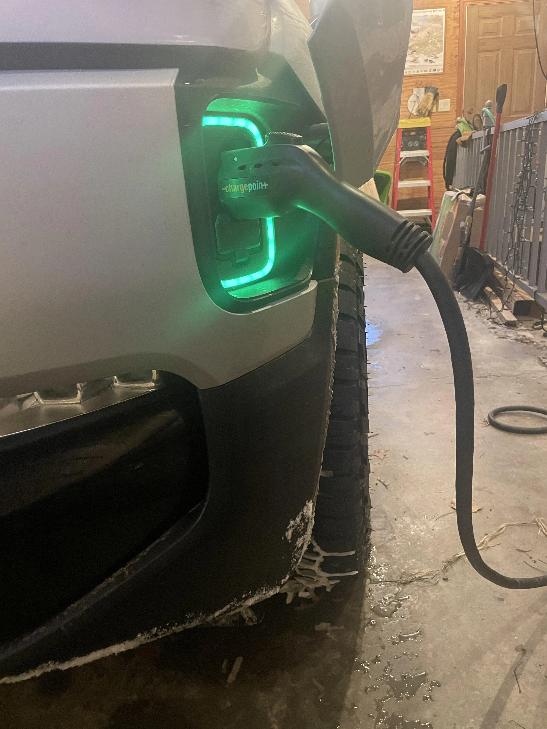

here you go!
Rivian R1T R1S Random 20 Inch rims (cheap) for snow tires 356DCBA9-0C66-4003-A790-298F0B0A2438
Rivian R1T R1S Random 20 Inch rims (cheap) for snow tires 36C5A92D-4376-43C9-A961-F4446C01C02E
Rivian R1T R1S Random 20 Inch rims (cheap) for snow tires 6AE654D8-C24B-438A-8BBC-0984A0F9DC92

sweet! yeah, I don't think that protrusion is bad at all ... and you have no issues with tires rubbing the fenders on the lowest ride height?
I have not done much driving on the lowest ride height yet this time of year, but I have definitely not noticed any rubbing on low, or when it has been in 'kneel' mode.
