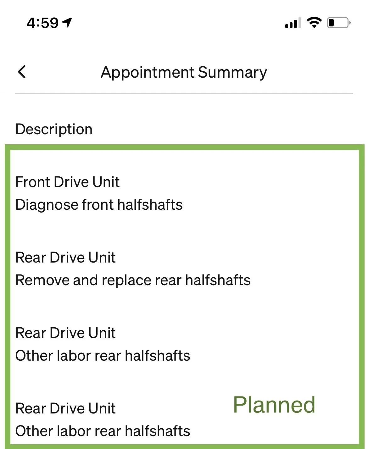

They are not going to repack the cv boot, they’re going to replace the entire halfshaft :).
That's what I'd expect from a "new" vehicle with low mileage. Labor to swap parts is less than repairing, in many cases, and they may want to analyze the failure.
Wow!
Seriously!
I'm not a mechanic, but that seems extreme right?

Not really. There's a level of risk (for Rivian) associated with re-packing and fixing the boot. If grease has been leaking out, there's no telling what may have also made its way in (water, debris) that increases the risk of premature failure of the repair. With a warranty replacement, they can likely pass at least some of the cost back to the supplier. A simple R&R is really a no-brainer in this scenario.
