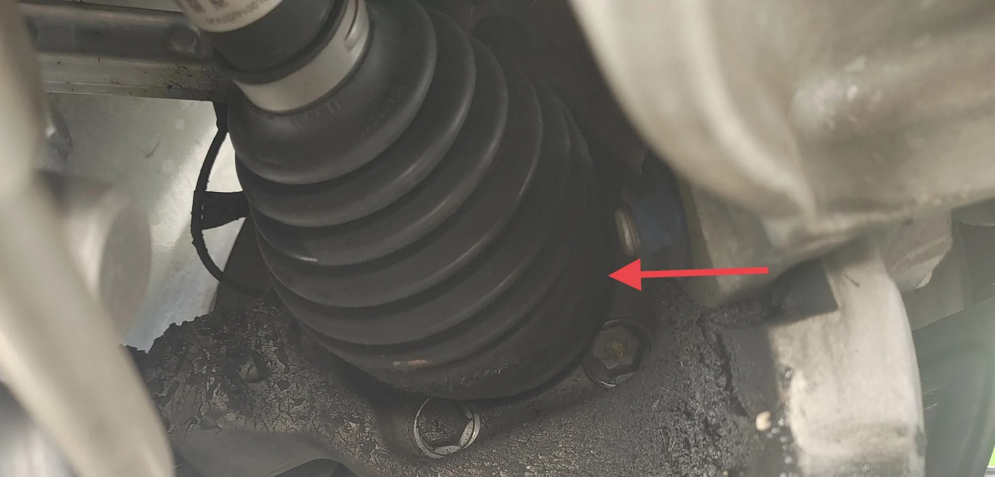

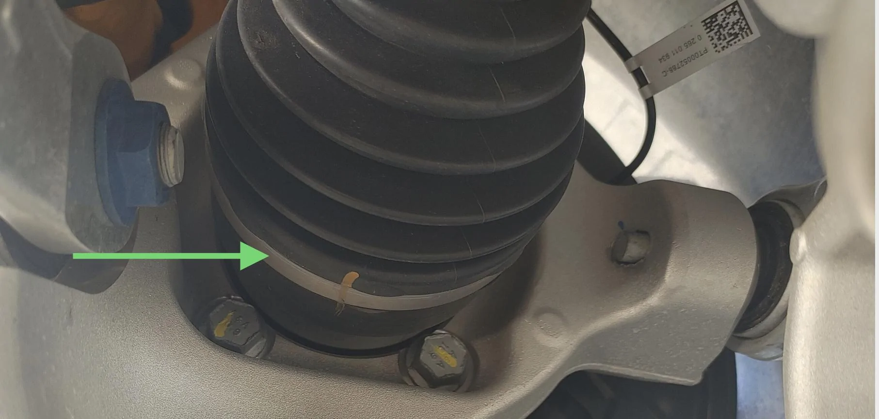

Pictures below of a good CV axle and the bad one
Unless I’m mistaken, the CV boot clamp is missing entirely from the wide end of the bad one. That would certainly explain why the grease is leaking out!

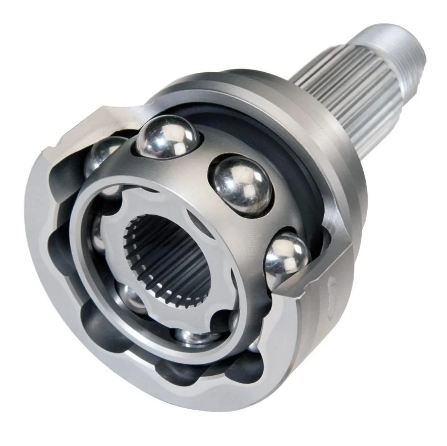

Not surprising they elected to replace the halfshaft/inboard/outboard CV joint... would you really like to run a precision assembly like a modern CV joint with the grease flung out and exposed to the elements?
Clamp
No clamp visible
Right where your red arrow is pointing is a lighter area compared to the boot. That’s likely the clamp. looks like It’s there, just covered in crud.
of note, the first one shows a witness mark on the clamp. So they definitely are checked at assembly.
That's either the clamp... or where the clamp used to be. Easy enough to determine should the OP want to crawl under and see.

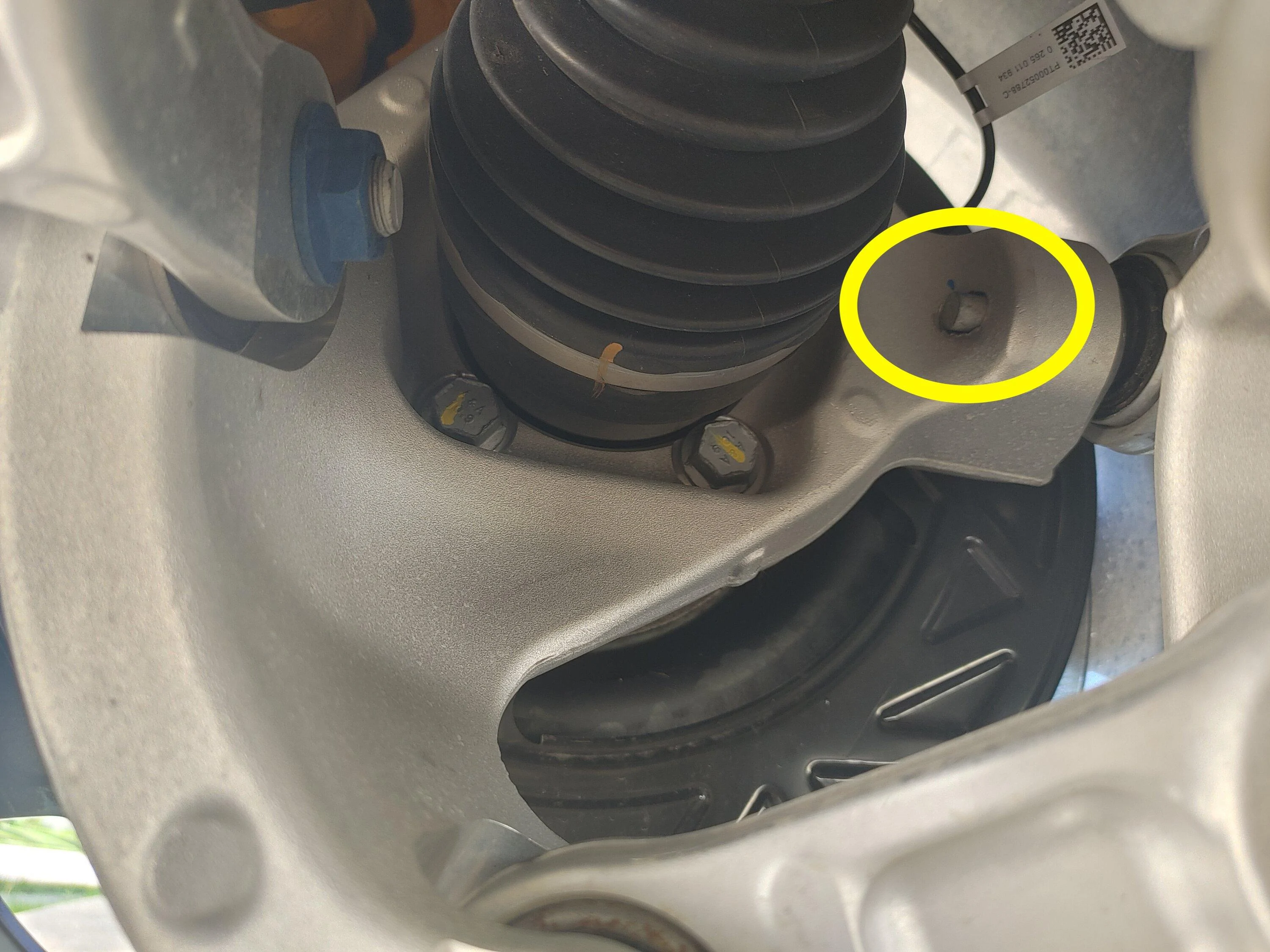

Am I seeing things or does this not seem like it should be the way it is, either?
Rivian R1T R1S R1T CV Axle Boot Issues (Q&A) 0609221541c_HDR
5,772
10,166
2022 Rivian R1T LE
Looks to be that way on the other side as well.
Ok. I don't know what I'm looking at, but for some reason it makes me nervous, like it's missing a fastener. If it is like that on the other side, it must be by design.

I guess that component must not have a lot of tolerance for movement in a lateral direction to pop off of that bolt or rod.
I should probably read up on the anatomy of suspension components before I look at more upskirt pics of the R1T....
I suspect that is the tail end of the ball joint pressed into the other side of the knuckle.
5,772
10,166
2022 Rivian R1T LE
Whoah there! Let's not jump to conclusions! To be fair, I don't know much about these components either, but it is reassuring to see it in multiple examples.
Ahhhhhh. That makes sense now. Thank you.
