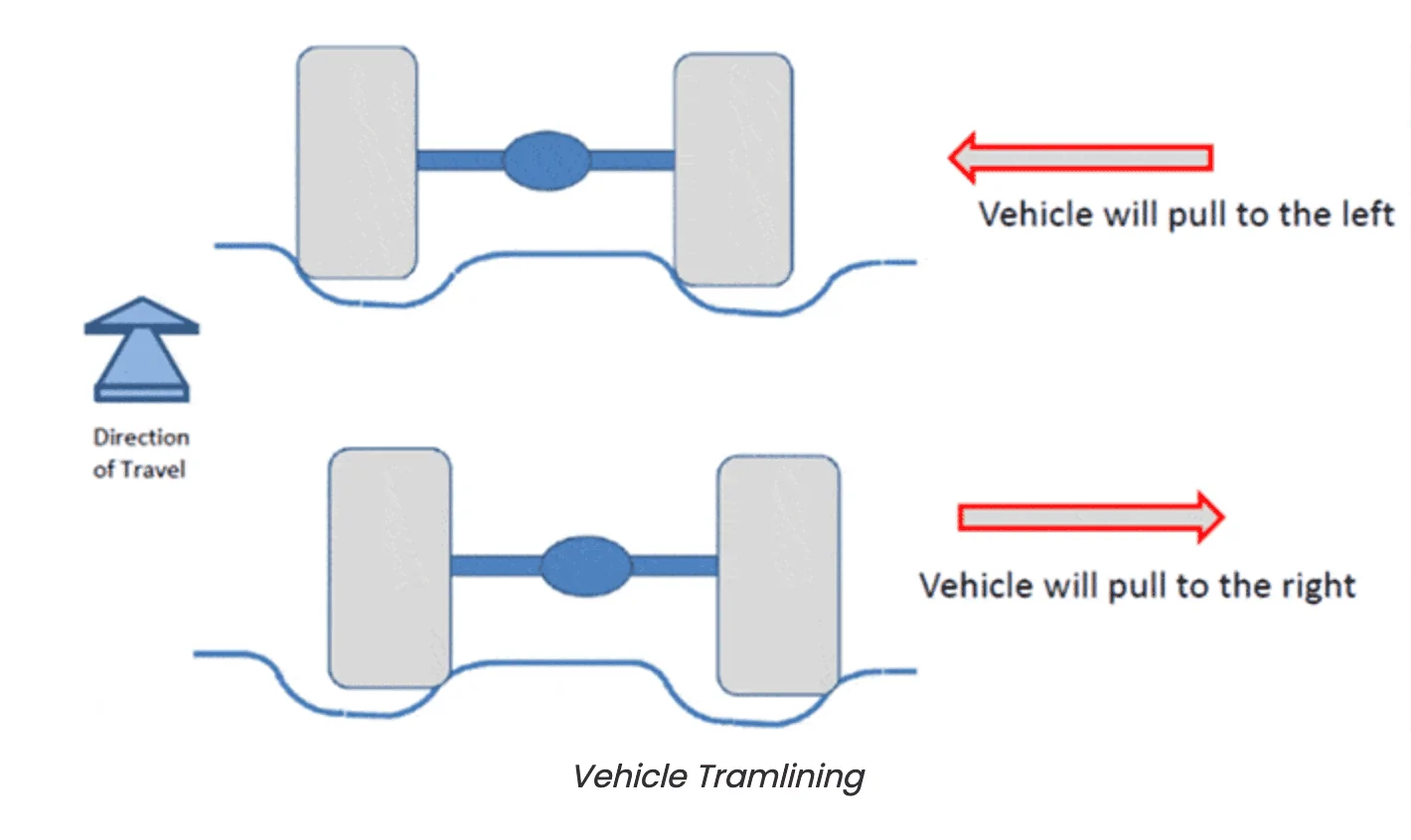

It could be tramlining which is caused by the road surface. Does it do it on any/all roads, or repeatedly on only some roads?
Oh my gosh. This brings be back to my days driving in Europe (Germany mostly). The compound they use in the asphalt would make these "Wagon Trails" and it drove me crazy trying to keep my car centered on some roads where trucks would carve out some nice grooves
