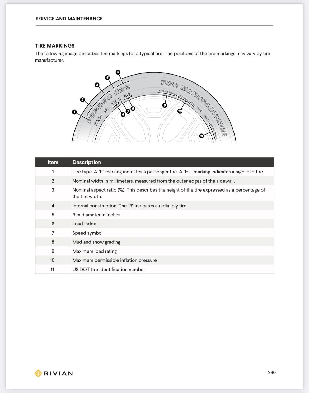

Anyone have documentation onLoad index for R1S with 22” tires? 115 or 116?
sticker in door jam doesn’t say, but math works out that 115’s are fine.
Some R1S came with 115’s
Now they come with 116’s
Discount Tire near me now won’t allow 115’s
Online Manual insinuates 115’s
Called Rivian and did online chat, they don’t seem to know. How is that possible.
Want to put on Michelin X-ice. They should be fine but are rated 115’s. Noted at 2679lbs @ 50 psi.

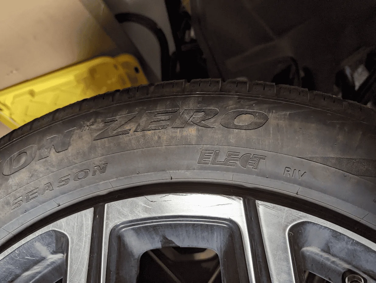

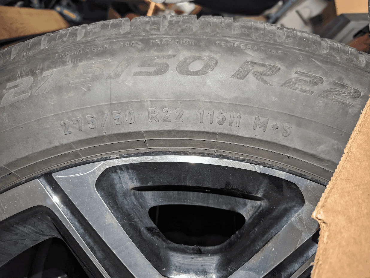

I've got mine off the truck right now and are a bitch to get to but these are the best photos I've got of my RIV branded 115s.
