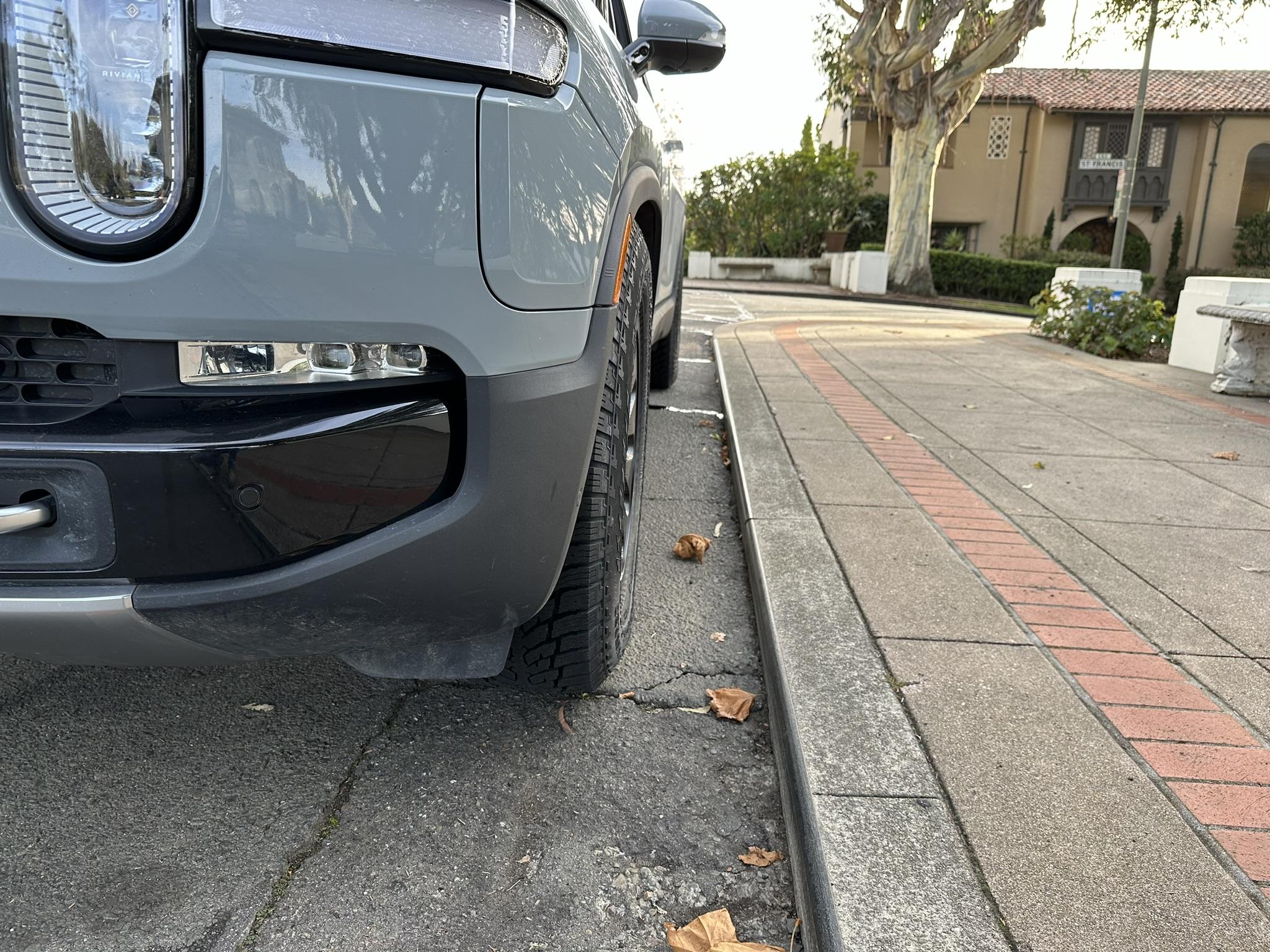

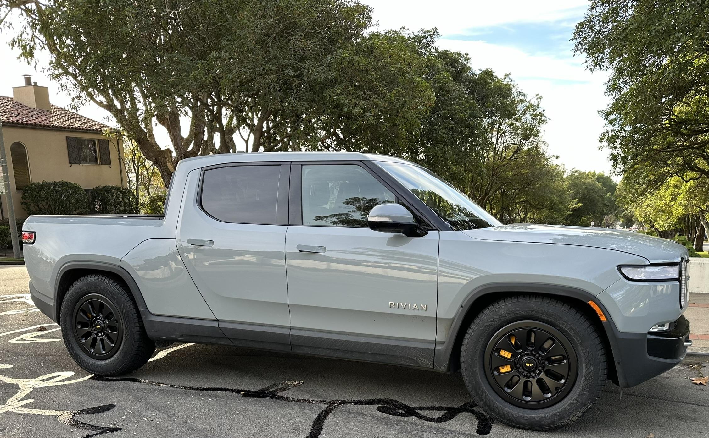

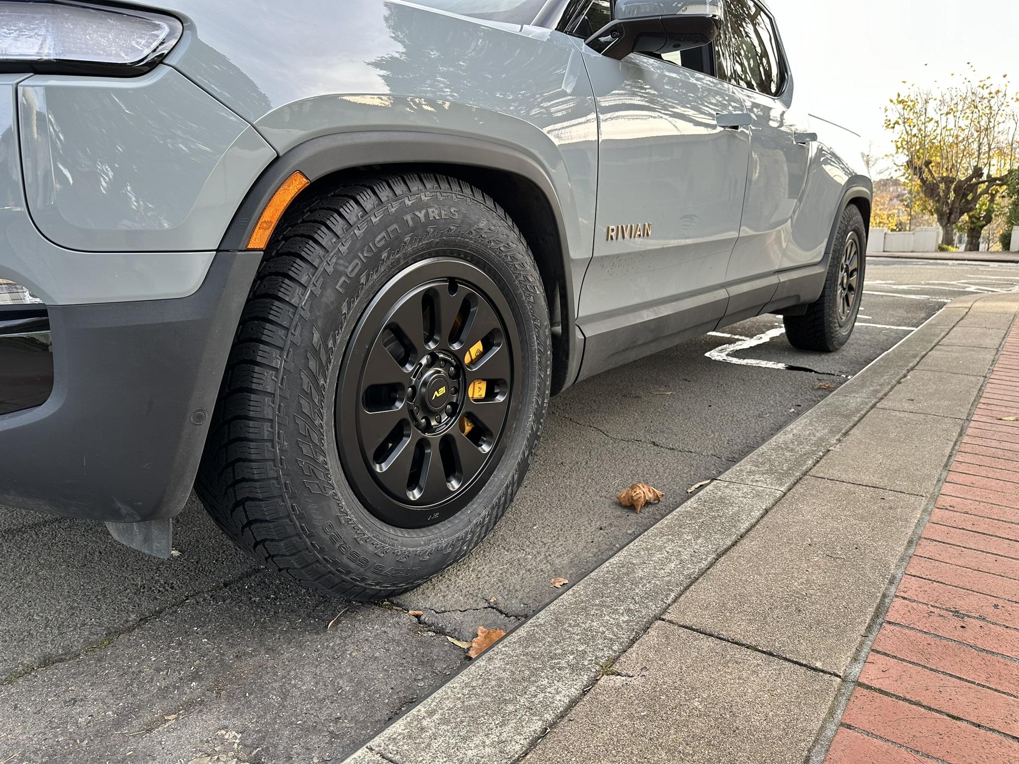

I pre-ordered a set of @EV Sportline R1000 wheels with Nokian Hakkapeliitta LT3 tires back in August in anticipation for this winter. I liked the look of these, liked the idea of a stock +48 offset, and I anticipate that the tires will perform similarly to the Hakkapeliitta R3 set that I used on my previous truck. They arrived last weekend and I had a chance to install them today.
They were packaged with multiple layers of foam and cardboard securely strapped in place to ensure no shipping damage to the rims. Sorry, no pictures of the packaging. I was anxious to unwrap and stack them up in a corner of the garage last weekend so that I could get back to Christmas decoration duties.
Today I installed them and am very happy with the look.
Rivian R1T R1S Installed: EV Sportline R1000 wheels and Nokian Hakkapeliitta LT3 winter tires IMG_0580.JPEG
Rivian R1T R1S Installed: EV Sportline R1000 wheels and Nokian Hakkapeliitta LT3 winter tires IMG_0582.JPEG
The +48 offset makes for a stock fit. I never use the lowest ride height but tried it out on a short drive and confirmed no rubbing at full-lock.

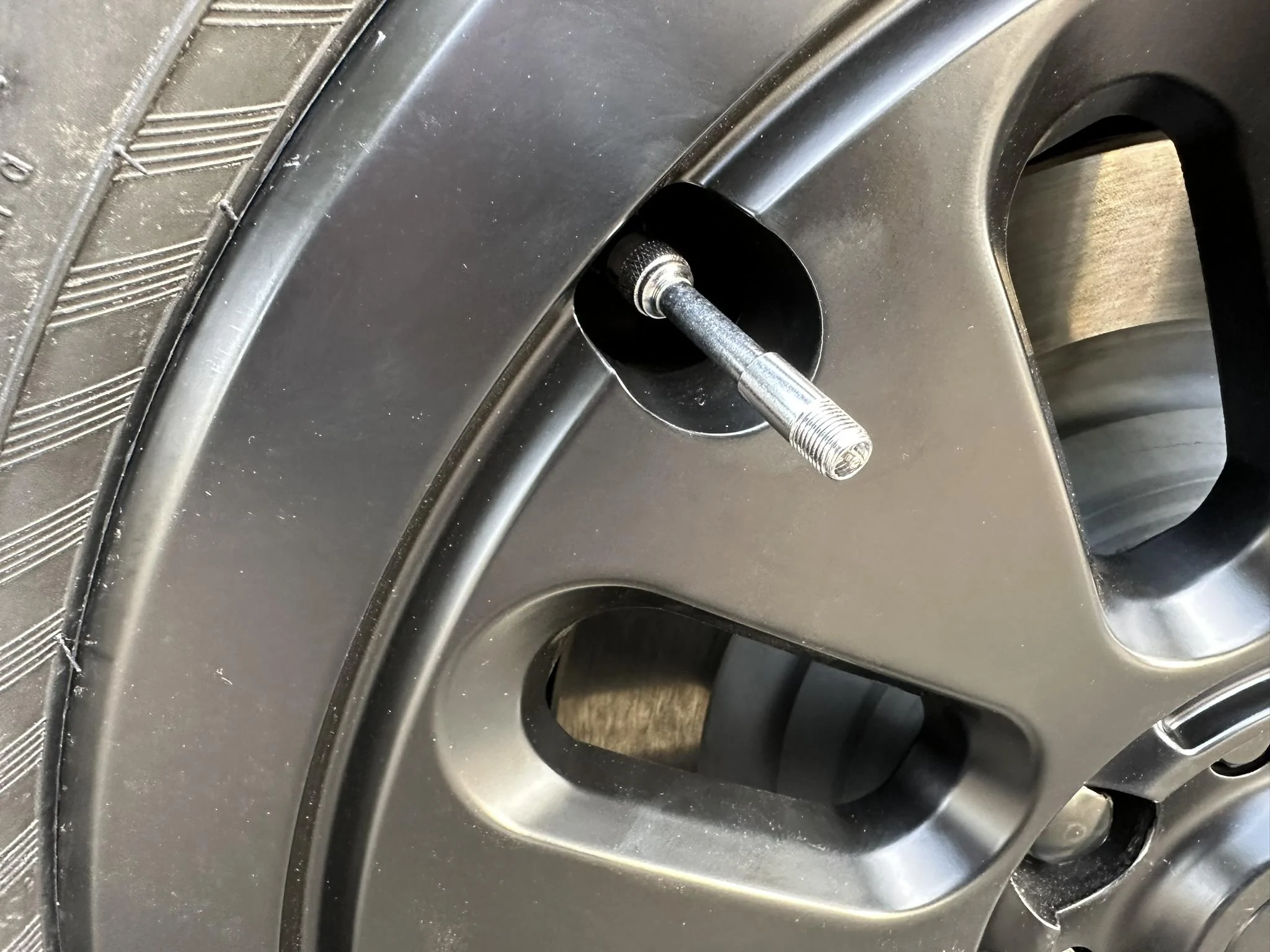

TPMS sensors were included and registered automatically during a short test drive. My one disappointment is that the valve stems are recessed and difficult to access. It will not be fun trying to unscrew the valve cap in freezing temperatures. A set of four valve extensions were included for inflation but clearly are not meant to be left on while driving.
Rivian R1T R1S Installed: EV Sportline R1000 wheels and Nokian Hakkapeliitta LT3 winter tires IMG_0590
Rivian R1T R1S Installed: EV Sportline R1000 wheels and Nokian Hakkapeliitta LT3 winter tires IMG_0576.JPEG
My initial impression is that the tires roll smoother than the stock Pirelli Scorpion All Terrain Plus on dry roads in mild temperatures. It will be a couple weeks before I have a chance to try them in snow and ice.

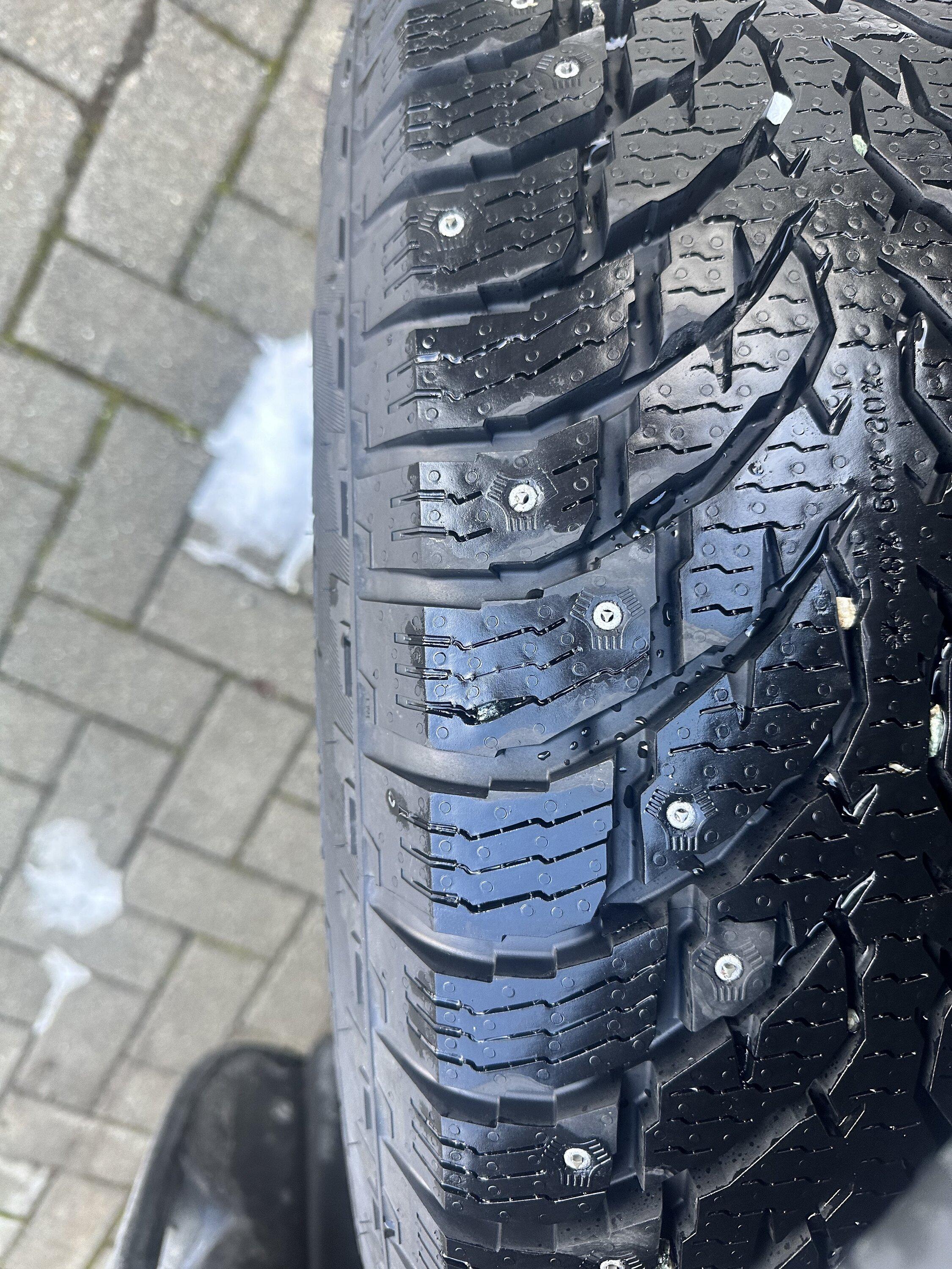

I went the same route as you, except I chose the studded LT3’s.
Almost all of my winter driving is done in the Coast Mountains in south western B.C. Black ice, ice, and frozen slush are pretty much prevalent all winter in the passes and the area we reside in. The studs are a game changer for me in these conditions. The truck really sticks to the road. I’m guessing the weight of the R1T plays a big part in that.

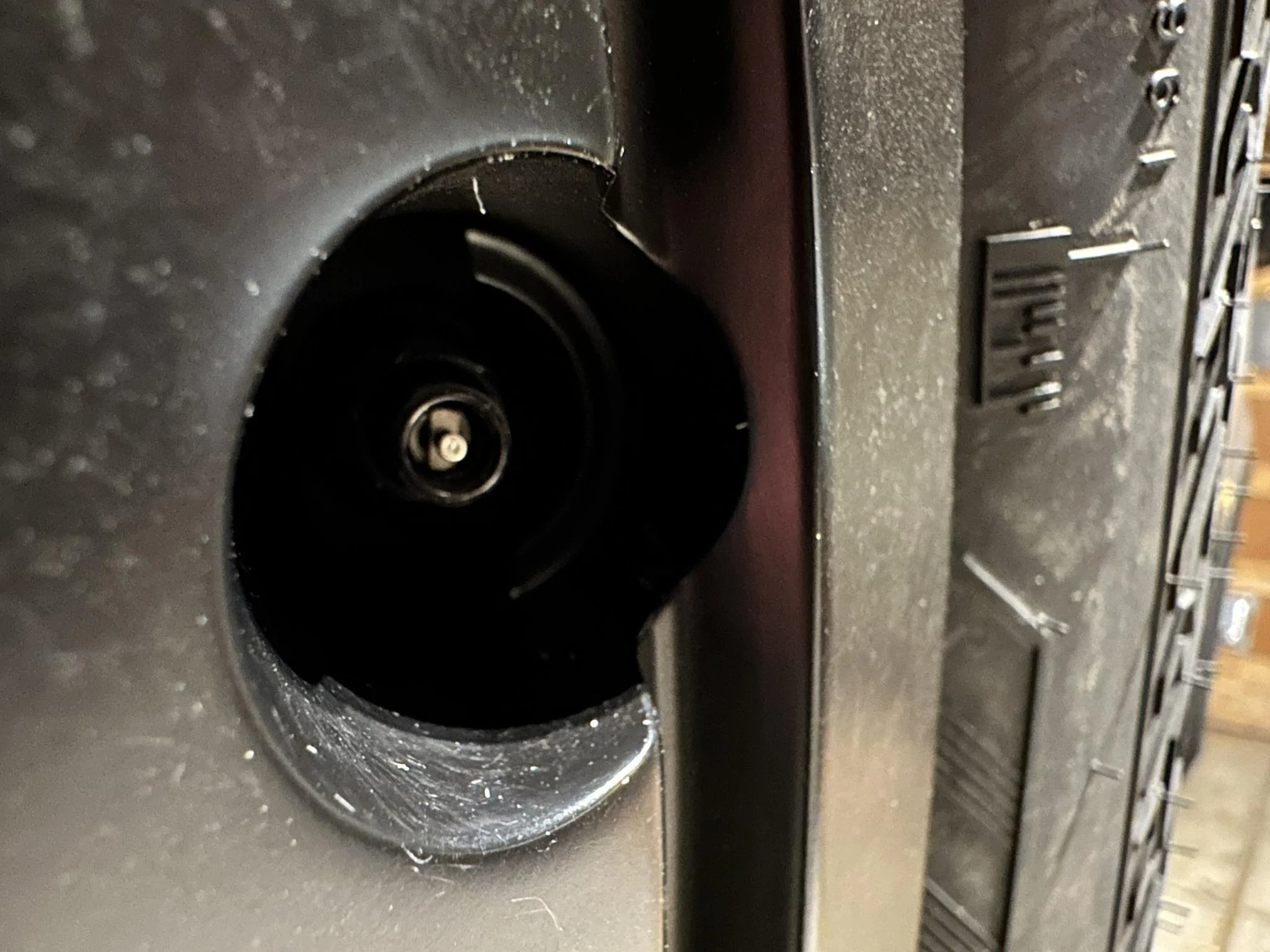

I might be out to lunch on the valve stem design, but I like it. If the valve stems were proud of the rims I think they’d be susceptible to damage from things like curbs, rocks (if your off-road), mud holes, and so on because the face of the rim is close to being flush with the sidewalls. When the valve stems are inset in the rim like they are, they are fully protected. I keep an extender in the truck so it’s there if needed.
The quality of the rims was a pleasant surprise as well. They seem very well made. The tire dealer told me that they balanced with a minimal amount of weight(s).
So, all in all I’m really happy with the whole package.
Nice setup. Great to hear it is working well for you.
I would have considered studded tires if most of my miles were in snow and ice territory. However, the majority of my winter miles will be in the Bay Area and on the road to and from Tahoe.
Agreed that the valve stems need to be recessed to avoid damage. More precisely, the small diameter of the valve stem access hole means I can barely get my fingertips in there to unscrew the valve cap.

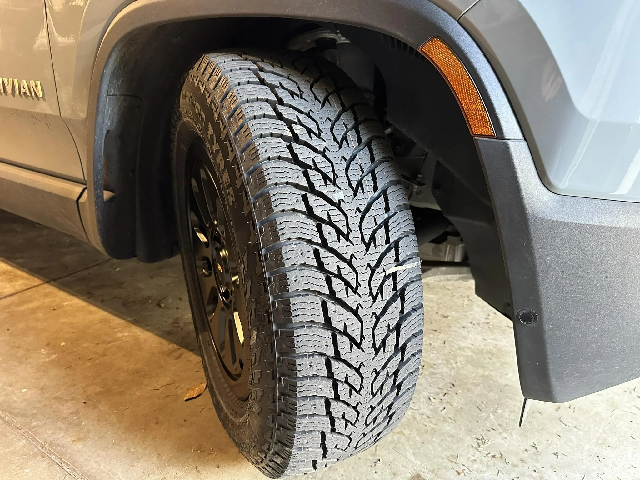

So I got the LT3's as well, but on the OEM 20".
Since they are the same tire size as the OEM AT 20" are you guys inflating them to 48PSI, or something different?
I am starting mine out at 60 psi. LT tires are made for higher pressures which should also help with efficiency.
Nokian recommends (somewhere on their website) +3 PSI over manufacturer for their winter tires. So I'm at 51.
