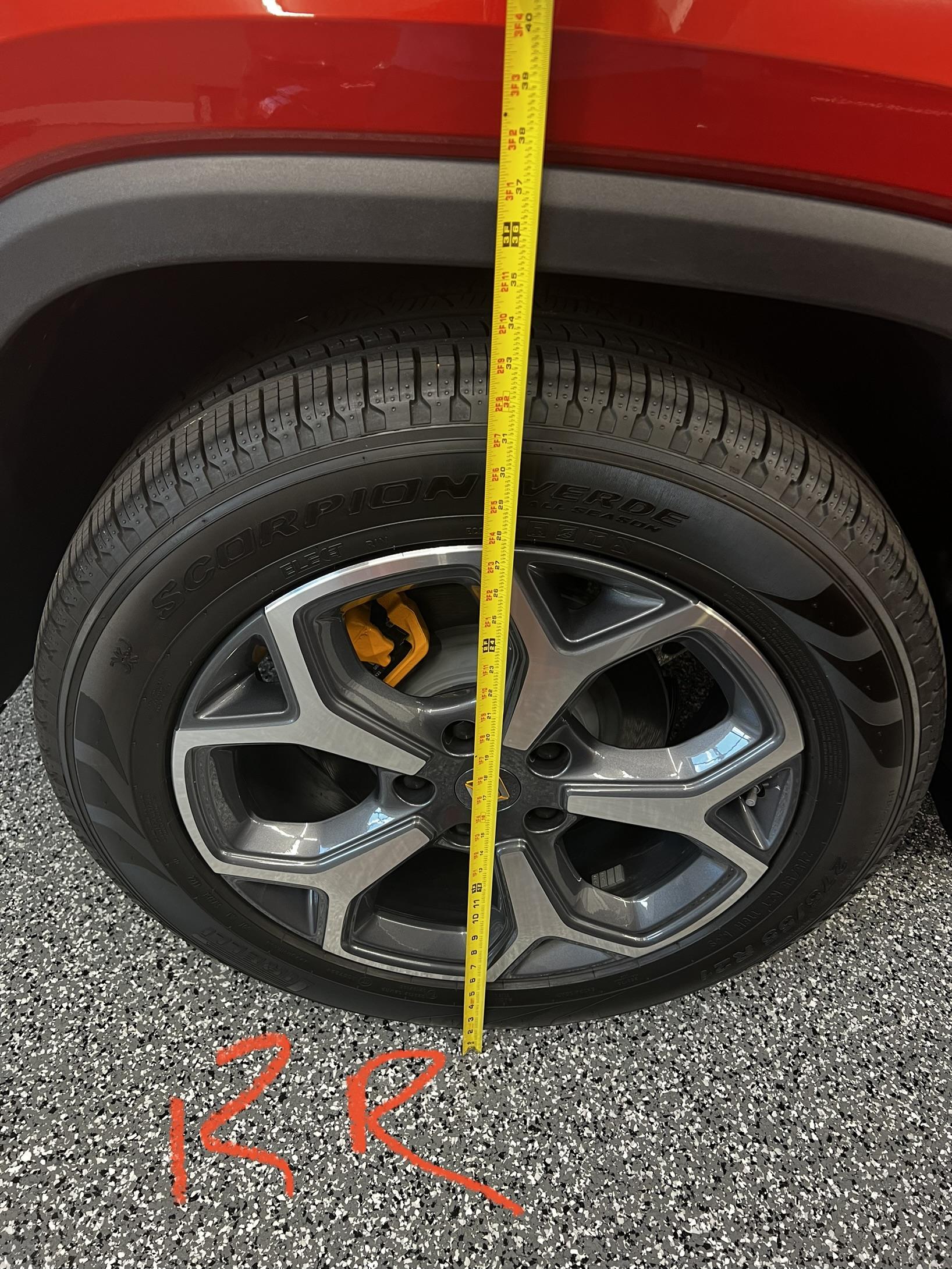

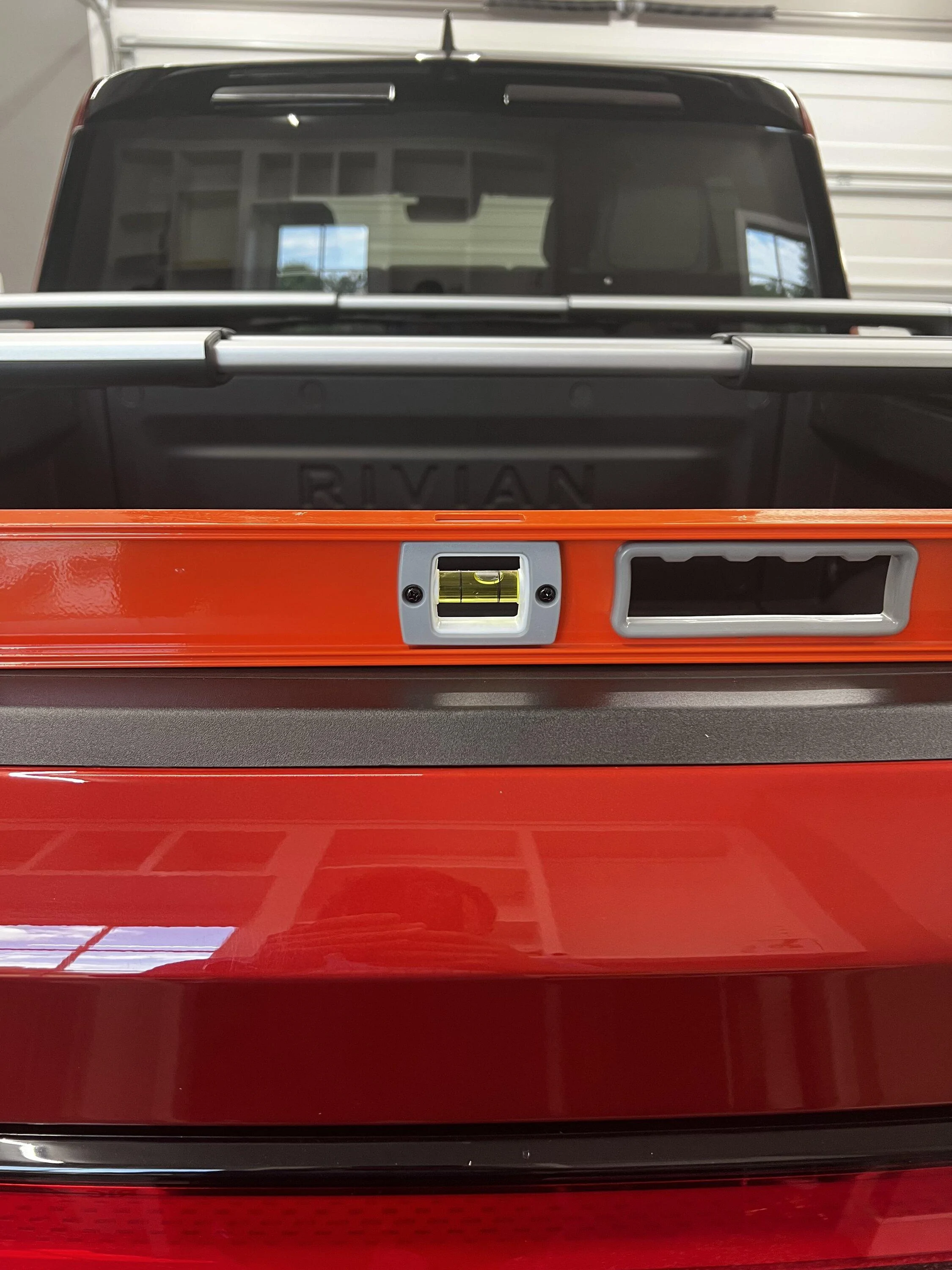

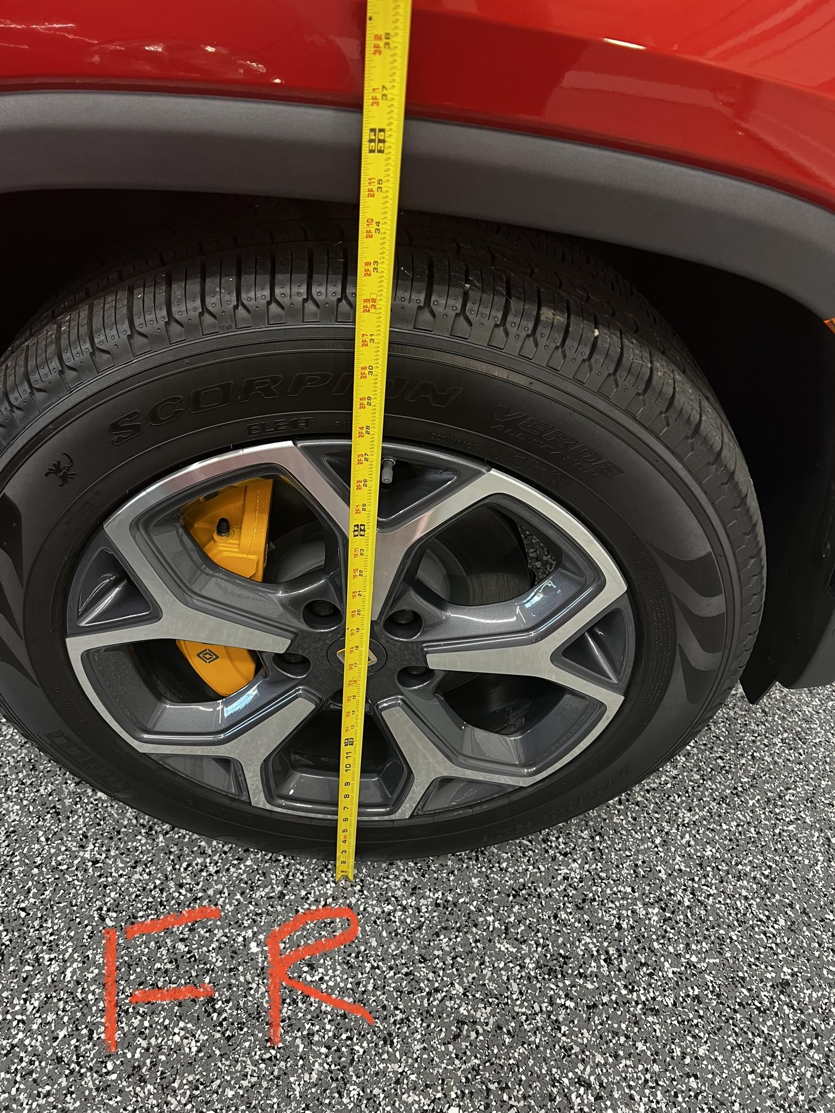

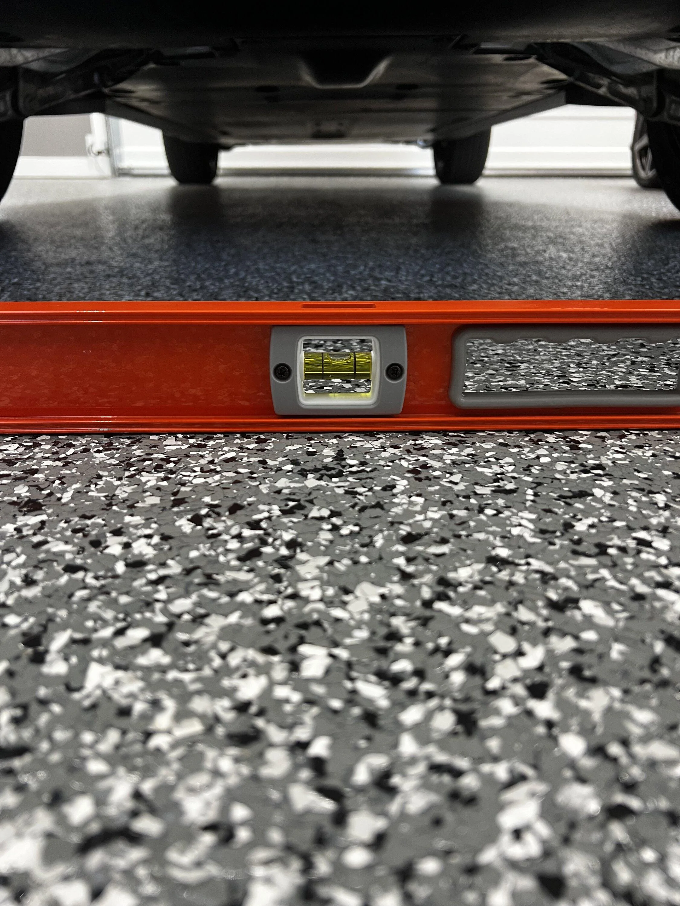

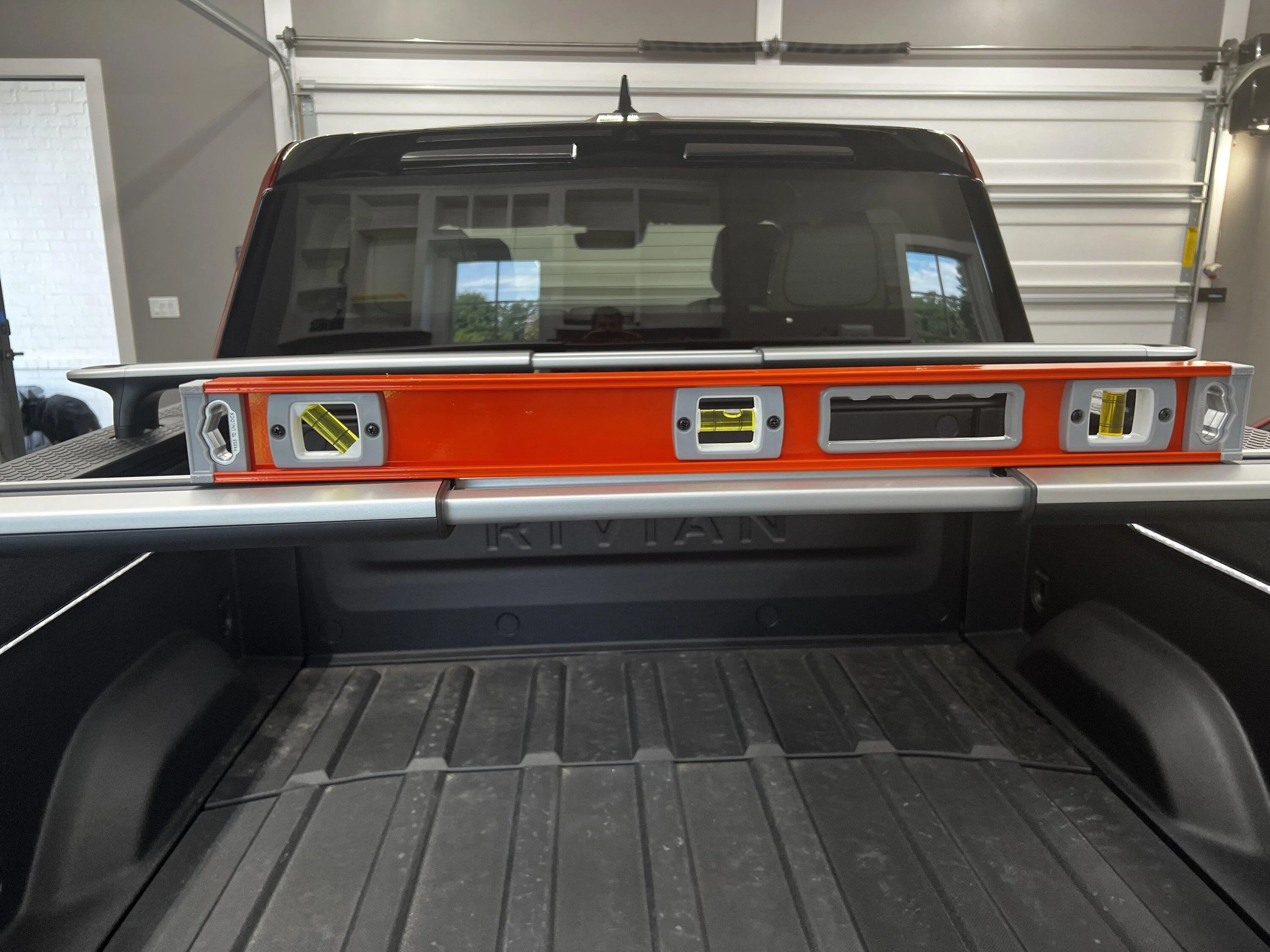

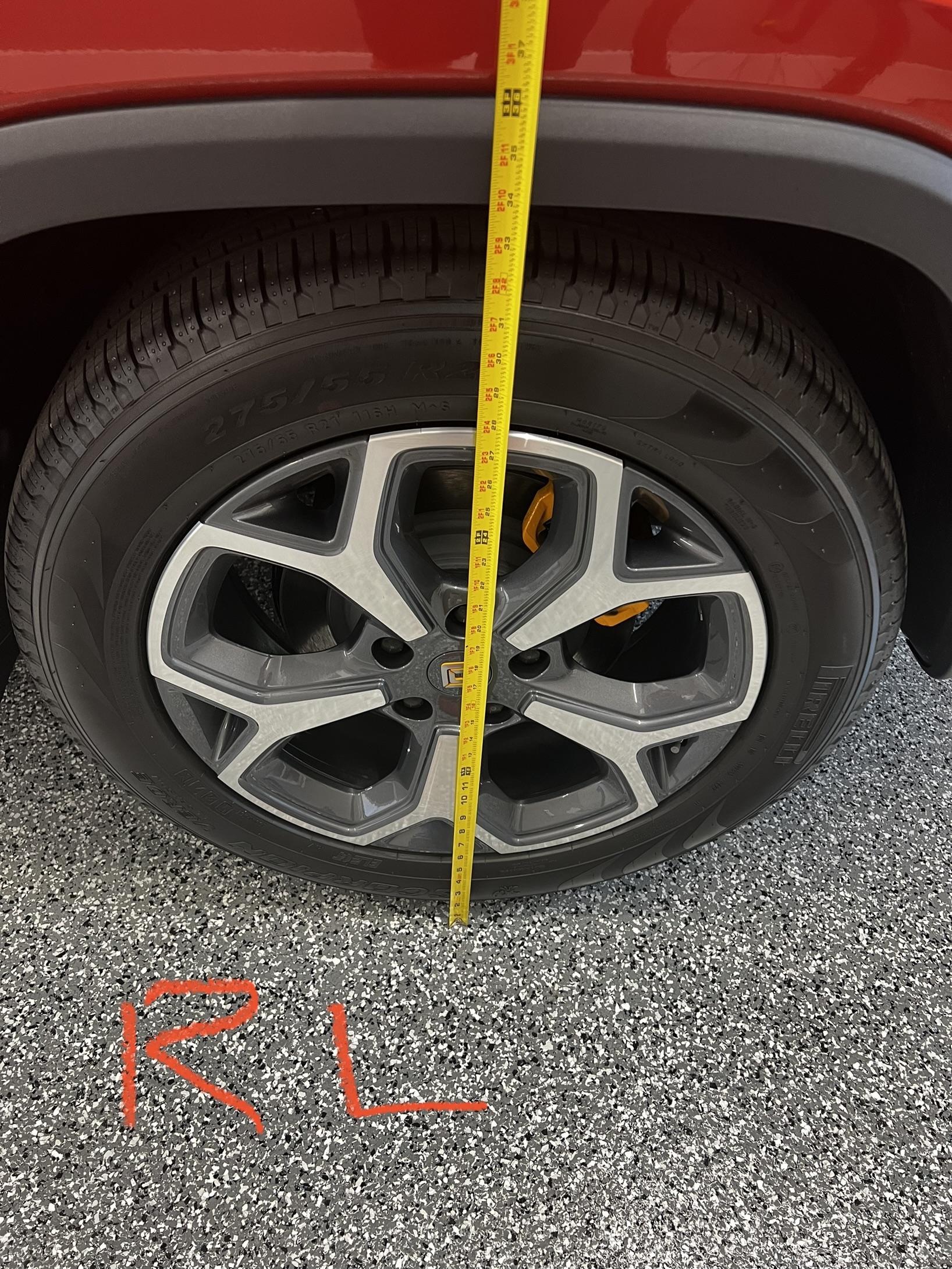

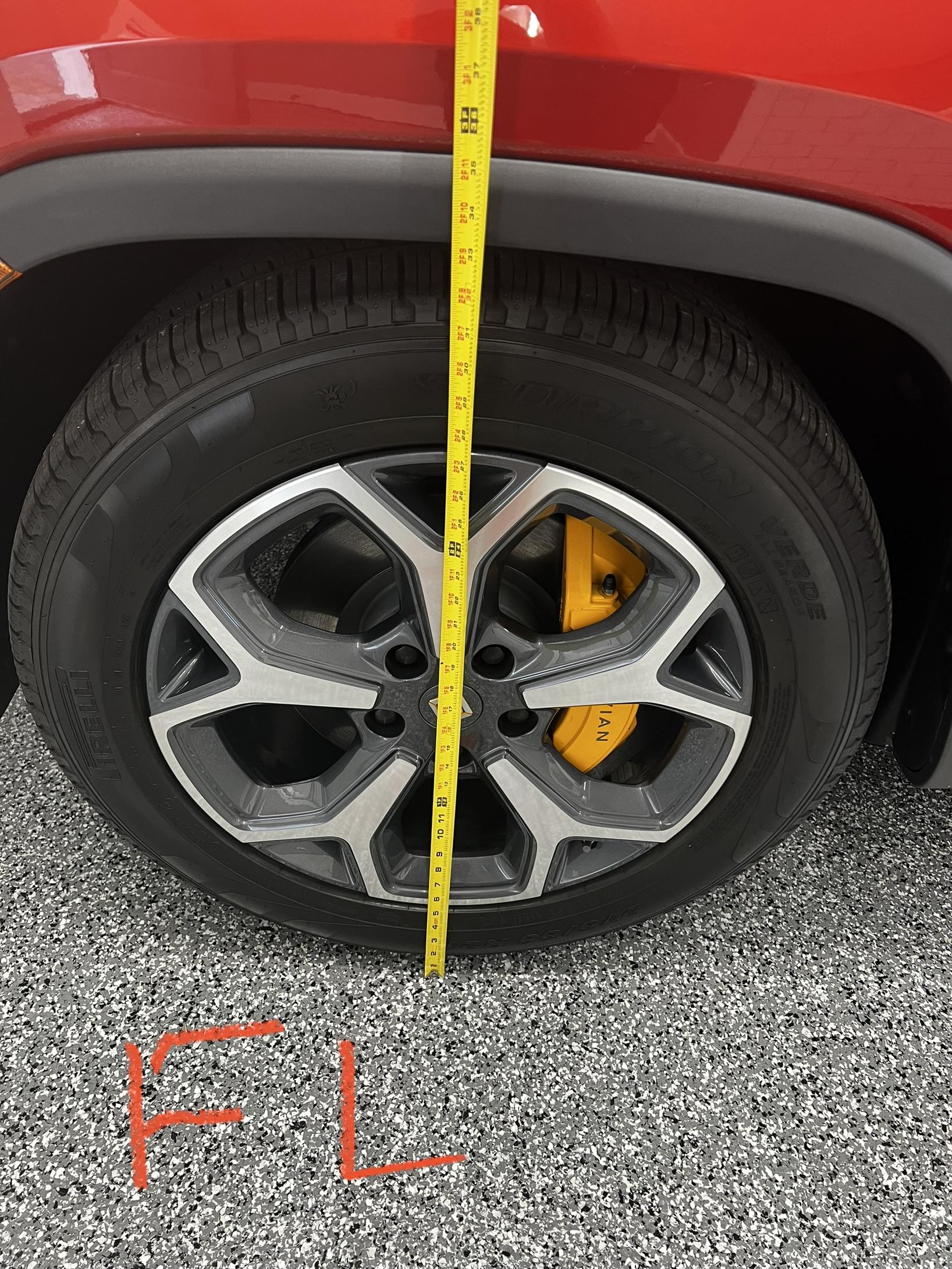

On my truck the driver side (both wheels) is about 1.5 inches lower. See attached pictures. The garage floor is level. If I park the truck in the same spot but just facing the opposite direction, the driver side sags the same way.
[/QUOTE
my guess would be, since they are both 1.5 low…it’s not an issue with one strut/sensor…it’s probably both. Have the service center take a look. I had the front pax sensor and strut replaced on the second SC visit…and that solved my issue. My front rgt was 1.5 low as yours…my rear was only .5ish…and that was just front rgt the truck leaning low and compressing the rear pax strut a bit. I had a tape measure in hand at the service center…I recommend you do the same. Good luck!

I think we have the same garage floor. Wombat? Mine was 1" lower but when I measured right after driving it was normal again.
My steering wheel is off to the left a bit while driving. If I let go of it the truck will slowly drift right. I have a service appointment for July 19th.

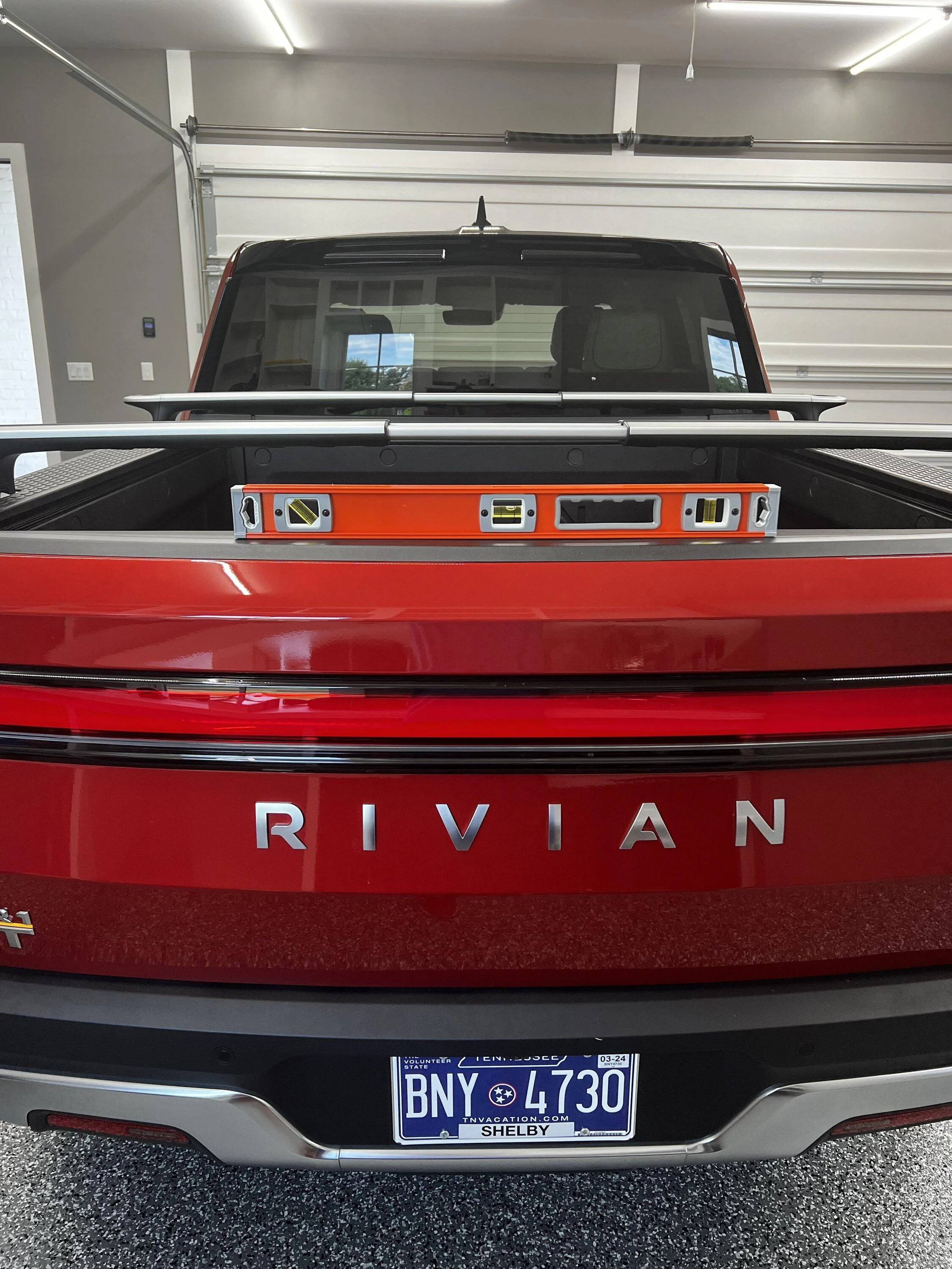

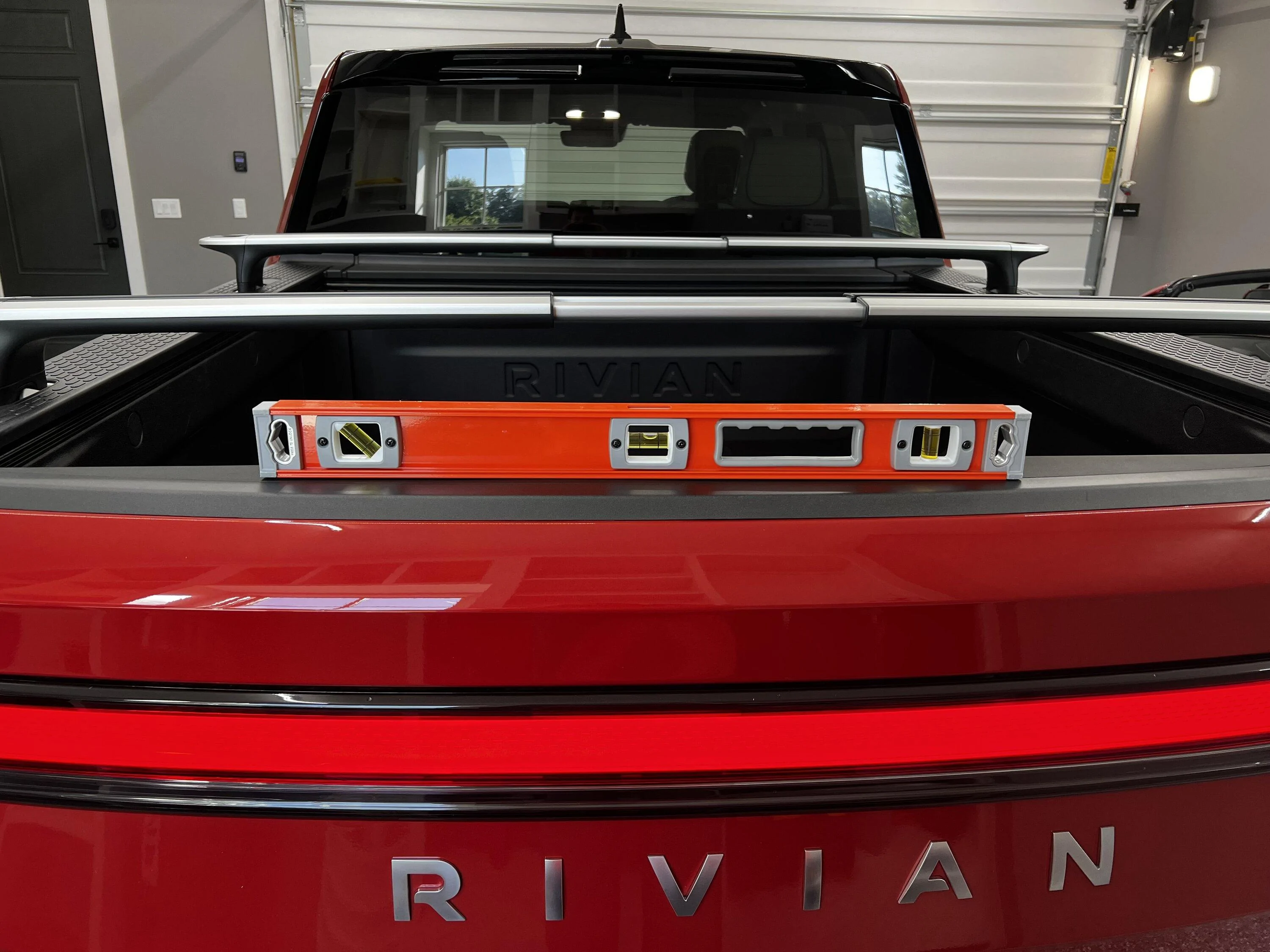

Someone gave me an idea to put the truck into "Camp Mode" to see if the truck levels. To my surprise it leveled itself in the garage perfectly. See the attached pic. I'm not sure what this means but it's encouraging to see that the truck can level itself.
Yes wombat. I like it.
Hope you get your truck fixed. That would drive in crazy.
Yes, I think it's normal for the truck to not be totally even after it sits overnight. But after you drive it stop and measure it should not be. Yes. We liked wombat. We just had ours done in early May. Still a mess...here is a pic I took of the aero cover with some foam strips attached....you can see the floor through all the mess.
