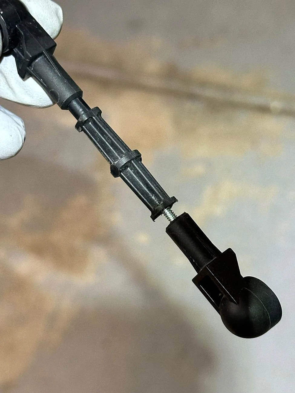

Here’s my solution. I cut out the necked down portion of the sensor arm on one side, drilled and tapped both ends with a 4-40 tap, cut the head of a 1" long 4-40 screw and... as you see.
My problem is as per this thread title - passenger side too low. I can screw the arm inward more by 5.2 mm. Hopefully that's enough. Will see and report.
There are variations to this too. If one does the same thing on the other side and taps it with a left hand thread for a left hand screw you get a turnbuckle. A bit of locktite will keep the turnbuckle from turning by itself and that design gives easy, on-the-fly changes in arm length.

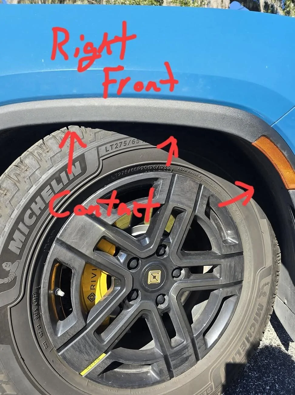

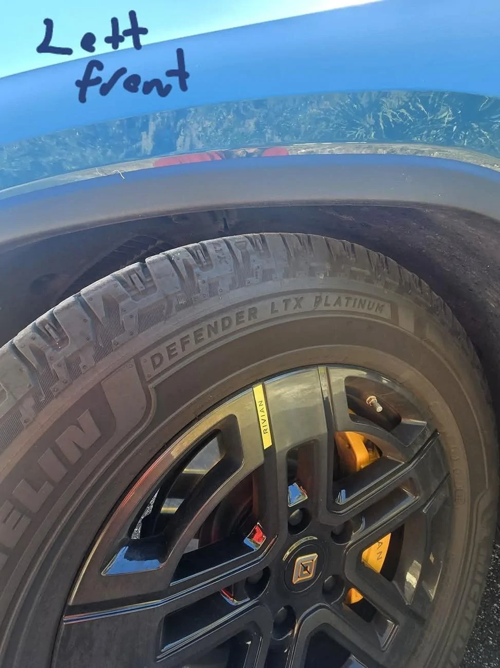

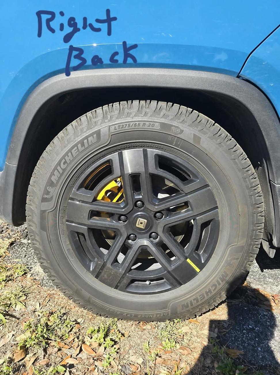

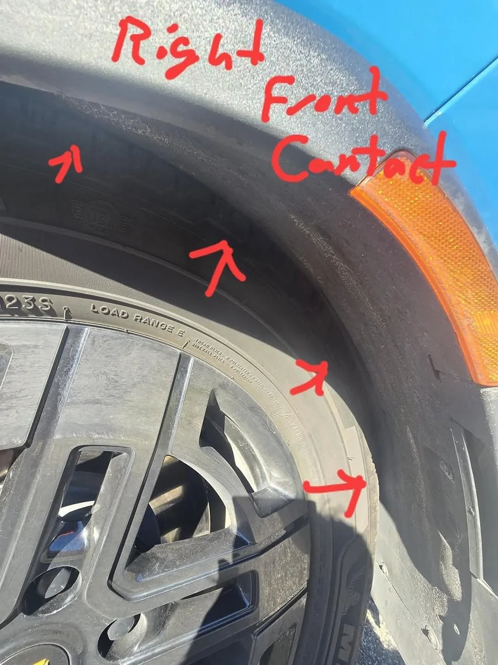

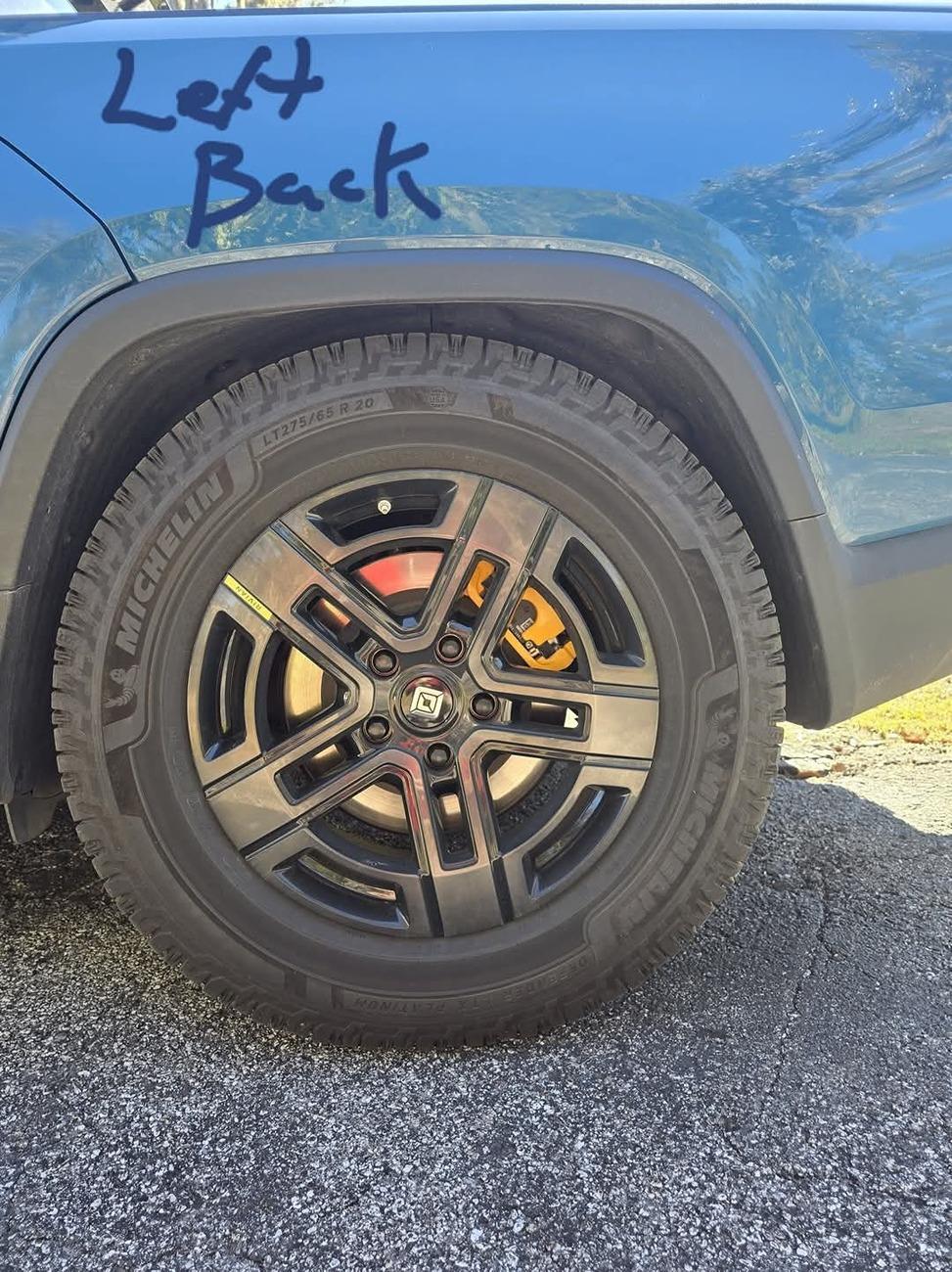

I have the same issue in mine, but with Defender tires it rubs. Service appointment in a month.
It’s probably an air leak. The service center found several leaks in mine. Several bad o-rings, and a leak in the air bag.
