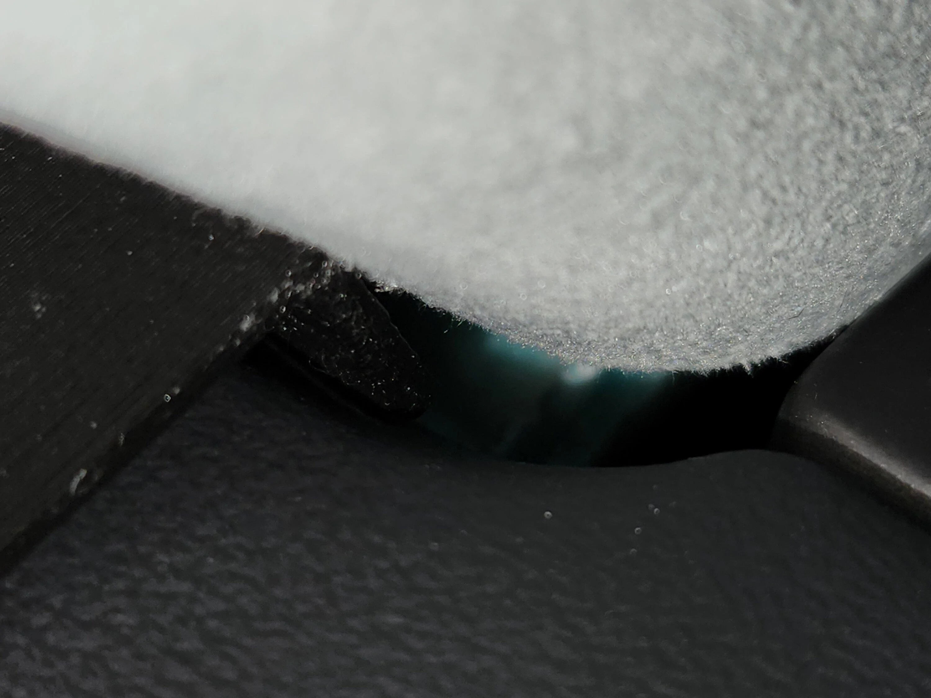

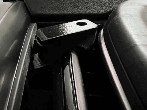

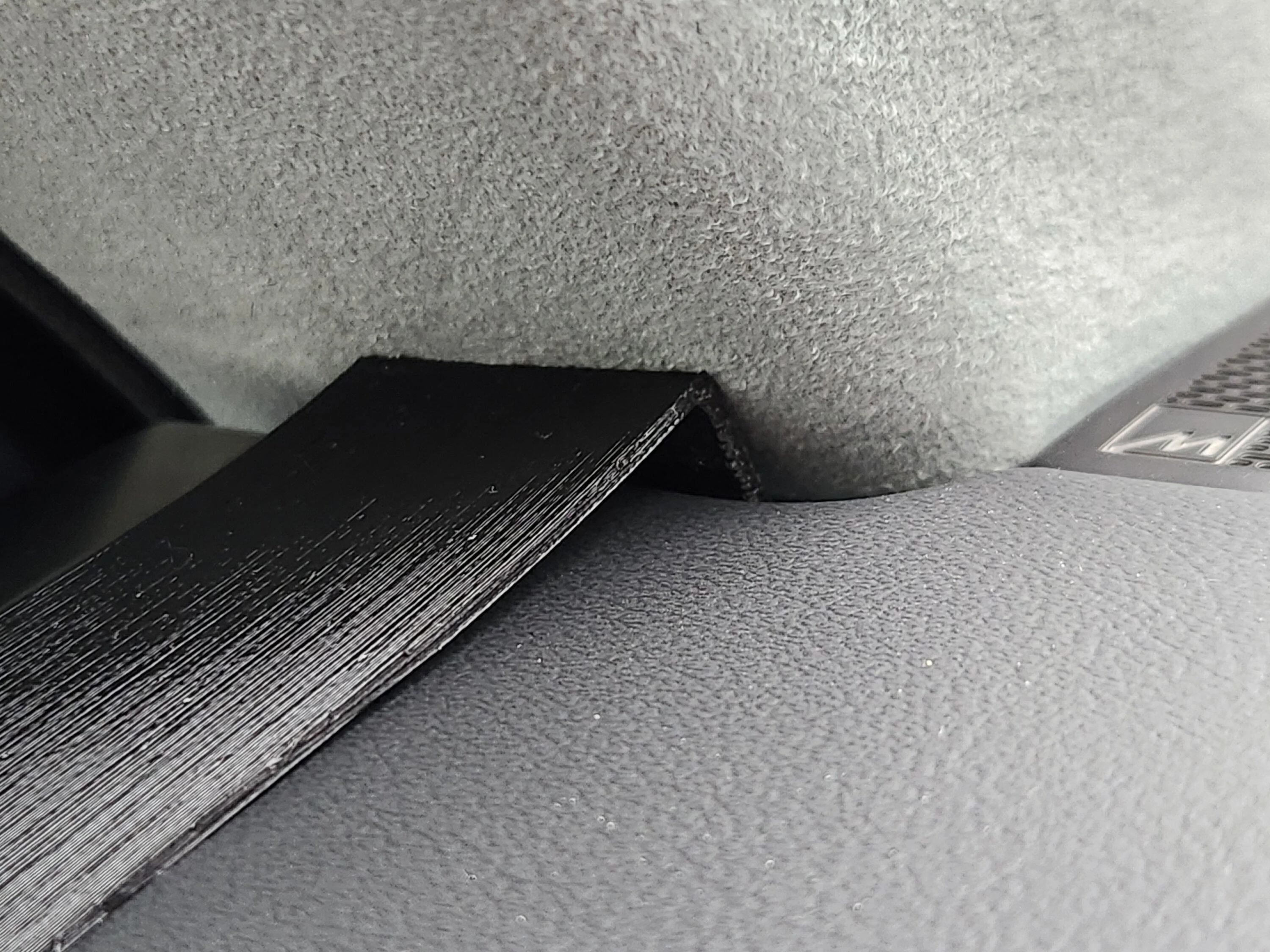

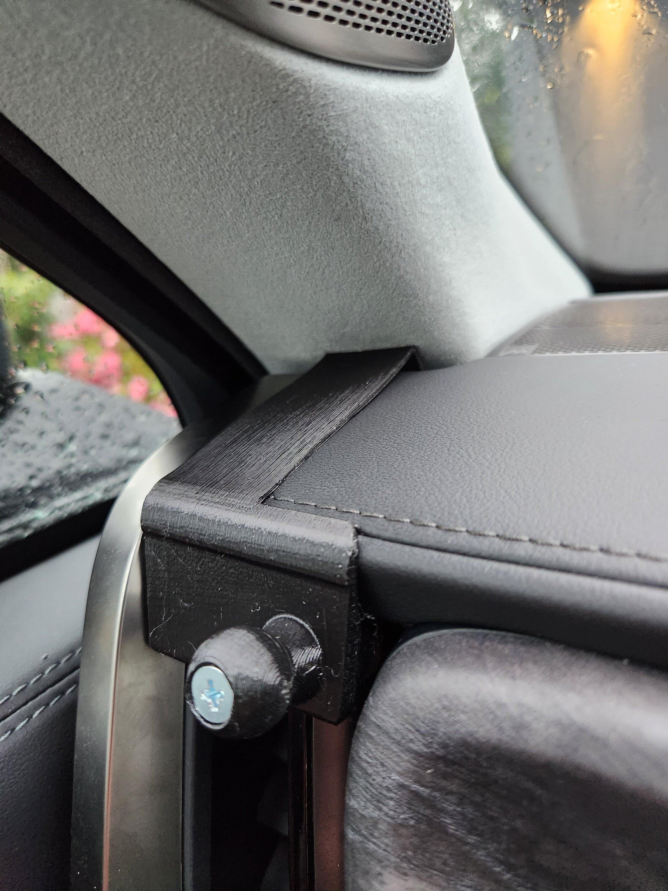

The arm that is supposed to hook behind the dash is just a little bit too short, resulting in it not sitting flush against the dash. Any chance it could be made slightly longer?
Nearly 100% of the time this is because the notch on the left hand side isn't inserted correctly. This pushes it out as you've shown here. I can see it needs to set a bit higher.
Rivian R1T R1S NEW - RIVIPARTS Left Side Phone Mount 1683594620798
If you look at the left of the base plate, you'll see it. There is a corresponding one on the bit with the hook.
Can you take a look at how you have it installed and respond to me in the ticket that you've opened? If need be, I'll replace the part.
Same with anyone else experiencing this. What is shown here is not how it's supposed to fit.

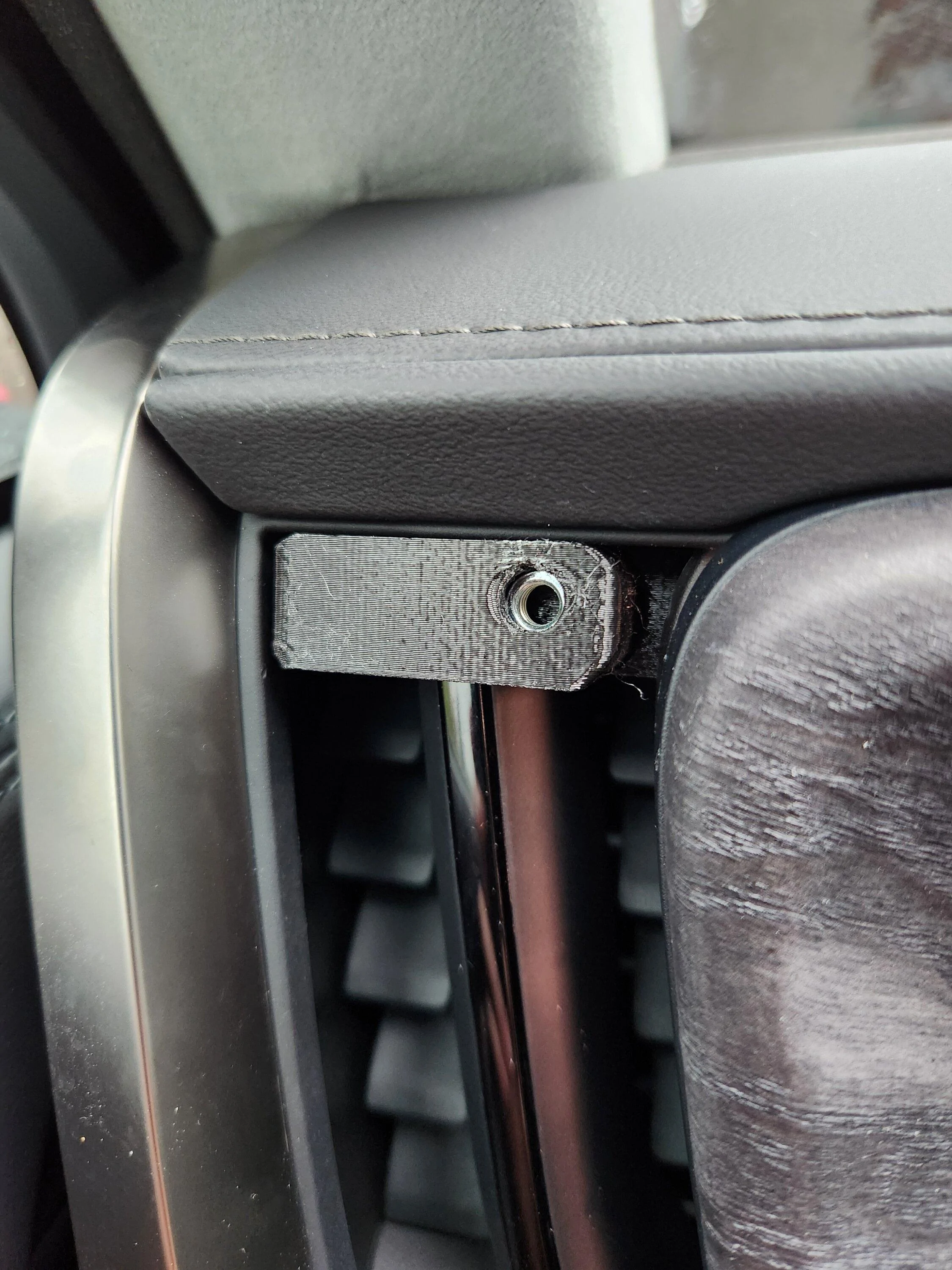

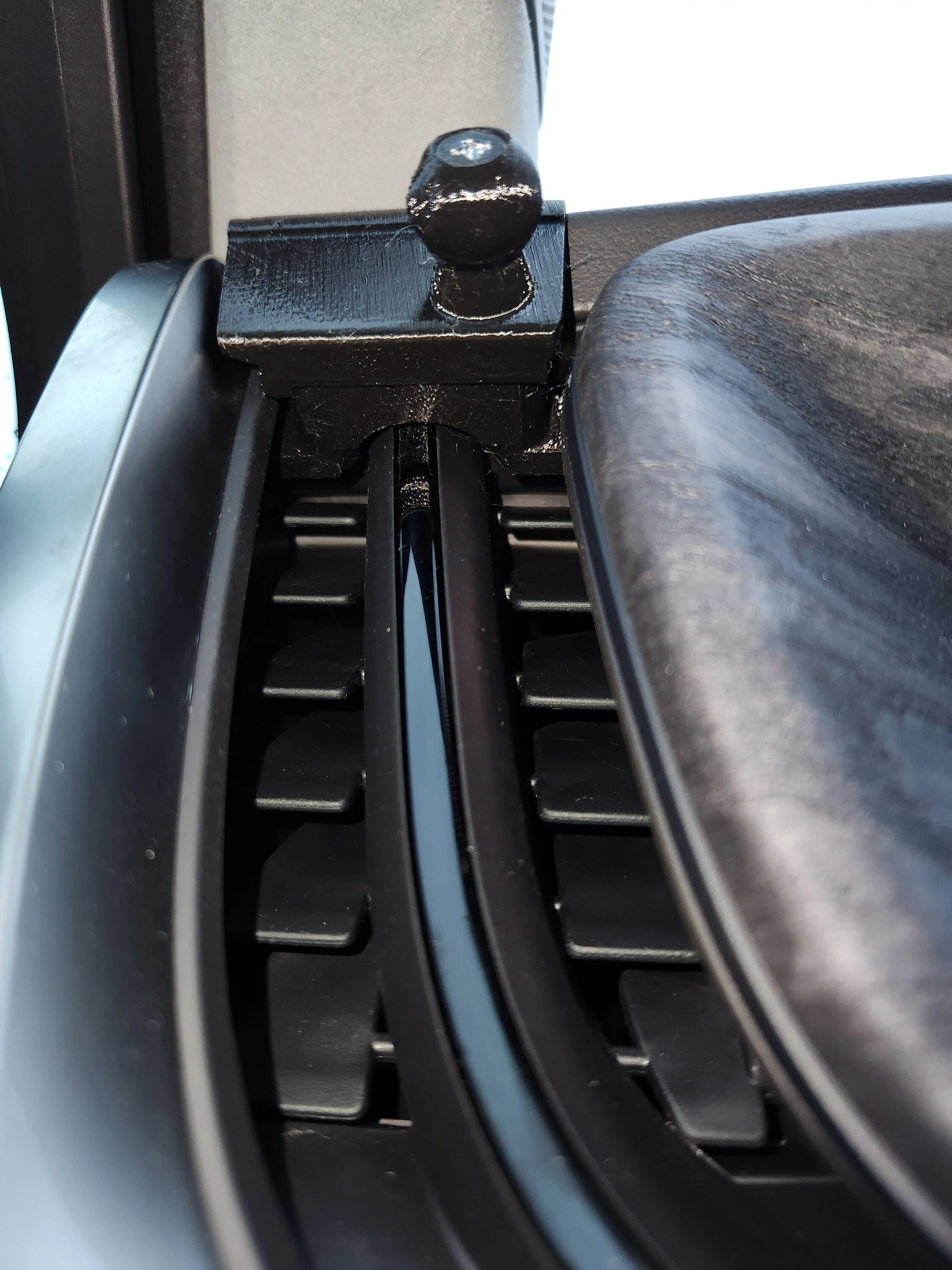

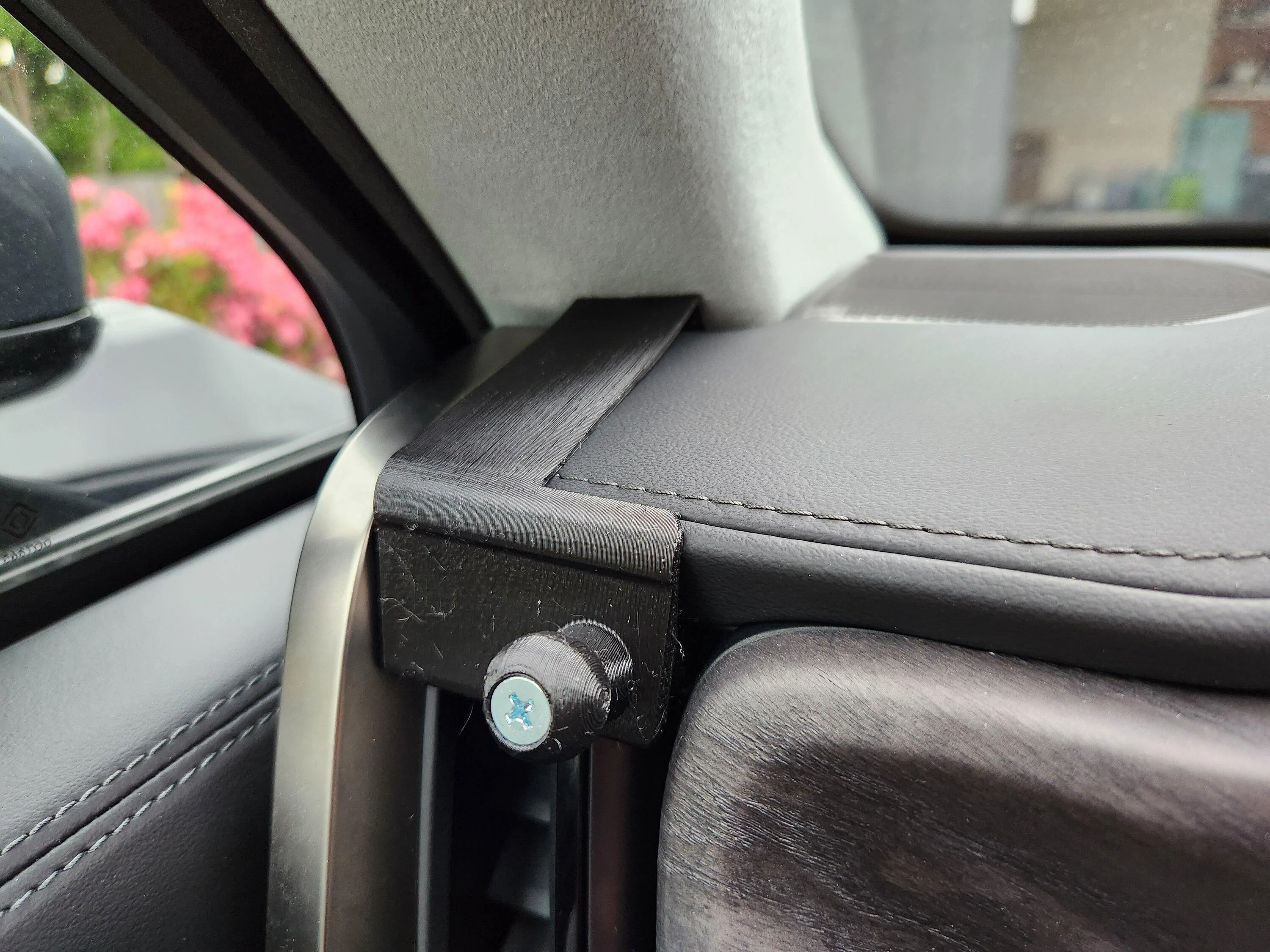

I double checked the anchor and it looks properly seated to me. The part that hooks over the dash doesn't seem to be able to quite reach behind and underneath. Perhaps there is some slight size variation between trucks? Also wondering if the hook portion is even needed, have you tried a version without it? Seems like with the screw tightened it would hold in place fine without it.

mine sits similarly to that. I don't believe it did when I first installed it and I haven't taken the time to mess with it to see if I can re-adjust.

Mine also does not fully seat along the a-pillar. I just thought that was how it was supposed to be.

That angle at the back of the dash cover looks a bit different to what I have. If you haven't already reached out to me using the contact for on OpenSourceEV, please do so. I'd like to send out a slightly tweaked version to see how it works for you.

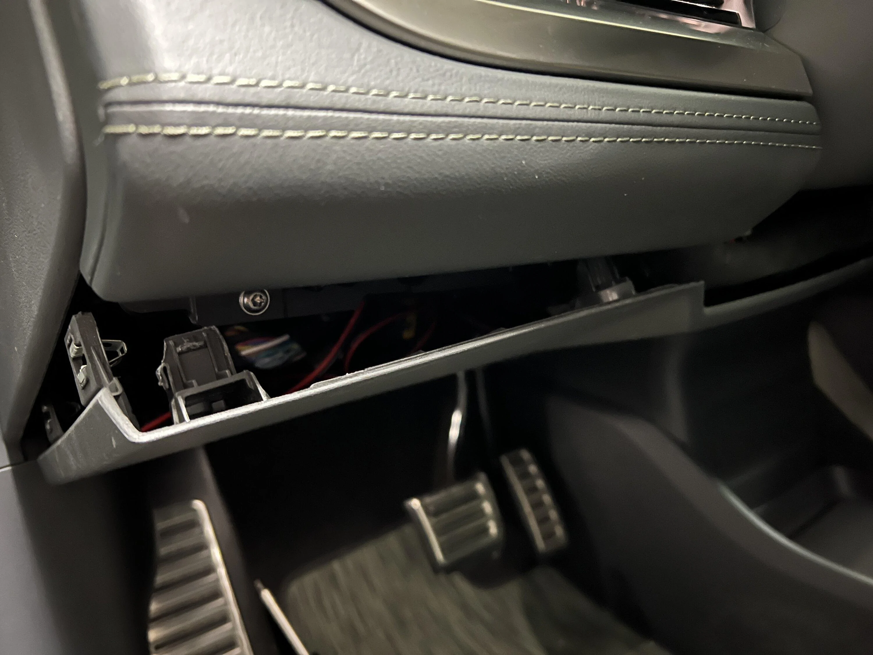

Install is super easy and it has a pass-though so it can remain installed. The OBD port is pretty high up in the drivers footwell, so unless you're rocking Ronald McDonald shoes you won't even be close to bumping into it.
I popped off the side panel and the left bit of the lower dash panel. From there, it's easy to feed the cable and wedge it under the steering wheel. There is foam there which holds it in place.
You can see the panel clips to the left and up from the bottom in this photo. The Scosche cable is in red:
Any know how to pop the side panel off? I can pull down on the clip, but worry I'm going to snap the clips on the side. Looking for any guidance how to safely pop the side clips to run the wires. Thanks in advance!
