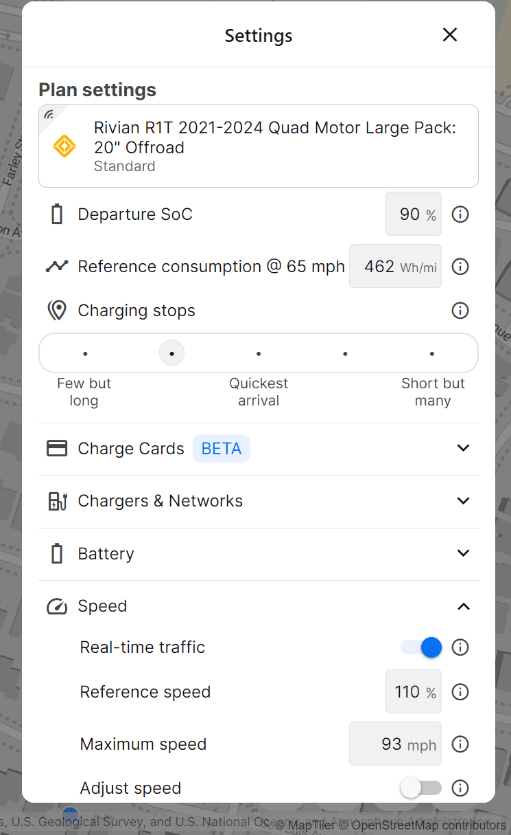

Since this is your first EV and it looked like it didn't meet your expectations despite using ABRP, I'm just going to ask if you adjusted the settings to ABRP. Definitely make sure the configuration of your vehicle (battery+motor+tires) reflect your configuration. Also change the speed to more accurately reflect your usual driving habits. Did you also know that you can change the estimated amount of battery when you arrive at your destination (you can also do this in the Rivian navigation)?
ABRP is a great tool, but your vehicle has the best information when it comes to how much range you have left. Don't ignore it for some EPA numbers. Just like ICE cars, they are not as accurate as marketed.
I had it set for correct configuration, I just didn’t have the right consumption number, and have since upgraded to premium and connected it to the car for live numbers.

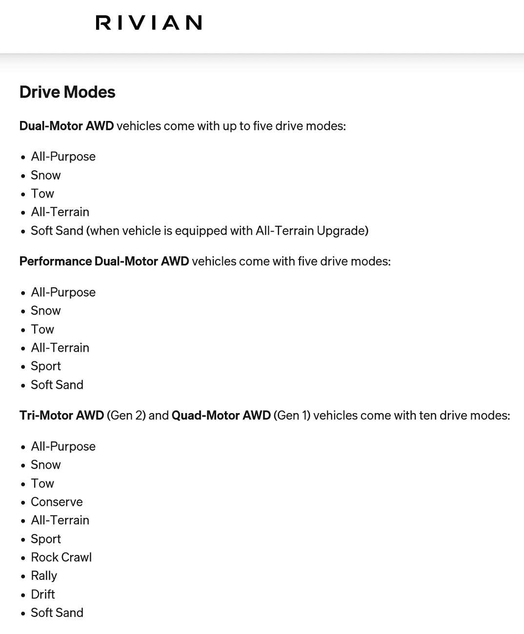

There is only 1 drive mode on the Dual Performance Max “all purpose“ I specifically asked when picking it up about “conserve mode” and was told the dual motors do this automatically now, no switching.
While you're correct, it does not have Conserve mode, it most definitely has other drive modes.
Ah, I see where I was mistaken, there is no conserve mode, and for options related to energy, the dual only shows “all purpose“ and “sport”
FWIW, you don't need a premium ABRP account to connect to your Rivian account and build a dynamic reference consumption number (and also reference speed number). You need it to see and do other 'real time data' kinda things, weather/traffic etc, but not reference consumption.
