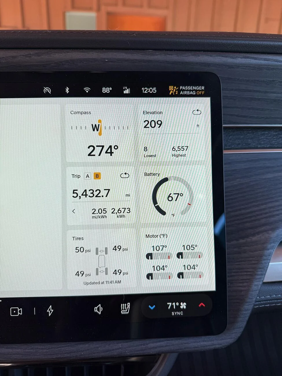

With AT Tires, you're doing pretty good...these are the least efficient tires Rivian offers. These things have the aerodynamics of bricks and speed, elevation, wind, ambient temp, and additional accessories will all greatly affect your range. What you posted above is in line with what others are getting. I have a Quad with AT 20s, and I'm only getting a bit better overall than 2 miles/kWh.
Although Rivian will look at it during your appointment, I'd be surprised if they fine anything out of line. As they say, "your mileage may vary."
Rivian R1T R1S New R1S Dual Performance Max AT Range issues tempImageprnJd1
