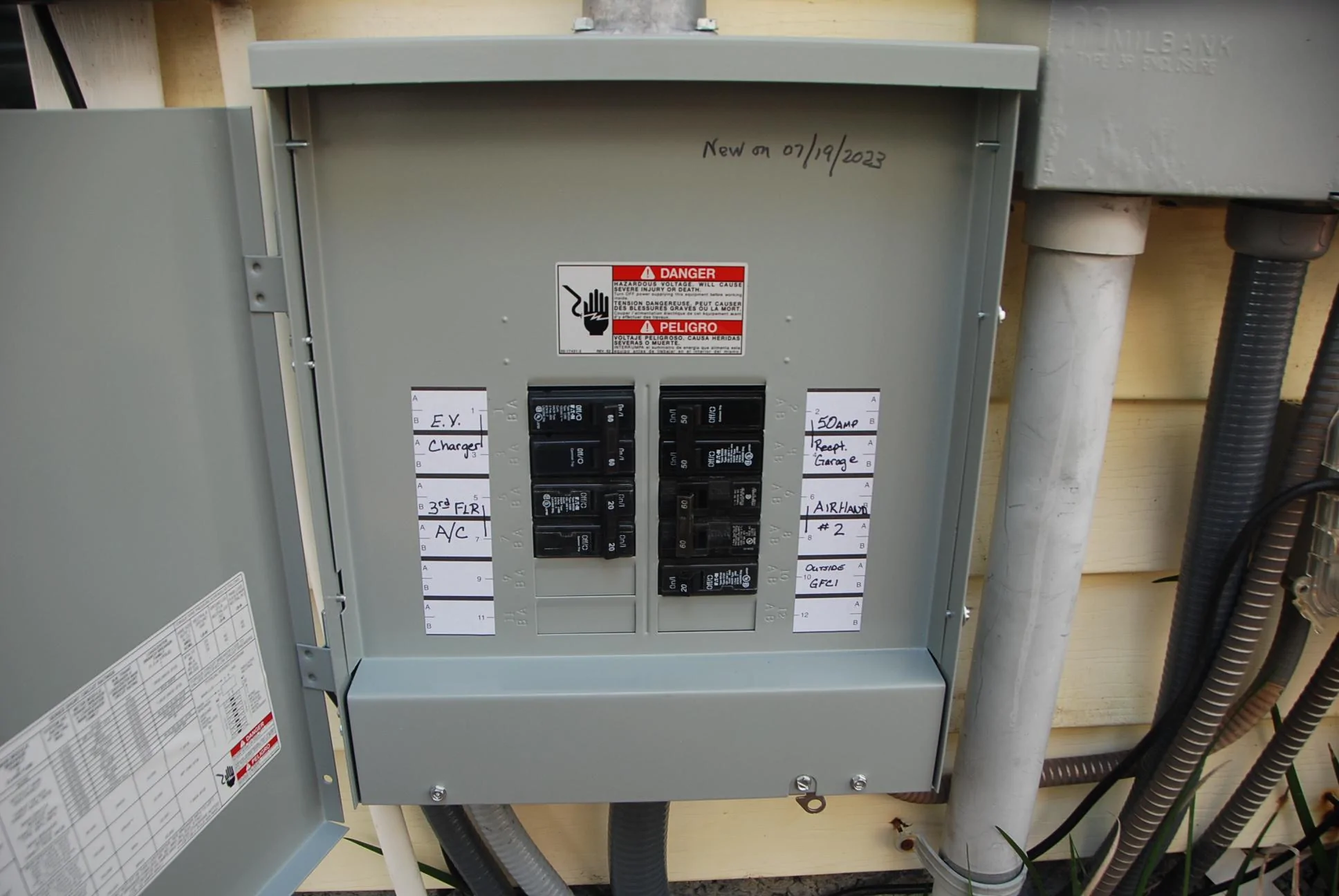

We just had our Rivian wall charger installed earlier this week. Our total cost for parts and labor was $3,500. About half of our cost was installing a new exterior circuit breaker box with enough space to accommodate the the new additional 50 amp and 60 amp circuit breakers. We opted to add an additional 50 amp outlet next to the wall charger.
We also have 200 amp service to our 3 story, 3,200 square foot house house. We use natural gas for our water heaters, stove, fireplace logs, and clothes dryer. We have three heat pump a/c units and a 30 amp outlet for our Airstream Travel Trailer which is always plugged in when we are at home.
I would definitely get a second opinion on your electrical issues. Please let us know how this turns out.

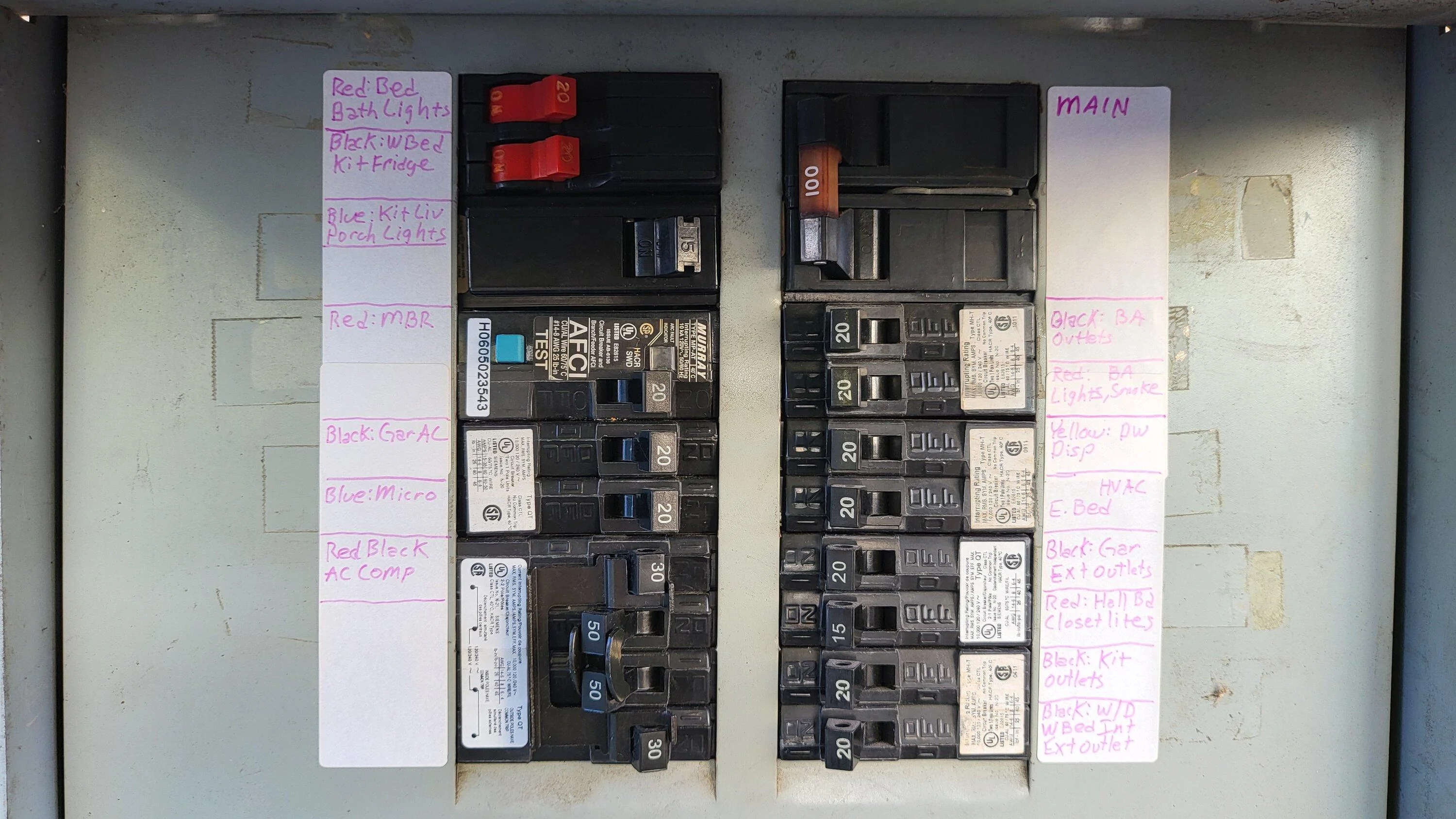

My panel is heavily oversubscribed but it means nothing unless there's a load to exceed it. At night, not even my AC is running so the whole panel is essentially idle. Breakers are there to protect wiring and are not an indicator of load. After doing a load calculation spreadsheet with the EVSE figured in I'm still at 80A ampacity. The panel can't physically take bigger than the 50A for the EVSE but it's a gift to be able to have that much without a panel upgrade thanks to quads.
