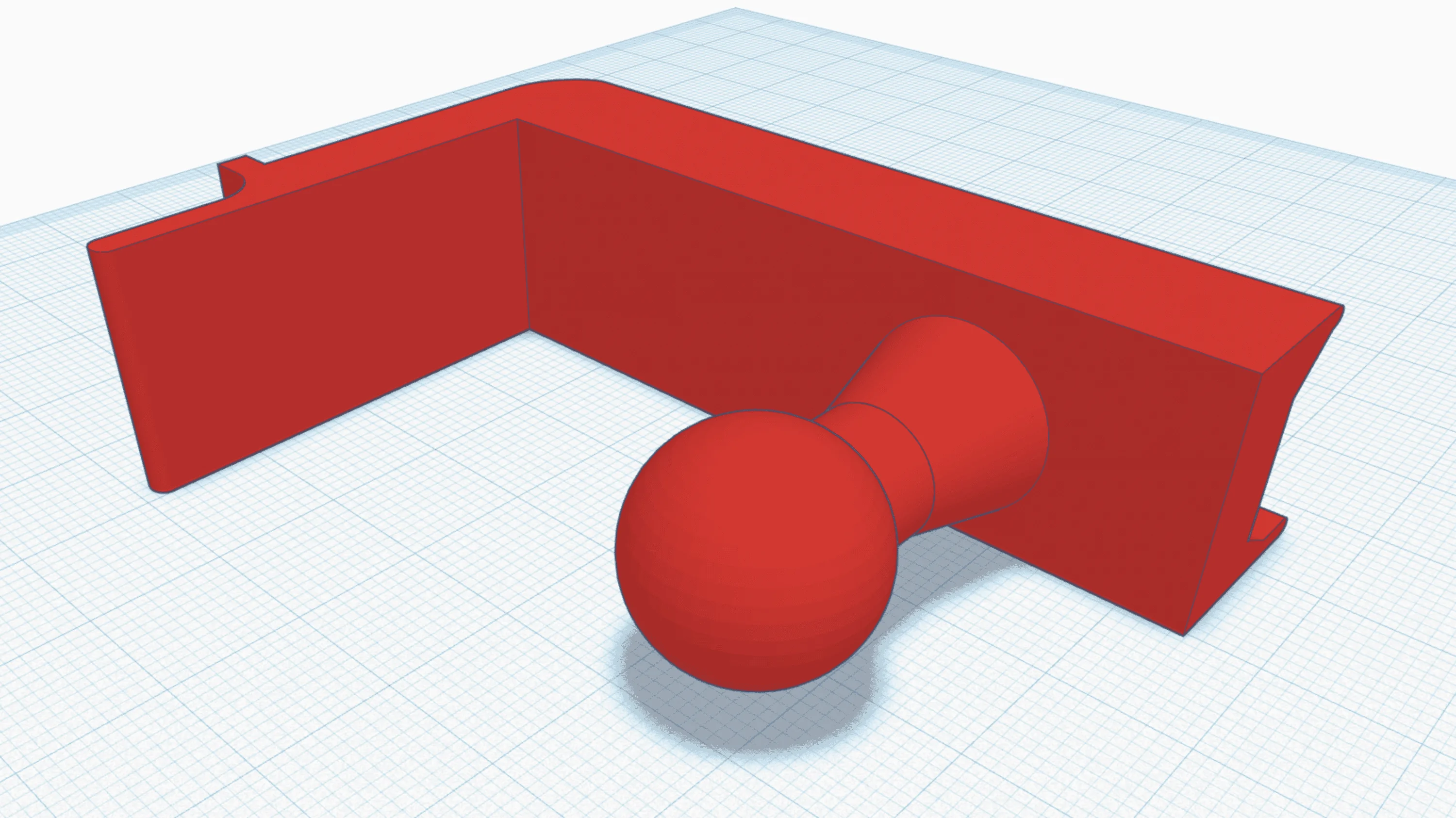

I can do a 1" ball. Can you point me toward what you want to hang off of it as I may need to tweak the design just a bit.
Update:
The next batch of these will have a few changes:
  • The ball size will grow just slightly to ~17.2MM from ~17mm. This is to better size it with certain mounts. I'm going to print one of these and check with the three different mounts that I have here.
  • I've tweaked the location of the ball to be slightly more elevated on the L mount. This should help with the production issues with the last run. The issues seem related to the supports needed for the ball and it being too close to the deck to detach correctly.
The mount that I showed earlier was this one, available on Amazon. This one looks close but with not as much movement.
EDIT:
I have it done, but it's ... uh ... huge. I can upload it somewhere, but I'm still not certain if it's going to be remotely close to what people are looking for. As you can see, I really had to shift post holding the ball up so that this guy would be printable.
EDIT:
my goal would be to put a short to medium arm + the peak design ball mount to this to give it a bit of height over the steering wheel
That's what I want to do as well. Unfortunately extensions that take 17mm balls on each end do not seem to exist.

This will work perfectly for my set up (mous case with a mous magsafe charging mount). How can I order a 17 mm ball mount?

Update:
Just got around to installing the original part yesterday. With the Belkin Magsafe charger I have, the phone sits pretty much right behind the rim of the steering wheel and mostly isn't visible (I can see the top line of directions if I try to use waze, but nothing else). Maybe I should have used the mount you posted, but I wanted a charging mount.
