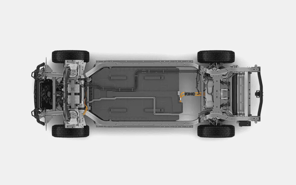

What's the evidence that there is room in the existing pack to add cells for max pack?
CommodoreAmiga
Dec 30, 2020
4,104
7,729
INACTIVE
INACTIVE
Look at the existing pack and frame... There's room to extend the pack.

crashmtb
Jul 11, 2021
4,727
7,242
Man oh Manitoba
If you compare this picture to the same one of the R1S skateboard, thr pack is the same. The R1S has the large pack.

The graphics made from pre-production CAD drawings do not represent the truck they produce. Look at the pack Munro disassembled and compare it to the drawing you posted.
There may be space in the frame for a pack longer than the large size, but I haven't seen it. The alternative is that Rivian is using the space under the second row of the R1T, and the third row well on the R1S, for the extra cells.
I didn't see a gap when Munro showed the rear suspension. Perhaps Munro will show the frame with the cab removed.

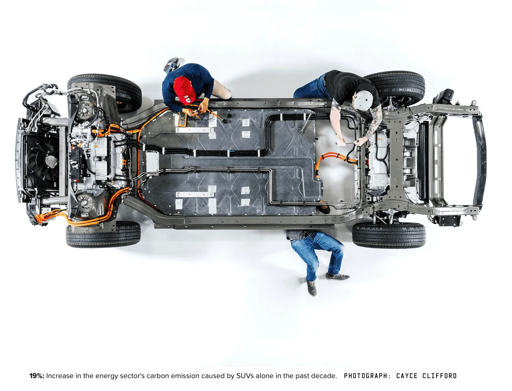

next you’ll say the bare skateboard they display at their factory delivery centre, which is identical to the rendering, isn’t the same pack either.
You’re saying the current large pack takes up the entirety of the chassis space In R1T? if that’s the case then the R1S must have a smaller battery now.
here’s an actual picture of an R1T skateboard with the ”large” pack

Do we know the pack size in the photo?
Large pack is 9 modules. Max pack is 12. There is only room within the R1T frame for 11 modules. 12th module is sitting on top and takes up the space under the rear passenger seat.

Is the Meridian subwoofer under the rear passenger seat? Is there room for both module 12 and a subwoofer?
155
14,046
28,734
Sorry, I meant the driver's side. IIRC the subwoofer should remain in place just fine.
