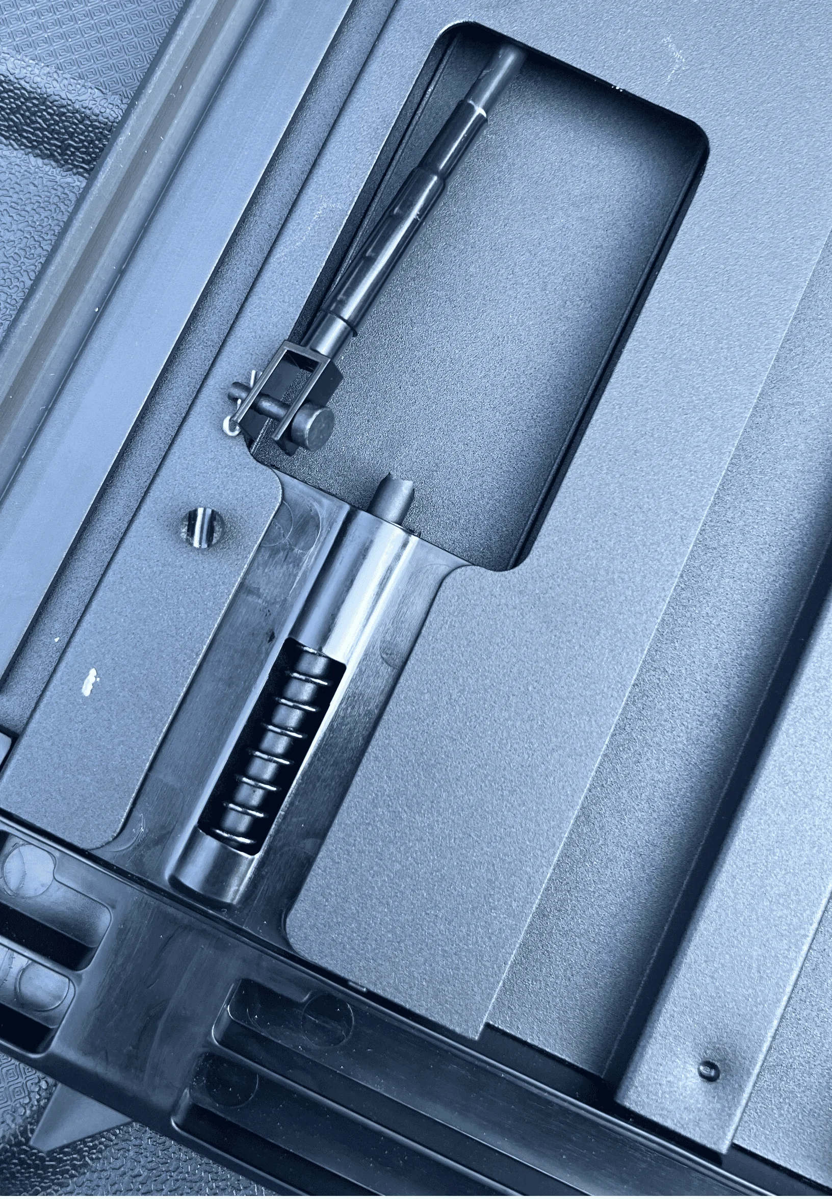

OK, I give up. Still waiting for my manual tonneau, but having lots of second thoughts. Can this thing really be as bad as some say? Seems to me, if it is, surely Rivian would have done something about it, right ☹ Don’t answer that ?
Anyway, would spraying the latching pin mechanism with some silicon spray help the situation? When the pin breaks, is it repairable with something like Super Glue (yeah, I know, kinda Mickey Mouse, but…)? Is the locking pin actually necessary to have the tonneau be functional? Doesn’t the closed tailgate keep the tonneau secure? If so, why even have a locking pin, to begin with? Anybody have a picture of the broken part? I’m trying to visualize this whole thing.
Here it is... as you can see, the shaft portion of the locking tang is plastic and too thin for the size of hole required for the clevis pin which makes it very weak around the large clevis pin hole. It snaps at it's weakest point when pulling the unlock cable. No way to glue it back into working condition. For an $800 - $1,600 item, they could have used metal for the unlocking tang/shaft.

So who is going to be the hero to create a low cost all metal replacement for the locking bits??
I'm thinking some motorcycle brake cable and a lathe can make this problem go away
Exactly. Is the pic that Rob posted pretty much what is happening to others? Is that the weak point or are there other failure points? I’m assuming the whole mechanism is plastic? Jeez, how frickin’ difficult would it have been to make these parts out of metal rods ?
Back to my other question - is the locking pin even necessary?
Yes, that is the point where the installed covers are breaking.
The ones that got damaged during shipping broke at the plastic endcaps.
Short answer would be no, plenty of non-locking tonneau in use or ones that use the tension of closed tailgate to stay in place.
I would imagine the locking pin is useful for bed being open or maybe ensuring a better seal between panels
