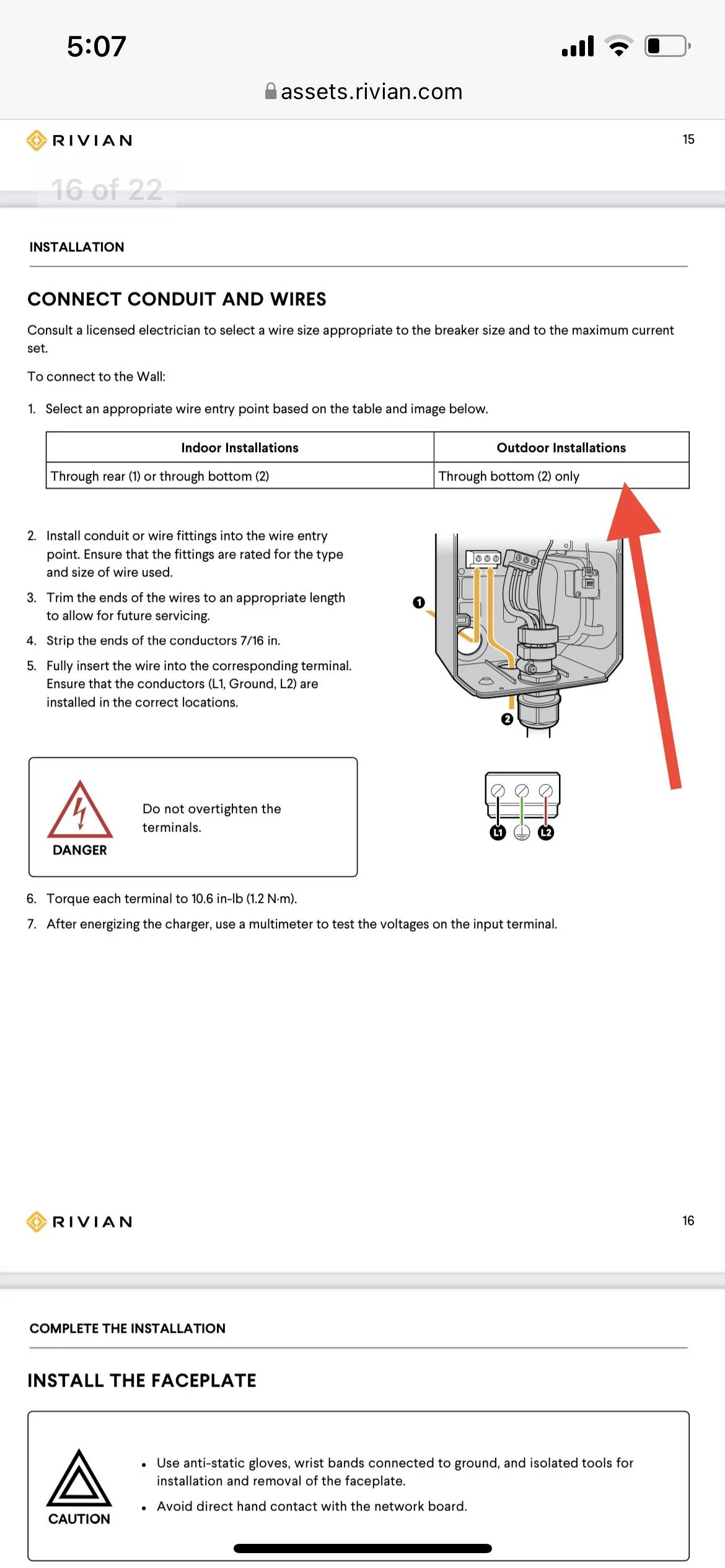

Hmmm interesting. The installation guide says outdoor installation must use the conduit knockout on the bottom, not the back….
whoops, I did run a extended conduit inside. I'm planning on relocating it on the other side of my garage.

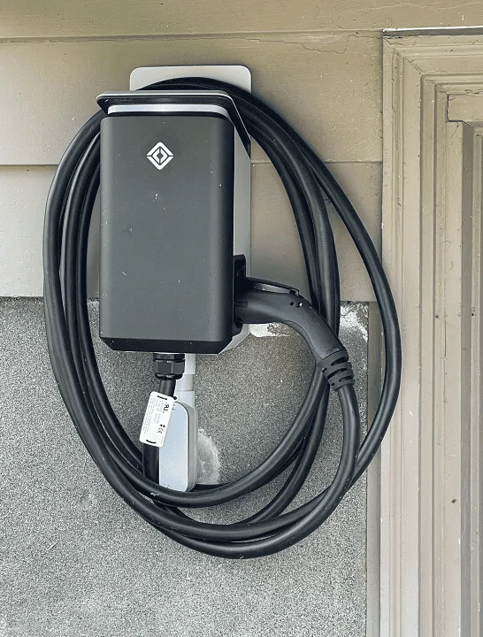

Rivian R1T R1S Installing wall charger outside vs inside 1655908431802
Why oh why didn't the designer have the J-handle sit at a down angle in the storage area so that water will naturally drain down off the J-handle vs. into the storage hole where it will freeze in place during the winter and possibly corrode the connection pins over time?
Also, with the trigger button exposed, water will get in that area and freeze and or cause corrosion too.
Pro tip... sometimes it helps to have someone who's designed something that has actually been produced and deployed help or at least provide input to your design plans.
Very poor design...

FWIW... Clipper Creek makes a very well designed and executed J1772 holster that protects the J-handle connection pins and the trigger button from the elements. I've been using one of them for a couple years exposed to the elements and even ice and snow have no impact on the J-handle due to the protective design of the holster.
