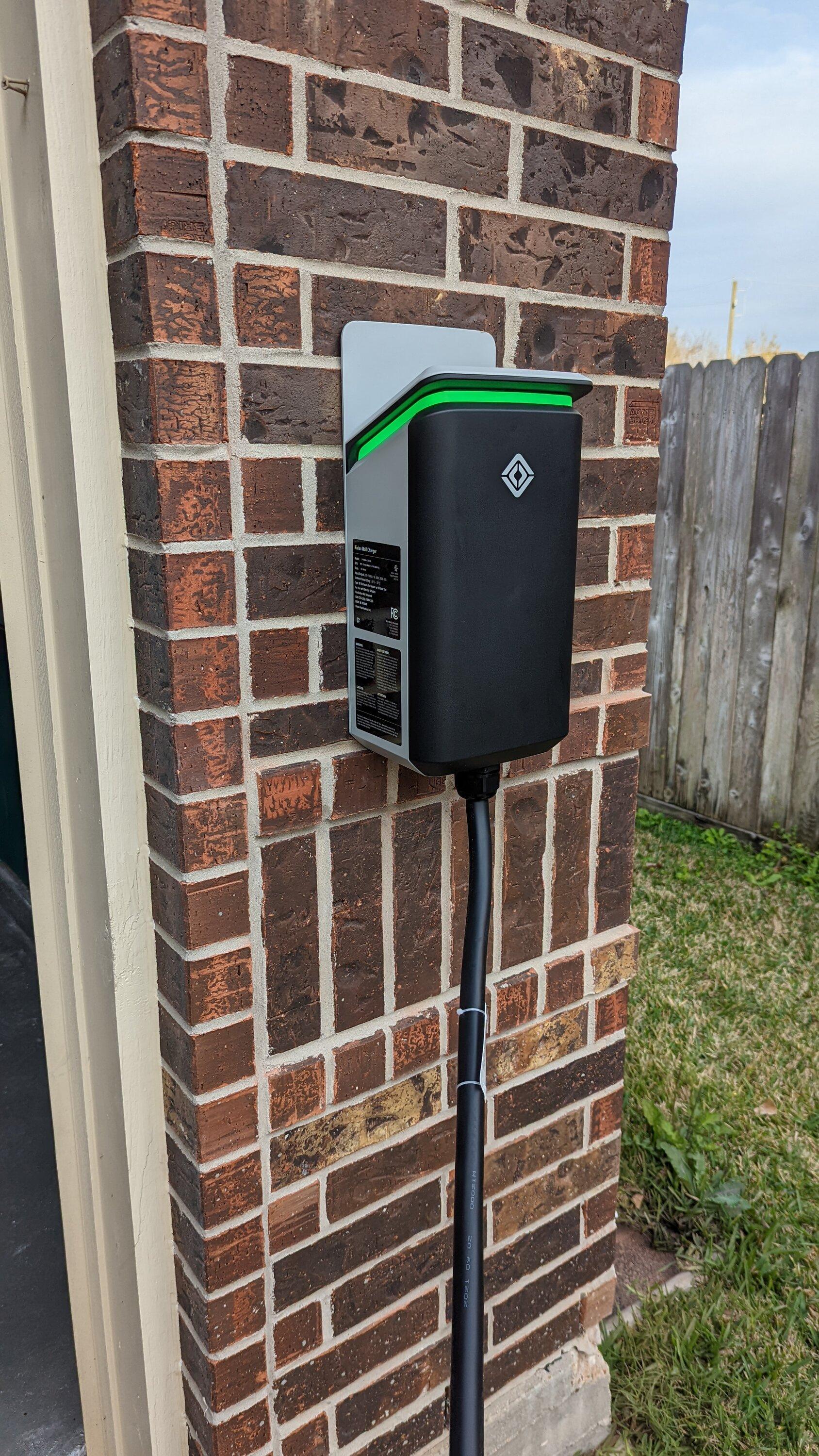

Here’s mine, next to the garage door under the deck. Not in the photo- a security camera right over the garage.
