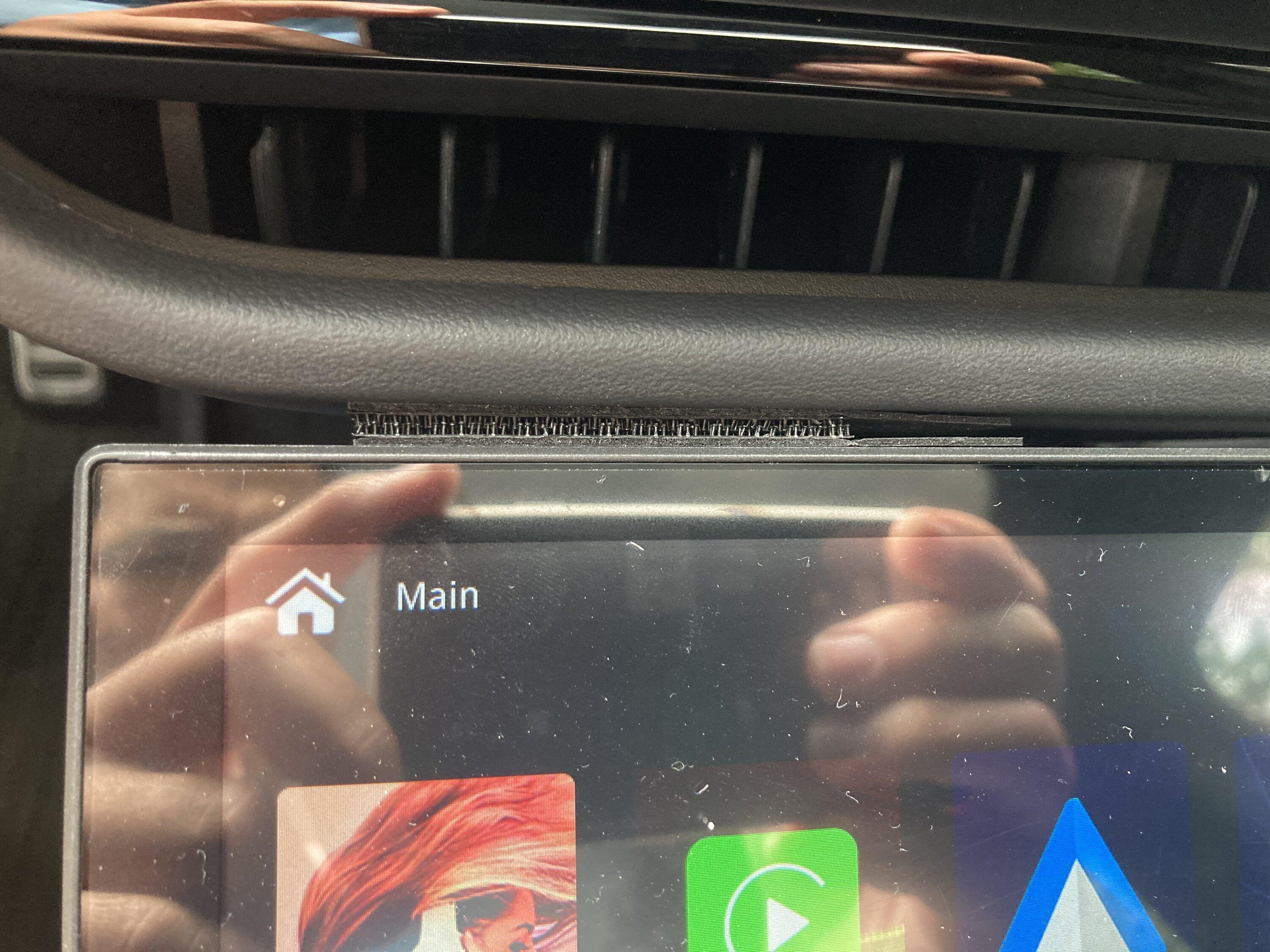

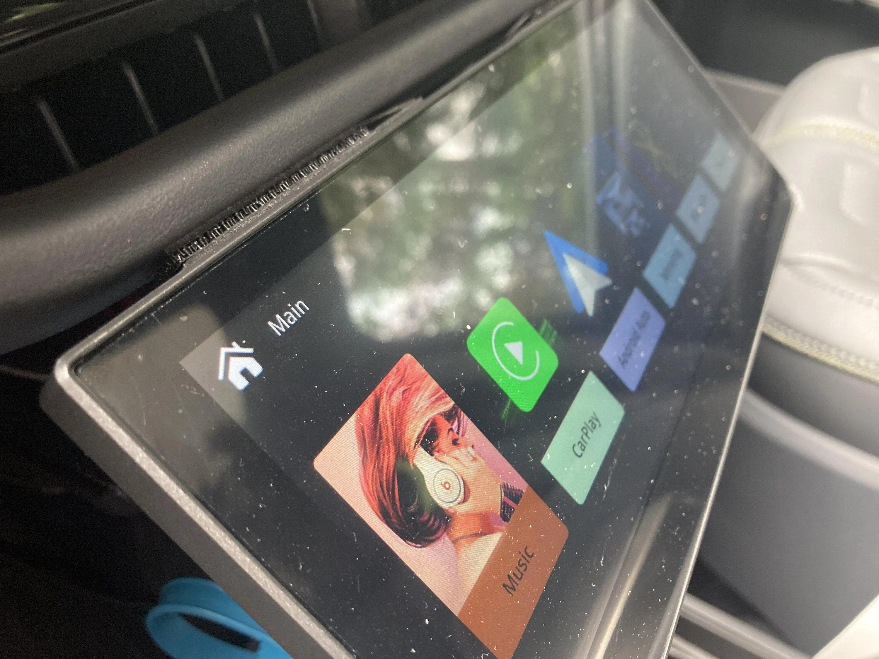

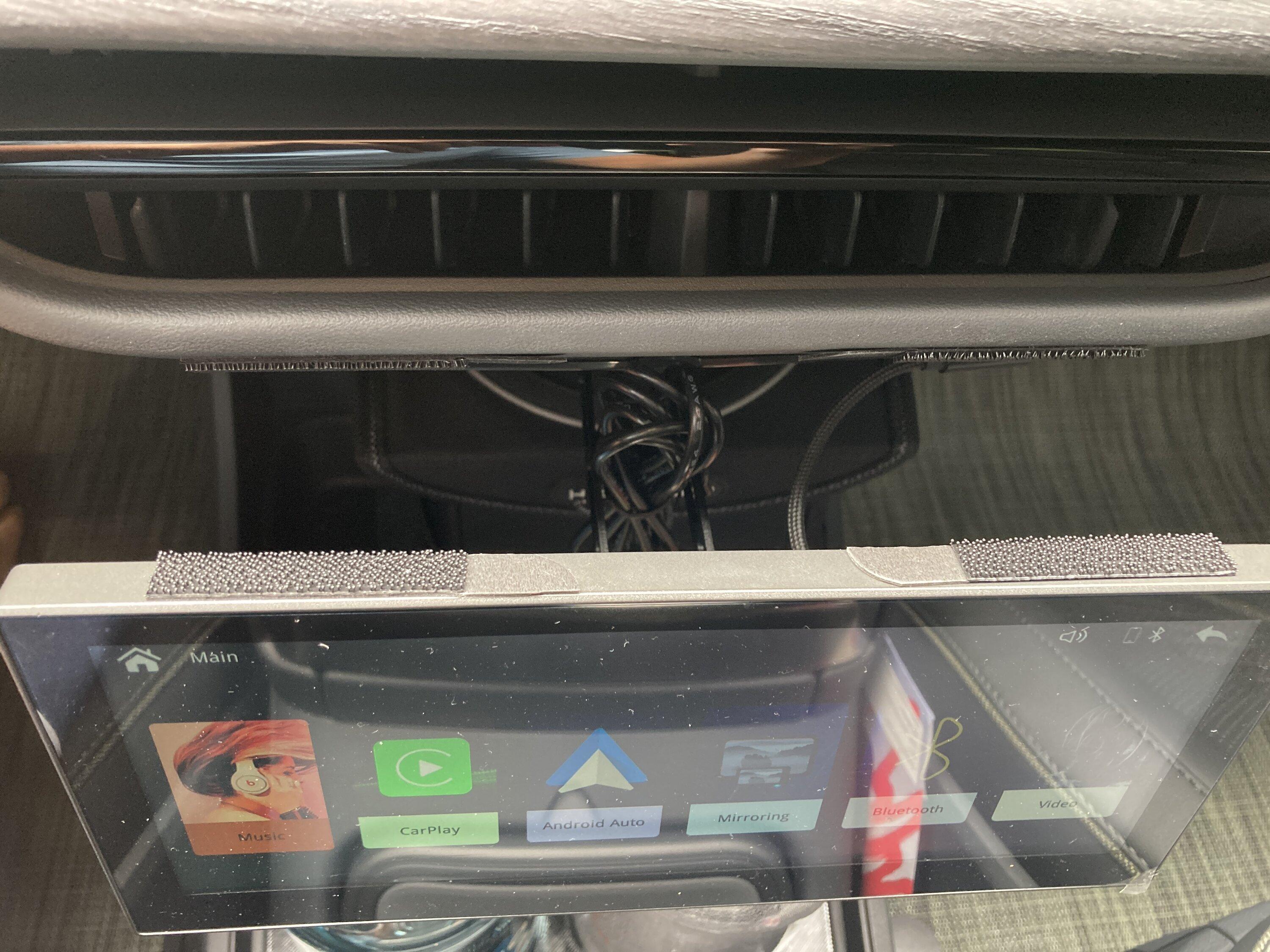

Awesome! It’s been working really well with the exception of the Bluetooth connect/reconnect. I also replaced the top mounted magnet setup with 3M Command Velcro style strips. The large black ones. Just cut it in half longwise. Better than the magnets I posted earlier.
Any chance you could show a pic of this?

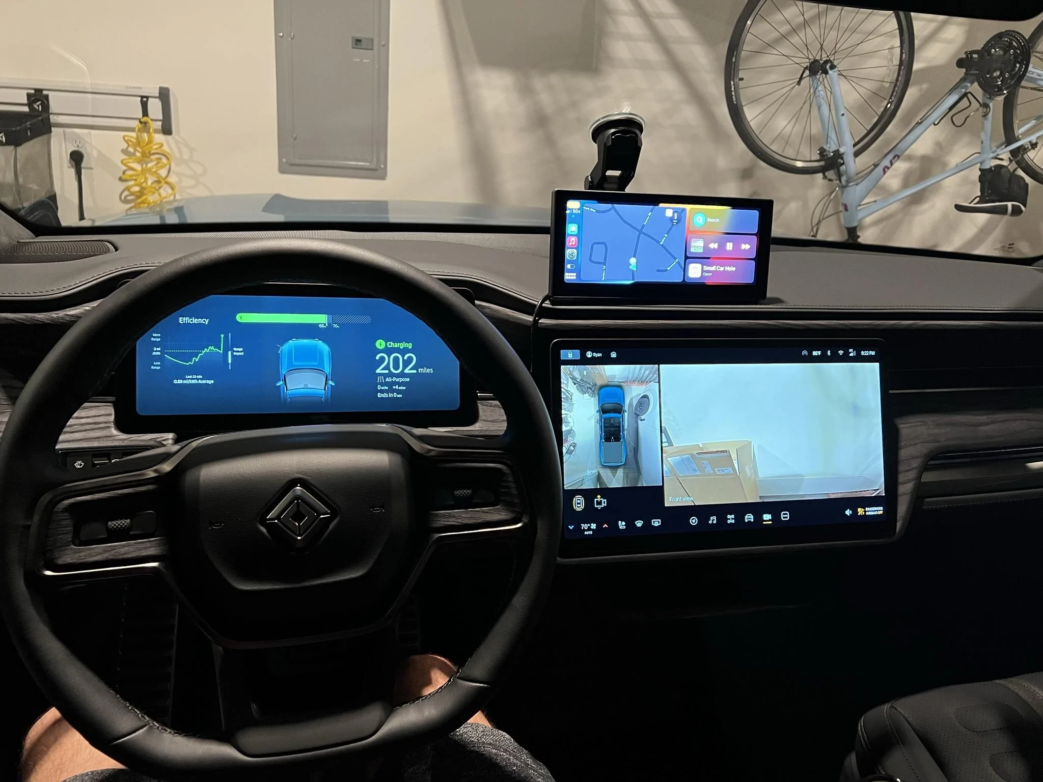

As we all know, Rivian in their infinite wisdom believes they can build a better software experience than Apple or Google for in-car infotainment. As an owner I can now definitively say at this moment and for the foreseeable future that is not true. They simply lack the market presence and development resources to target all of the possible media and navigation applications their customers want to use. I know I am not alone in this analysis, and like many I am constantly petitioning Rivian to add CarPlay and Android Auto support. However, I'm not waiting around crossing my fingers for it to happen.
I purchased and installed the RoadTop 8.8" display. It is a Linux-based standalone and portable media unit typically used to add modern features to older vehicles, or in this case a brand-new, modern truck built by a new company with too much hubris. It has a wide screen display, which I prefer over the typical 4:3 units. It supports both CarPlay and Android Auto, wired via USB-A or wireless. It can connect to the vehicle's sound system using three different methods: an aux jack, an FM transmitter, or a bluetooth connection. It is powered by 12V. The design is better than most, though not perfect. The bezels are large, and it has a bit of a "chin" like an iMac. The screen resolution is also low (1280 x 480), but it's readable. The price is reasonable in my opinion at $290 shipped. It does come with a camera which is a waste in this application. It would be nice to see a SKU without it for a lower price.

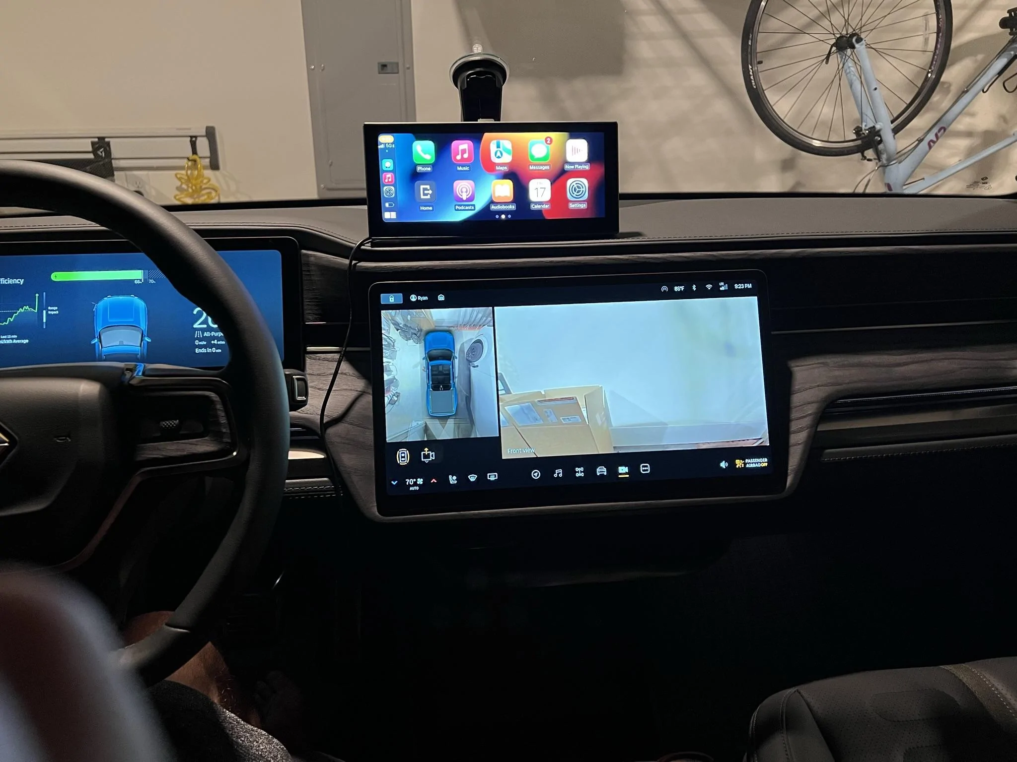

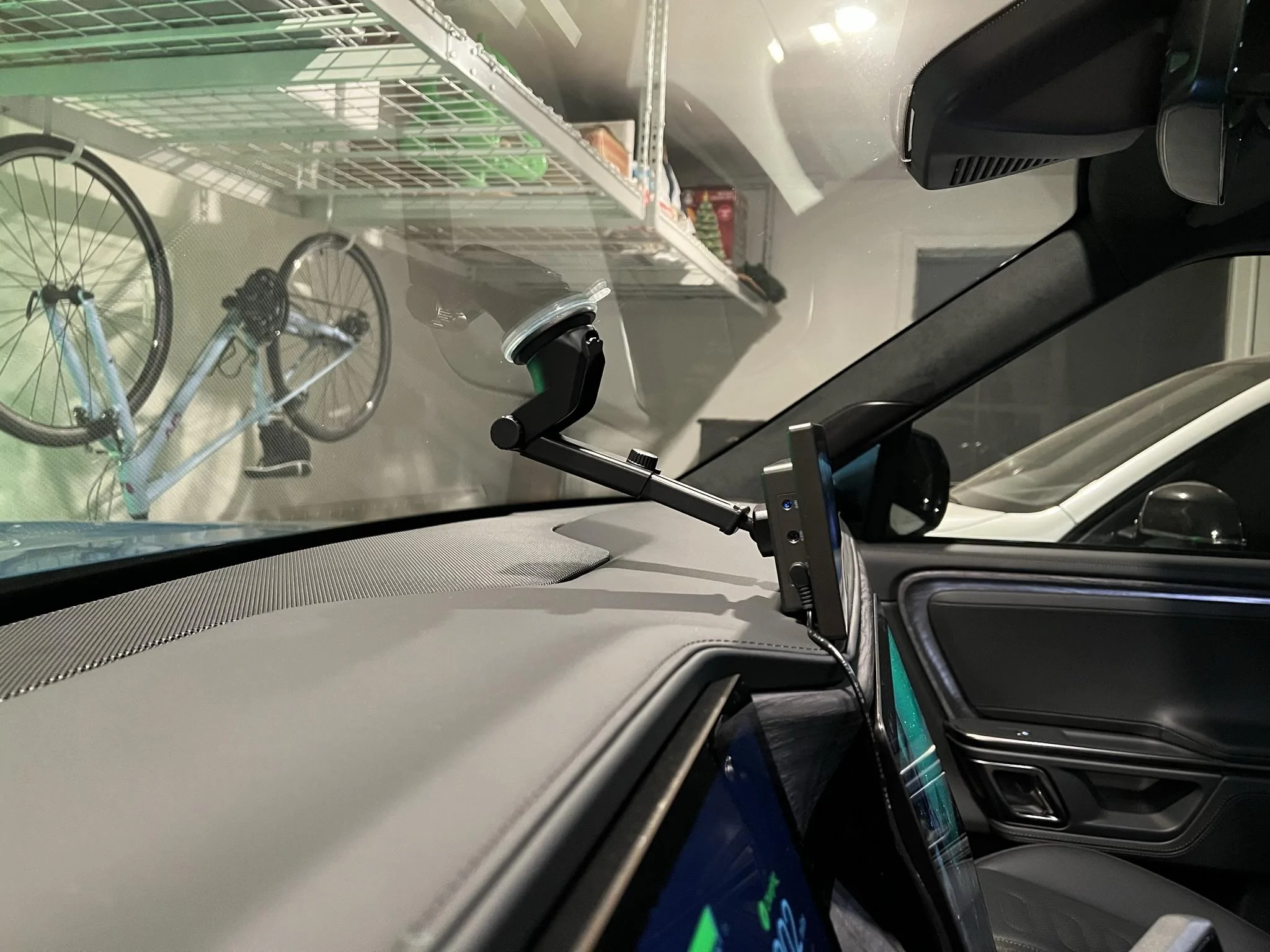

Setup and installation was simple and straightforward. I mounted the screen above the existing Rivian infotainment using the included suction mount with boom arm. I then ran the power cable to the 12V port beneath the center air vents and powered on the screen. I removed the Rivian Audio connection from my iPhone and connected the iPhone via bluetooth to the RoadTop unit. It prompted me to start CarPlay, and within seconds it was up and running. I then connected the RoadTop as a bluetooth device to the Rivian infotainment and set the output appropriately. Boom, wireless CarPlay in a Rivian.
The 12V power is tied to the lock state of the truck. If the truck is unlocked, the unit powers on. If it's locked it powers down. Startup time is relatively quick (~8 seconds from power up), and it can be set to boot directly into CarPlay. It's responsive, and the audio quality sounds comparable to the direct bluetooth connection to the Rivian infotainment. It also supports screen mirroring via AirPlay or MirrorLink, which is a nice touch. When parked you can easily stream video from your phone.
The only big issue I've had is occasional choppiness with the bluetooth connection from the RoadTop to the Rivian. I know the problem lies here because other outputs work fine. It's intermittent, and reconnecting often fixes the issue. I asked RoadTop support about this. They sent me a firmware update to try, but I can't seem to get it to install. I'm waiting on a follow-up from them now.
If you zoom into my last pic with the cans in the cupholder, you can see the “sandwiched” stripes of 3M Velcro. I’ll try to get a pic of the top when I have a moment.
Rivian R1T R1S I added CarPlay to my R1T CD887FB4-3650-4FF7-8B6E-F6F5DFA3A728
Rivian R1T R1S I added CarPlay to my R1T BC4A37C5-ECAC-40DF-A0A1-264D34127EDC
Rivian R1T R1S I added CarPlay to my R1T 4B639520-A6F1-4390-9B16-74BCD47E375B
Not as clean as the magnet solution but the double sided tape I used didn’t hold as well as these Command strips. I’m working on another solution with magnets and ill keep the thread updated if I get better results.
